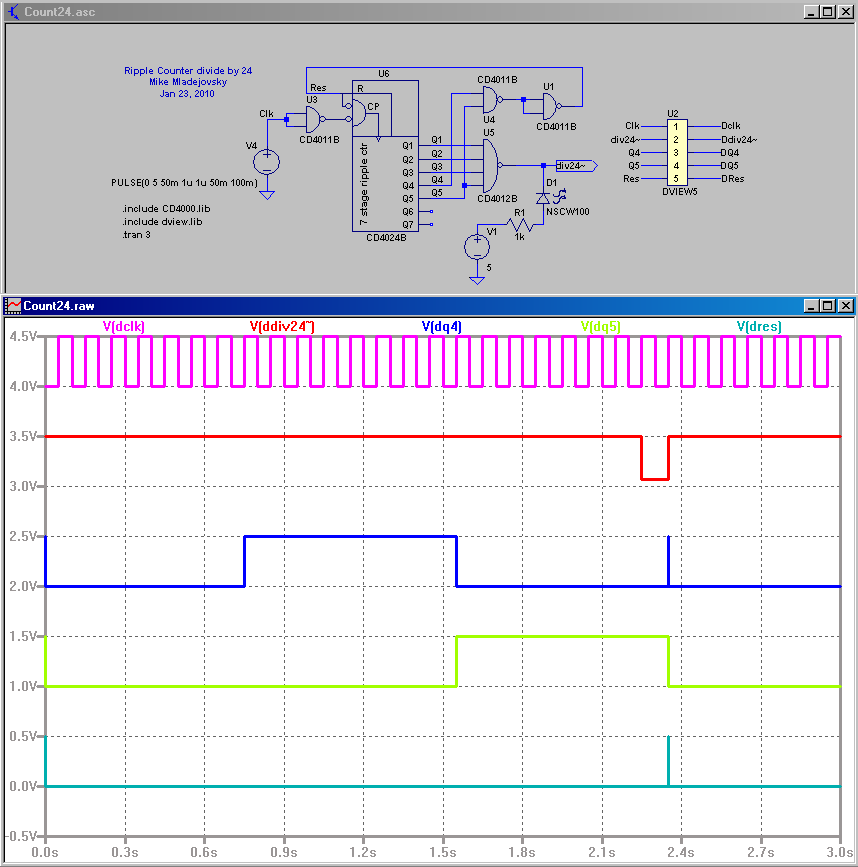

This puts out a low ( and lights the LED) during the 24th clock cycle.
hi there,
thanks very much for that diagram it looks perfect!
i am trying to use as few components as possible, or at least as small as possible, can the CD4011b NAND gates be used in a single IC? and the final CD4012b be made with transistors?
thanks again
There are two 4012s per package. There are four 4011s per package. If you can find a dual four-input AND gate instead of a NAND gate, then you could do it in two packages... One of the AND gates decodes Q4 and Q5 (state 24 or the counter), while the other decodes Q1,2,3, and Q5 (state 23 of the counter). You dont have to invert the clock. If using ANDs instead of NANDs, you dont have to invert the RESET signal... You will have to do something with the way the LED is driven.

hi nex,
Mikes circuit looks OK, the only point I would make is that the 4024 is a 7 bit ripple counter, not synchronous.
The logic decode for the 24th count may have transition glitches as the 4024 counts up.
Depending upon the 'speed' of the circuit into which the 4024 is sending the 24th pulse into, these glitches could cause the receiving logic to malfunction.
The usual way to eliminate these switching glitches is by having a simple res/cap filter on the output of the logic 24th detection pulse logic. OK.?

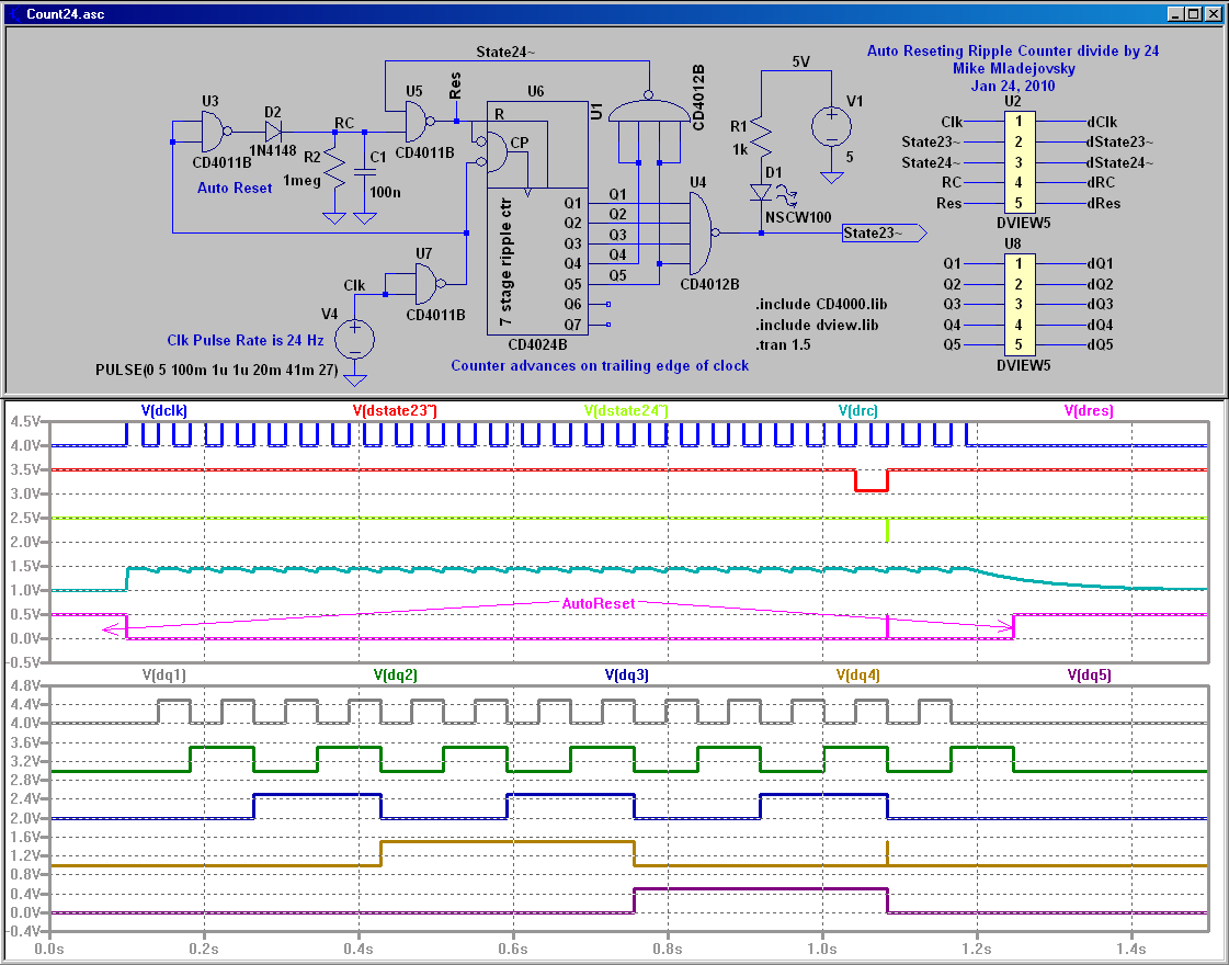

Eric,
If you look closely at the attached, I took this into consideration. The State24~ decode is glitchless and hazard-free because it decodes the first possible time that both Q5 and Q4 are High together as the counter advances 0,1,...,23,24 after a reset. I have been burned by glitches in decoding ripple counters before, and avoided it in this case...
Nex,
I went back to NAND gates for the 23 & 24 decode, and used two input NANDs to implement the "timer" which resets the counter whenever the clock stops. Look at the node labeled RC in the sim. You might have to play with the time constant a little bit to guarantee resets at all BPMs. You must use a CMOS quad two-input NAND gate to make the timing network work...
Contrary what it says on the schematic, the counter advances on the rising edge of clock...

hi Mike,
Thanks for the update, I should have seen/realised that you would not have overlooked the possibility of transition glitches.:)
Regards.
Nex,
thank you VERY VERY much for all this, this is great!
is it possible to have your email address so i can talk to you privately about this?
it looks perfect, i am assuming that the capacitor and resistor on the left are what is controlling the time out circuit, and i just adjust the ratios to suit my needs? the clock pauses shouldn't be more than 0.2 seconds maybe? on a very low BPM of something like 40 beats per minute, which is actually the lowest my system can handle anyway.
thanks again for this, i have ordered the components which are on there way, i am looking forward to seeing how this going to work. next job is to turn the BPM into a seven segment display read out! but that is later.
