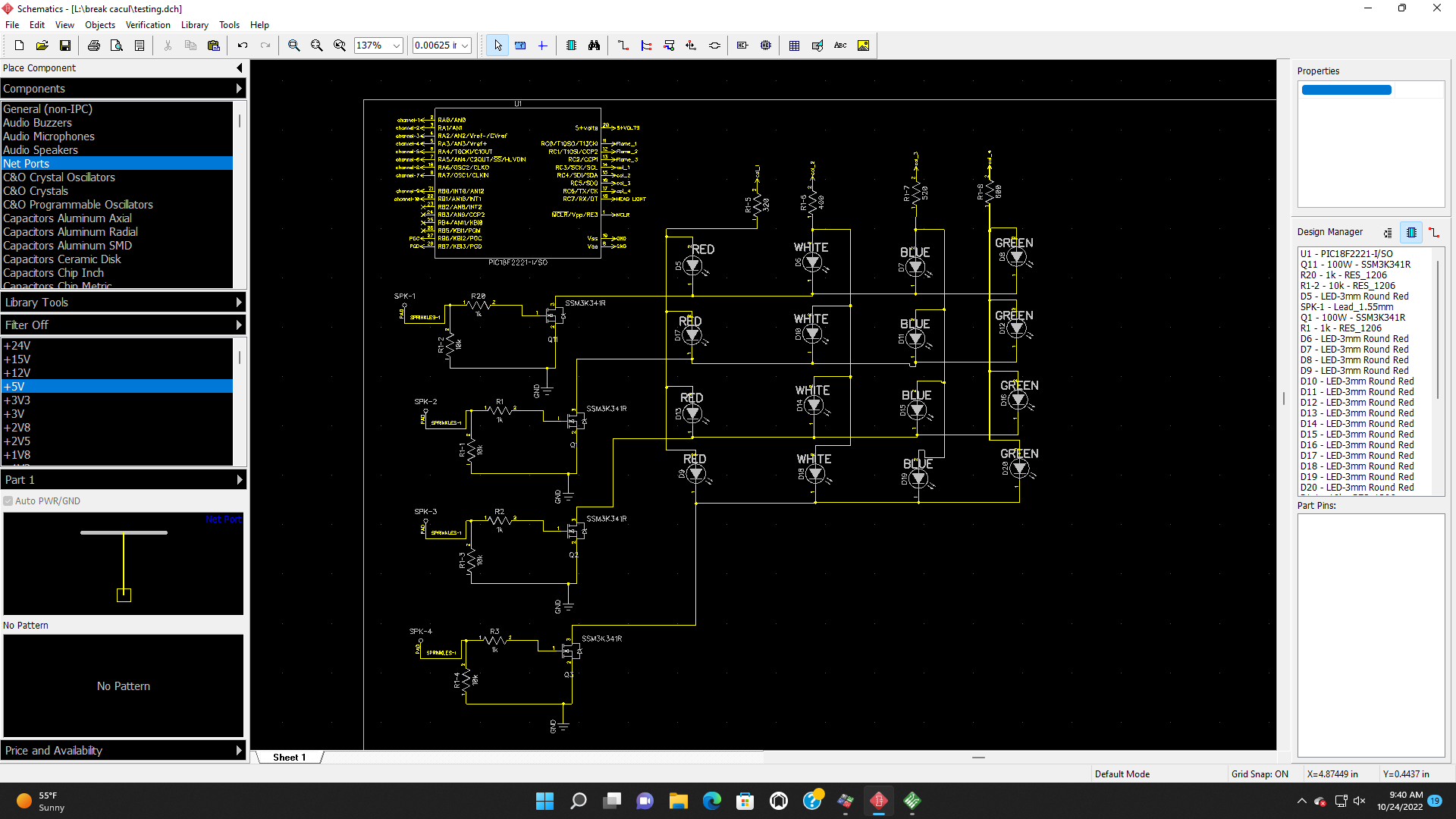

I recall the SSR or triac boards used an opti-isolator, couple resistors but instead of using a computer, I want to just use a PIC to drive the opti_isolator. Just started looking for leftover plans and parts but figure would ask first.
4 leds at one time (one of each color)
Not quite. You can turn on 1 – 4 LEDs IN A GIVEN ROW.
You can't turn on LEDs in different rows, say the upper left red and lower right green at the same time for example. What will happen if you try? Unless you are actually multiplexing at > 30 and turn on ONE LED at a time. Then more than one can appear to be on at a time, with reduced brightness.
If your plan is turn on one row at a time, why are you supplying V+ from port pins?
Good luck. You're going to need it.

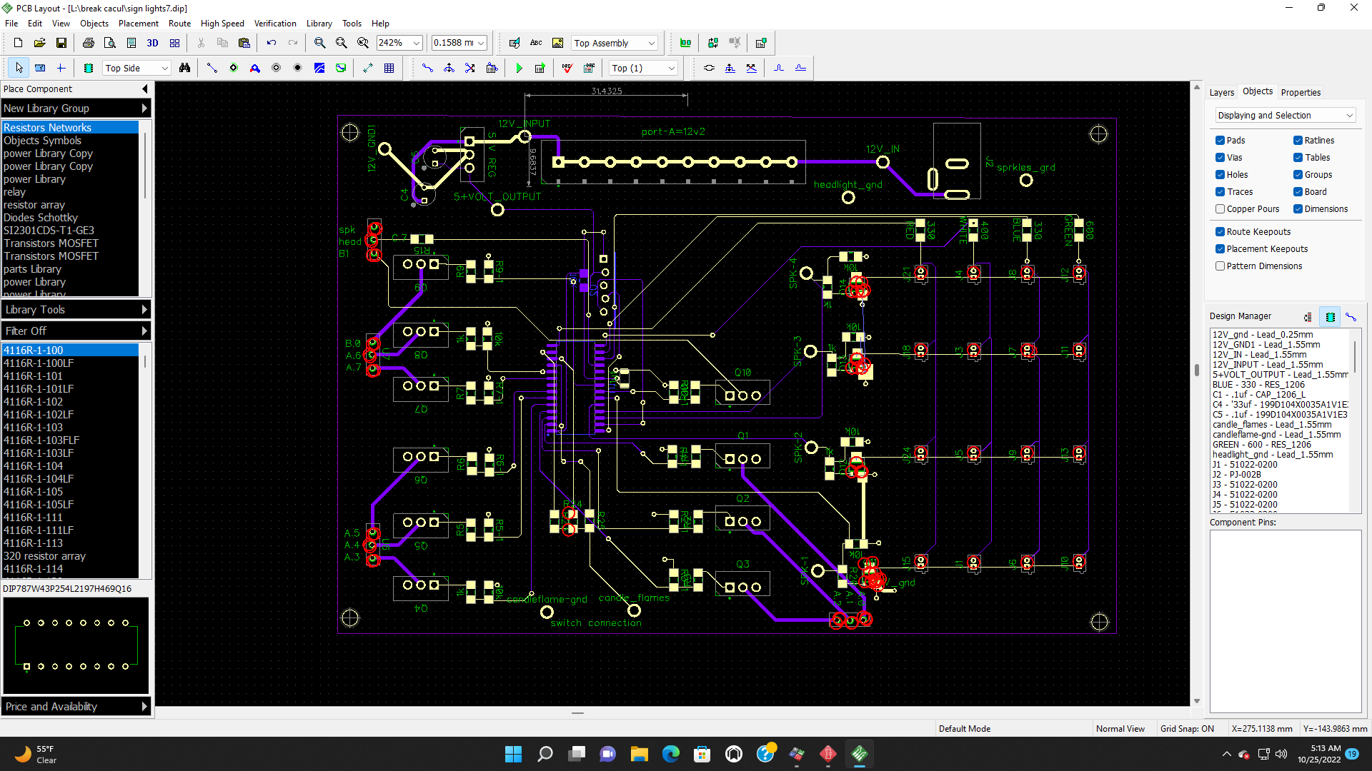

The Anodes of the LEDs are connected to port pins C.3 to C.6
Cathodes are grounded when desired row is grounded
V= from port pins? got confused thinking I have V+ connected directly to the rows?
You seem to have the 12V and ground connections as nice thick tracks and your 5V connections very thin. And, is there any capacitors on your layout?
Made slight addition, added a heat sink on the circuit board for the 7805 voltage regulator.
Been worried about the heat generated by the 7805 going from 12 volts to 5 volts.
What are the trace widths that are feeding the regulator? All those traces are carrying the same current so should (you would think) be the same width. However, if you're happy with 0.2mm (about 8 thou) then carry on.

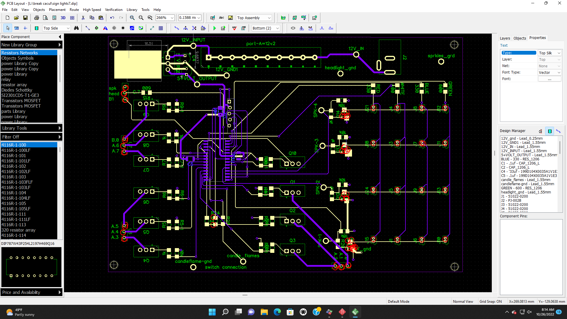

here is revised PCB
has pad for heat sink on 7805 and all 5v and 12v nets are .700mm wide

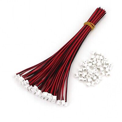

An issue I have been thinking about, but need some advice.
I have 32 wires that connect the 16 LEDs to the circuit board.
On the right side of the board pictured I have 16 sockets, but can change to?
Looking at FFC FPC, wire to board or? only 10ma max per wire.
so many different choices.
some really thin wires from the LEDs to the PCB. Been contemplating different ideas.
These are what I have the LEDs soldered to
plan to only toggle 4 LEDs at a time (RED, WHITE, BLUE, GREEN)
The link shows some really thin wires, thus stripping to allow soldering. Thought about just adding a length of wire (26g) but would entail two soldered joints per wire.
Last idea is start over with the LEDs and solder the 26g wire to each smd LED.
Decided to just bite the bullet and redo the SMD LEDs glued to the white plastic.
Connecting 30g wire wrap wire to 26g wire has issues with stripping the small wires in the link I posted.
Thanks for looking at solutions, but will redo the LEDs then solder the 26g wire to the LEDs instead of the 30g wire wrap wire. Redesign the PCB to conform to changes.
