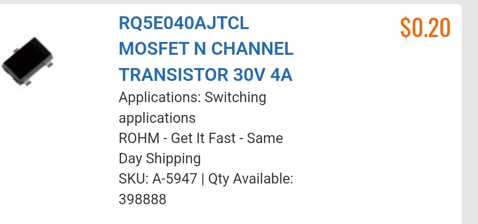

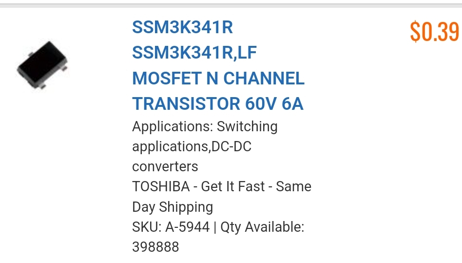

If you want surface mount mosfets, check out Taydaelectronics.com. A couple good choices might be* these two.
N-channel
SOT-23 package
Vds breakdown > 12v
Gate threshold voltage low enough
Drain – Source resistance low
And the all-important, IN STOCK
*These suggested parts appear to meet your needs. It's up to you to check the datasheets to be certain. I take no responsibility for any decisions you make about them.

They both look promising. Now to try my hand at figuring out if I exceed 2 watts of power

Let's say you're connecting a string that draws 1 amp to one mosfet. As you stated above,
P = I^2 × R, where R = Rds of the mosfet.
Rds worst case of the two mosfets I listed is 51milli-ohm if the gate voltage is 4.5v. But let's go for the "most worst" case when it's 69milli-ohms for a lower gate voltage.
P = 1^2 x 69milli-ohms × (1 ohm / 1000 milli-ohm)
P = 1 × 69/1000 ohms = 0.069 watts
This is a simple calculation. Takes a minute to do it. If you just don't get it, here's a calculator for you
Thanks for explaining it better.
I copied n Pasted your explanation then printed it out.
So using the posted MOSFET then each MOSFET is using ,069 watts of power?
Then either of the 2 you posted should be safe to use?

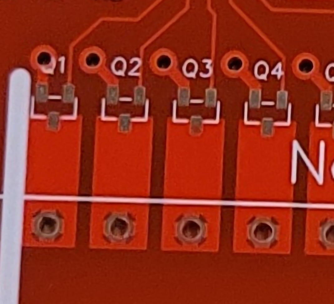

One thing you should do is use large copper areas around each mosfet to provide heatsinking via the pcb. You may want to operate at higher current levels at some point so design for it.
I thought about that.
The question, in your picture it appears the GATE is the only part of the MOSFET? that has the heat sink (copper area).
On my board, all my traces are .700mm.
I need to research and find out how to place a copper area under each MOSFET.
