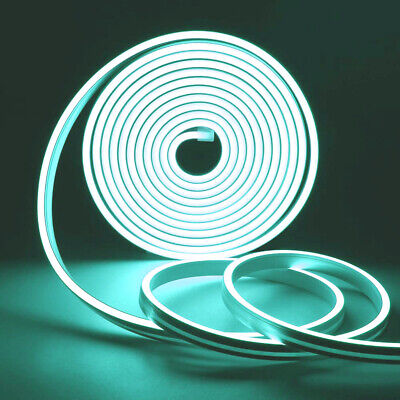

The LED neon strips need 60 watts at 12 volts=5 amps.
decisions, decisions.
here is a link to the LED strips I purchased.
best I can figure is 1 amp per meter of LED rope.
1 meter = 39 inches.
Way over kill on the mosfets. Maxium for entire sign is less than 5 amps
rethinking mosfet size. each mosfet only needs to carry 1 amp or less.
