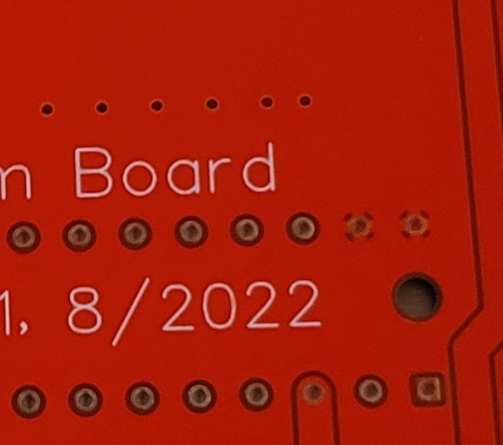

There's a ground plane on the bottom side of the board under the mosets. I could have added copper areas around the drain connections and stitched them to the ground plane, but the large trace and via to ground plane will conduct heat away.
Don't skimp on trace width anyway. There's nothing be be gained where there's plenty of room.
I think I discovered a way to insert a heat sink under the DRAIN pin.
Just place a larger pin under the DRAIN pin and add a large copper area under the mosfets and tie the two together.

Curious, in your pic post #99 what is with all the holes?
Thinking of a heat sink copper area under the SOURCE pin as well?
i can just includ
The holes about the mosfets are vias to the ground plane – large diameter to handle a lot of current.
The pads below the mosfets are for a terminal block.
Ground plane is under all of it.

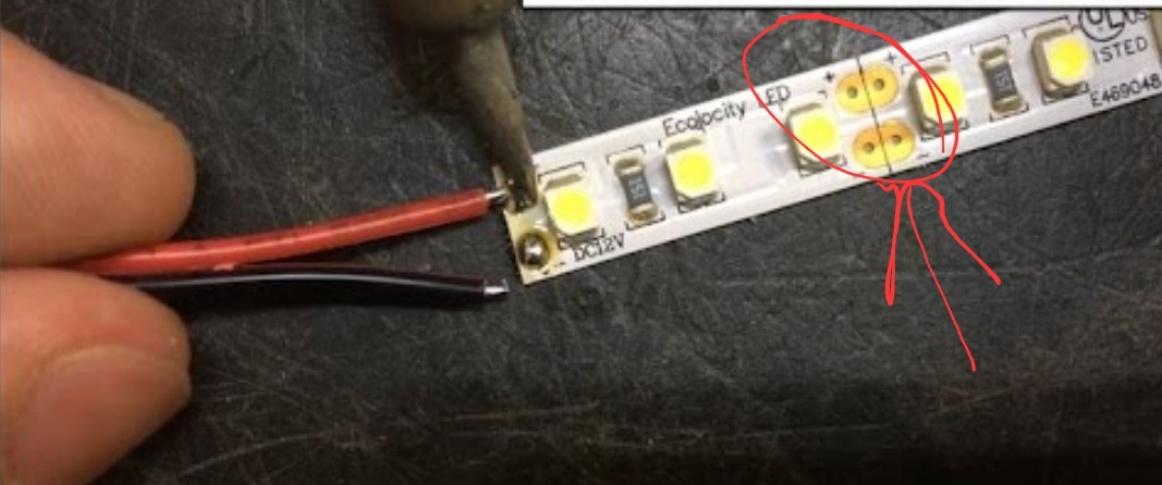

while waiting for parts I decided to start installing the LED / NEON strips. Boy are they hard to solder. Using wire wrap wire (30agw?) curious what amperage is this wire good for?
If only there was some way to find out.... it may make a nice fuse if there's any length involved.
Big Clive likes soldering not to the end pads but to a non-cut set. This might be easier.
here is a picture of the strips I am working with. Very hard to solder, but I discovered that using a larger diameter solder works, but using low temp solder paste works even better. The silicone covering melts really easily.

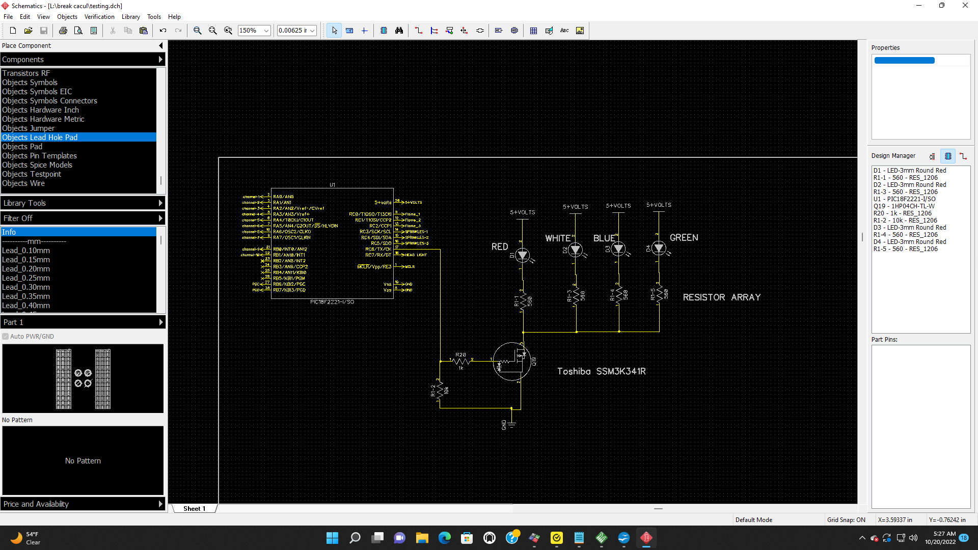

been coming up with an additional "automation" for my art project. I needed a cake so why not add some sprinkles to the birthday cake. I have the 560 ohm resistor arrays and the mosfets so here is what I came up with. IMO it should work?
"IMO" your schematic shows a p-channel mosfet, while calling out an SSM3K341R, which is an n-channel mosfet, so likely neither is accurate. So what mind reader can say if your circuit will work?
You'll likely find that the different color LEDs want to have different resistor values, for at least a few of them.
They're usually very different in terms of brightness and forward voltage drop.
It is an N channel MOSFET. I grabbed the wrong schematic MOSFET.
As far as brightness I think I only have the 560 ohm arrays but maybe some 130's?
good catch thanks
good catch thanks
I think that the point that tumbleweed was making, is that you may want a different resistor value for each LED to adjust for the different Vf and brightness of the different color LEDs.
Using a resistor array prevents you from doing that.

Do be aware that just running the same current through each LED (by adjusting each LED's resistor) probably won't give anything approaching uniform brightness. You need to put them side-by-side and adjust the resistor values until the brightness appears uniform by eye. The blue will likely need the least current, the red the most.
