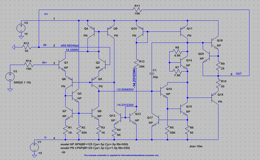

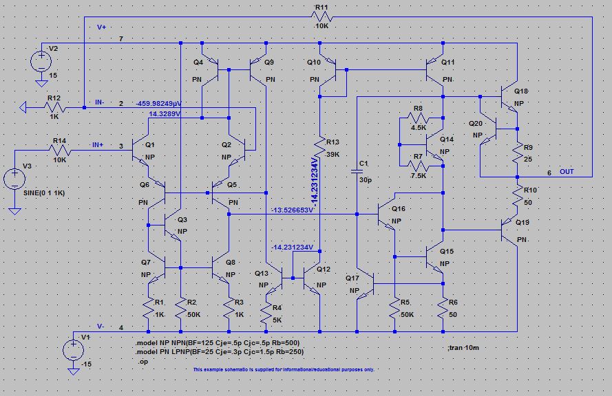

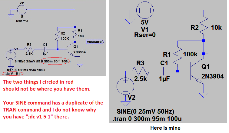

You have somethings duplicated and a voltage statement that should not be on your simulation:

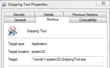

Not sure how your capturing you screen shots, but they are too difficult to read. Windows comes with a nice screen capture tool, and you can just snip the areas of interest thus reducing screen size.

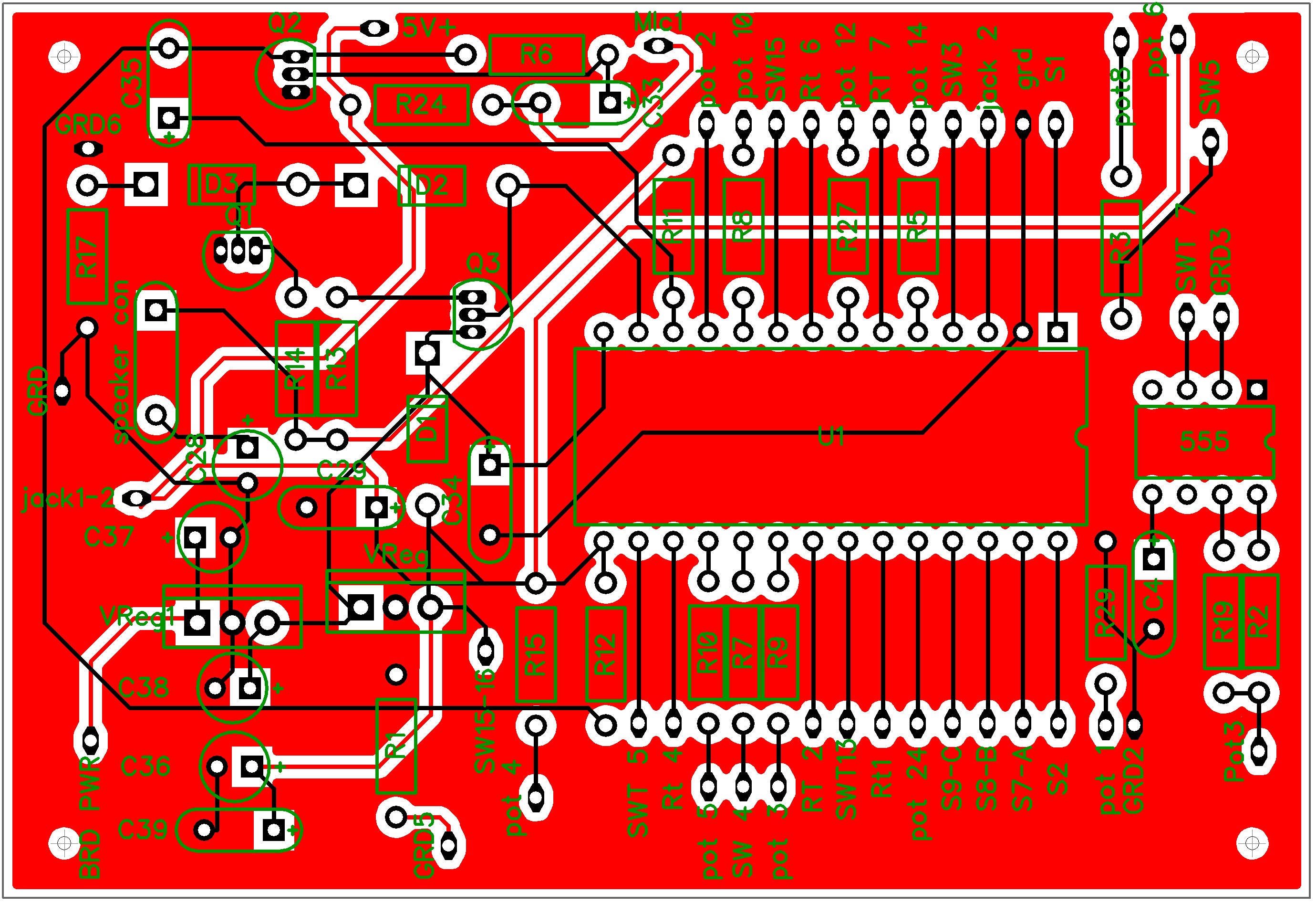

Mr Deb there is cheaper places you can use like dirty PCB, but first lets get the design done before we worry about boards. You dont order furniture to fill a house before you have brought one do you?
....get the design done before we worry about boards....
MrDEB is not one to worry about having the design done before building boards.

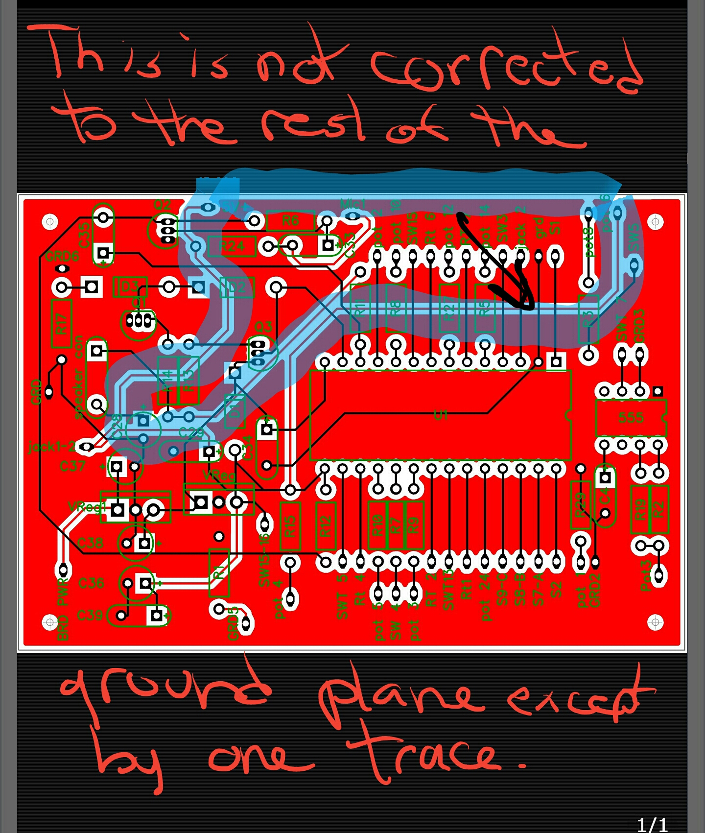

The traces on the board he's posted are 10 mils or less, including the ground trace which snakes its way around the board.
The board also lacks mounting holes, but I guess the spaghetti of all the wires running from all parts of the board will suspend it in space.

NO WORRY guys, the board I posted was not the final design. I added a bottom ground plain, wider clearances and mounting holes.
As I mentioned the design I found needs to ferment before finalizing.. As for the traces, .008 for most of them. Power traces are wider.

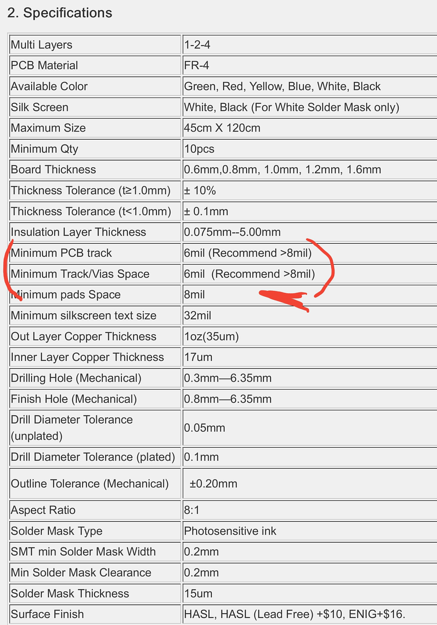

MrDEB,
Just because the software lets you use 8 mil track widths doesn't mean it's a good idea. 8 mil is pushing the limits of what a cheap fab house can do. If you're laying out a high density surface mount board, you may need to use 8 mil traces, but unless you absolutely need such thin traces for clearance, it's prudent to use larger trace widths.
Your board is not that dense. There's plenty of room for 16 mil or larger traces, and for power and ground, I'd suggest even larger.
This chart is Elecrow's PCB specifications. It shows that they can make boards with 6 mil trace & space.
However, they recommend greater than 8 mil trace and space. Neglecting all considerations other than what will fit on the board, 16 mil or even wider traces will not be a problem to fit.
Thanks. ere is revised board w/.012 traces
I would suggest making your power and ground traces bigger... nevermind, I already have on 3 occasions.
Your 555 chip would work better with a Vcc connection and the floating island of a ground plane (well, almost an island with a single 12 mil connection) would be much improved if some things were moved slightly.
I won't comment farther than that, since laying out a board before the circuit is finalized is... [redacted]

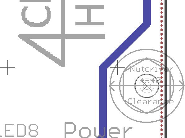

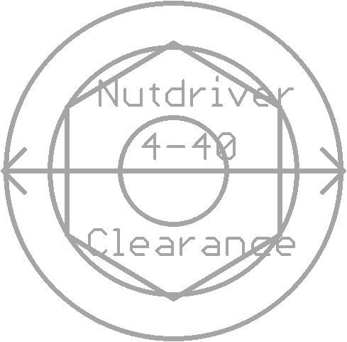

One problem I have is keeping enough clearance around mounting holes. I've solved that problem by creating a part in Eagle showing the size of a 4-40 nut (which is close to the size of a 3mm nut) with the area needed for a nut driver around it. Ideally, you want to keep component mounting holes out of the entire area to ensure you have enough room to screw a nut down. Ideally, I try to keep traces out of the nut area and the tool area too if possible, since the only insulation between the nut and any traces is just the soldermask. A rough face on the nut and you could have traces shorted to the mounting hardware and each other.
I see what your referring to on the mounting holes. Will make change.
Good eye on the 555 Vcc connection. Thanks
Jonsea your ground trace goes off the board!! how is the fab house sposed to do that? :D. And hate to burst any bubbles but I am making my board by laser printer so the traces will be the smallest i can do without hair tearing, so around 12 mil min for smallest.
I might use a marker pen by hand now I have seen how effective jonsea's method is lol :p
When you need just a little more room, the copper can extend past the edge of the board <g>.
