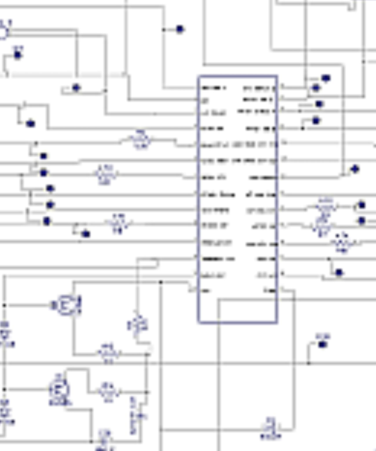

That "look at it" part? This is what you'd see.
Typical of a poor resolution scan, now followed by a zooming attempt which just puts in evidence the pixels.

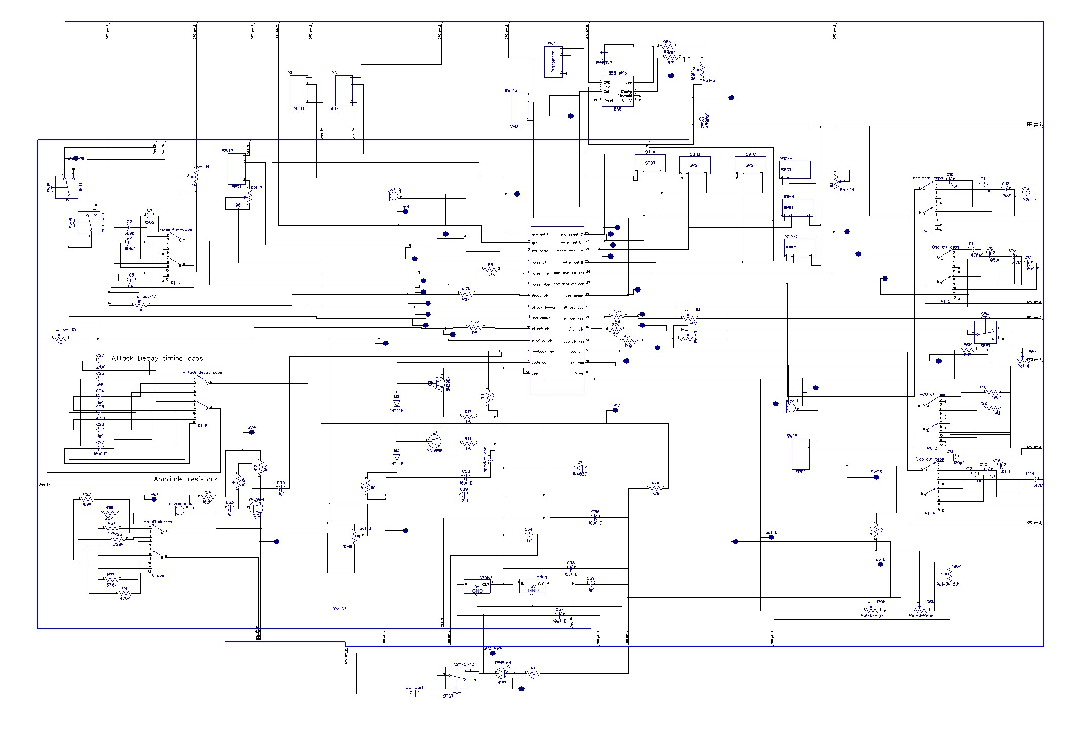

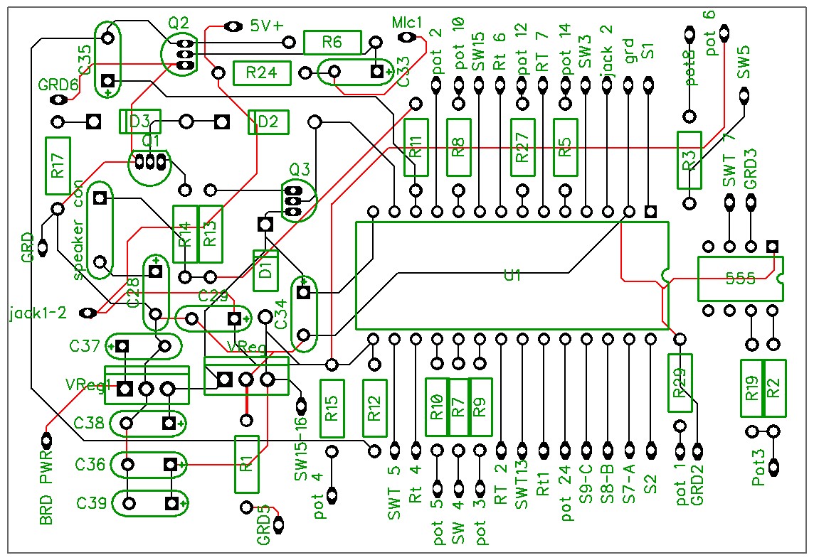

well here is a 300 DPI jpeg
Sigh. You posted a small piece of the schematic. Why? It's not useful. Look at it and delete it if it's crap. Why subject people to looking at your errors?

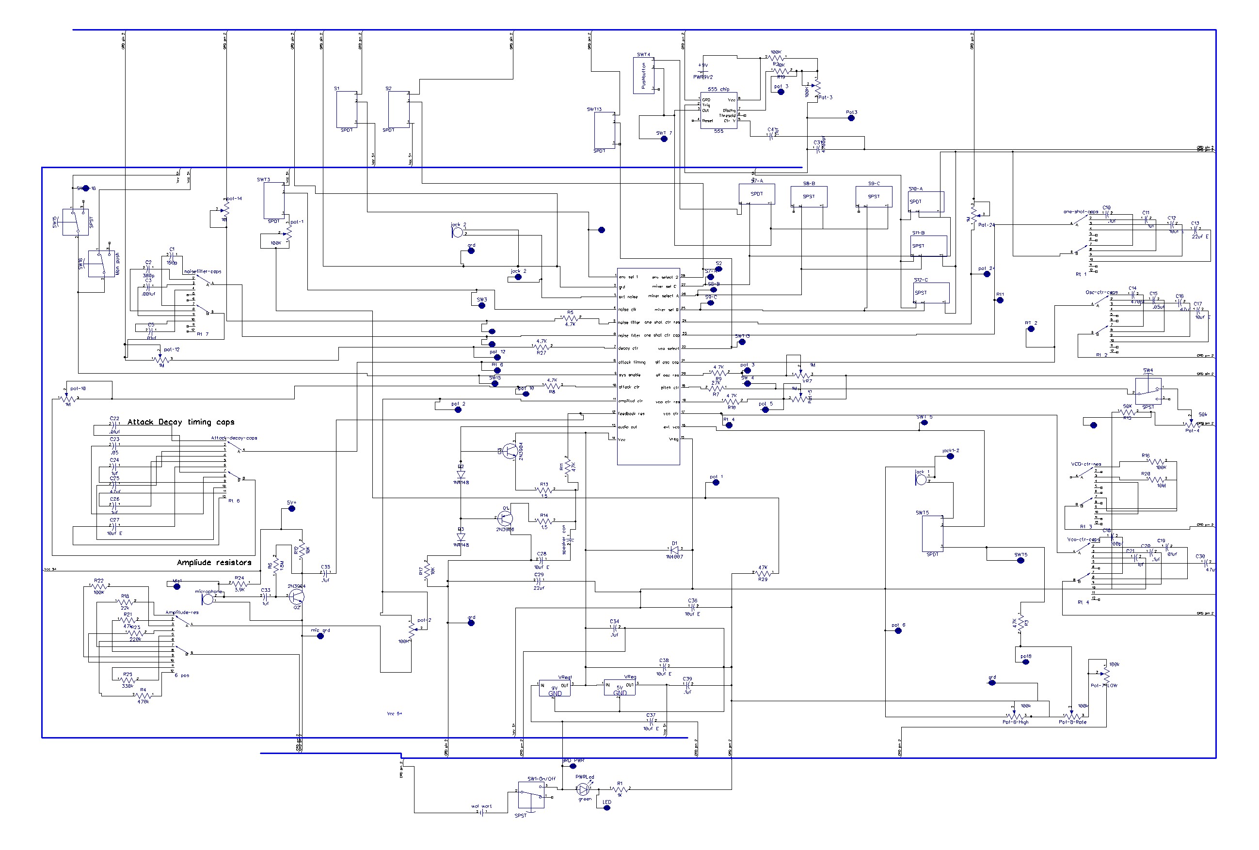

lets try again. I reduced in Diotrace at 300 dpi
I looked at the preamp and saw that the electret mic has R24 with a resistance much too high powering it. An electret mic draws 0.5mA and the 100k resistor for R24 creates a voltage drop of 0.5mA x 100k= 50V! Then the mic will do almost nothing since the supply is only 5V. R24 should be 2V/0.5mA = 4k ohms (use 3.9k).

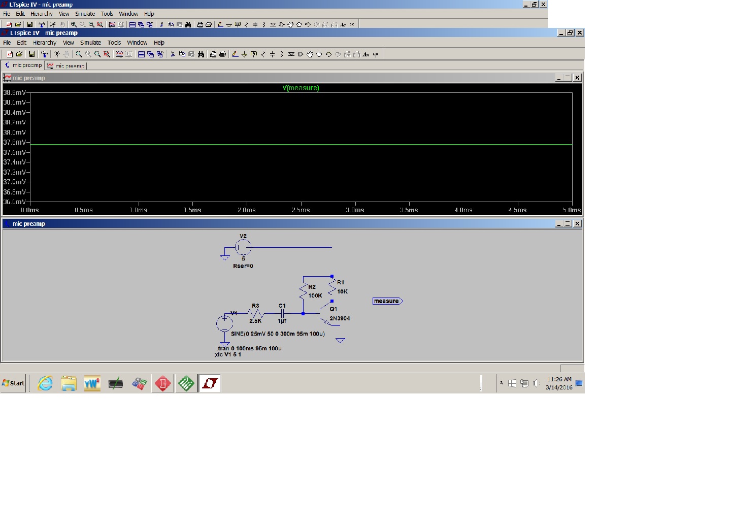

I simulated the mic preamp because I suspected that it is biased wrong. Its bias resistor is much too small so the transistor is almost saturated. The input capacitor was 0.1uF which passed no low frequencies but now it is 1uF which is better.
I simulated it and changed its 100k biasing resistor to 1.8M then it works much better. My simulation has a 2.5k resistor as the impedance of the electret mic.
Thanks audioguru.
the preamp circuit came off a data sheet somewhere concerning this circuit. I found two similar circuits.One used a crystal mic with a 1.5M bias resistor.
Want to locate both and hopefully simulate as well
The preamp circuit allows the user to insert their voice intermixed with the sound generated by the chip.

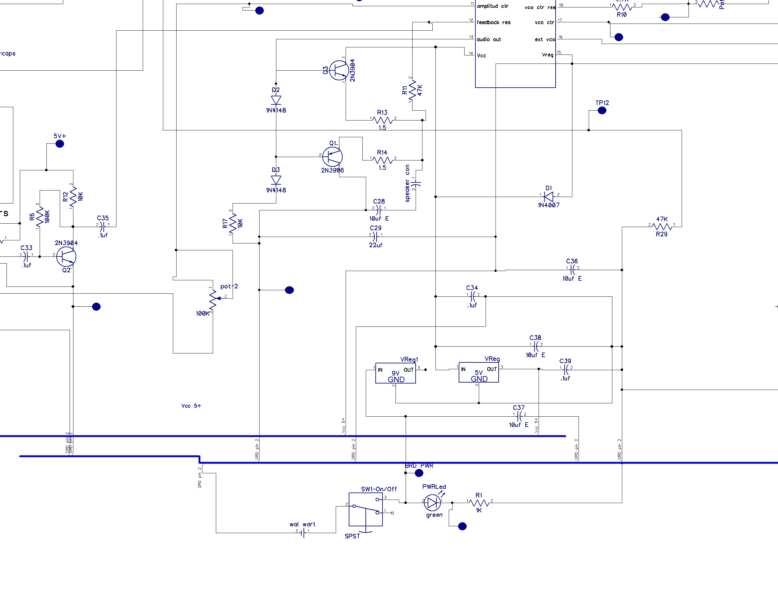

cleaned up schematic and added the cap on pin 5 of the 555 to grd. Also added the tie points markings (all them little black dots) that coincide with the PCboard as to which panel component connects to the PCboard.
changed the cap and resistor values on the pre amp mic input.
Your schematic looks much better. It gets larger when I click on it.

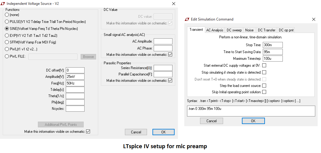

I do not knowhow to upload the LTspice IV file of your mic preamp so here are its setting:

well I got something not right. Trying to duplicate what Audi came up with in LT spice
