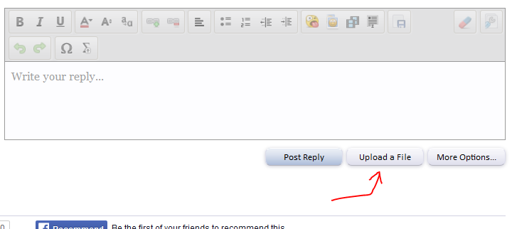

Is there any particular reason you choose to not use the upload button as shown in image? What ever way you are doing it, it is making me open up a image viewer to look at the file, so I just hit cancel.:rolleyes:

I gave you a link to a 5 page forum thread where people explained step-by-excruiating-step how to post a readable schematic, yet for some reason you're trying to re-invent the process again.
The reason you couldn't upload the latest attempt is that you saved the images as BMP, which is a non-compressed image file. If you had saved them as JPG, a compressed file, they would have uploaded properly. This has been discussed to death in that previous thread I menrioned.
Here are a few hints:
1. Look at the file size before you upload it. If it's huge, you don't have the right format. Use JPG.
2. After you upload it, look at it . If you can't easily read it, just delete it and try again.
3. Go back and follow the previous thread I linked. This has all been explained before.
