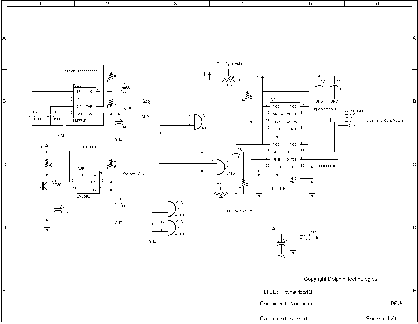

TimerBot revamped
Now that the 555 contest is over, I wanted to revamp my timerbot entry without the constraints imposed on the in the contest which only allowed the use of 555 IC's . This design uses 1 556 IC 1 Nand gate IC and 1 Dual Hbridge IC. This should still function like the original contest entry. I have been working on a PCB for it as well but ran into a few snags getting a few nets to route. I was hoping someone might step up to help with my PCB layout. In the meantime here is the schematic.
Oh btw, here are the Eagle files for the brd and sch of timerbot3. I had to add .txt extension to the board file so it would upload. Just remove the .txt extension.

Just an update on the revamped timerbot PCB. Our Dear friend Hans, AKA Boncuk was kind enough to produce a beautiful looking PCB for the schematic attached in post #94.
Just to give you an idea of how it looks I am attaching an image of Hans layout. When I get time I will put together a full instruction package if there is any interest, otherwise I will just do a build for Hans and myself.
Thanks a bunch Hans :)
