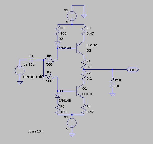

i didn't mean to make it seem more complex. i was just demonstrating why having the resistors between the output transistors and the load as low a value as possible, is important. you were wondering why your circuit had no gain. with 10 ohm resistors used as the emitter resistors, not only did you not have voltage gain (which an emitter follower AKA a common collector amp never does), but you had also reduced the current gain. by using 10 ohm resistors, you actually created a voltage divider which gave you a 50% voltage loss. what you posted was a circuit that had very little current gain, and a voltage loss. it's supposed to be a current booster with very little voltage loss, which is why it's a good idea to use 0.1 or 0.22 ohm resistors there. what i posted was just to show what the effects would be if this circuit were used as part of an actual amplifier, not to confuse you with more circuits. there is a similar circuit that has an actual voltage AND current gain... but pay attention to the polarity of the transistors. this is an inverting amp, and runs class A. it has a voltage gain of 2.

I tried to make your circuit again and it is not giving me any gain. can you post your .asc file
can you explain me why you used two 0.47 resistors there ?
can we make this circuit without using diodes ? i mean normal biasing using votage devider should work ?
Edited -still not giving any gain

hi neptune,
Please post your LTspice asc files when you post a simulation image, it makes it much easier for others to help.:rolleyes:
EDIT:
Check the orientation of Q2 in your circuit compared to Jed's

WHY are you using low power transistors in the output stages.???
Run this asc with BD131/2

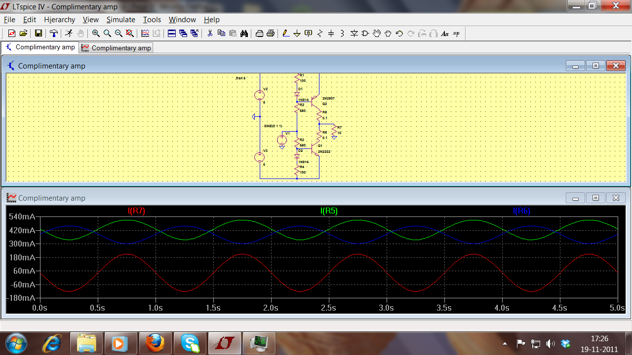

ok so now this is running , but i want to learn some theory behind it.
The current in resistances R5 and R6 are out of phase of each other, but we are still getting current in R7 how ?
and please dont look at my previous posts they were wrong and i am improving them.

hi neptune,
I am sorry but are just not listening to the advice being posted.
STOP using 1Hz as a test frequency, also USE complementary medium power transistors in the output stages.
Use a test frequency of say 1KHz and BD13x medium power transistors
EDIT:
As a test reduce the test signal amplitude to say1mV, then remeasure R5/6/7 currents and it will give you a clue to what the problem is.
Look at this Sim asc... with the changes that have been pointed out over the past few days.
  • Complimentary amp2.asc

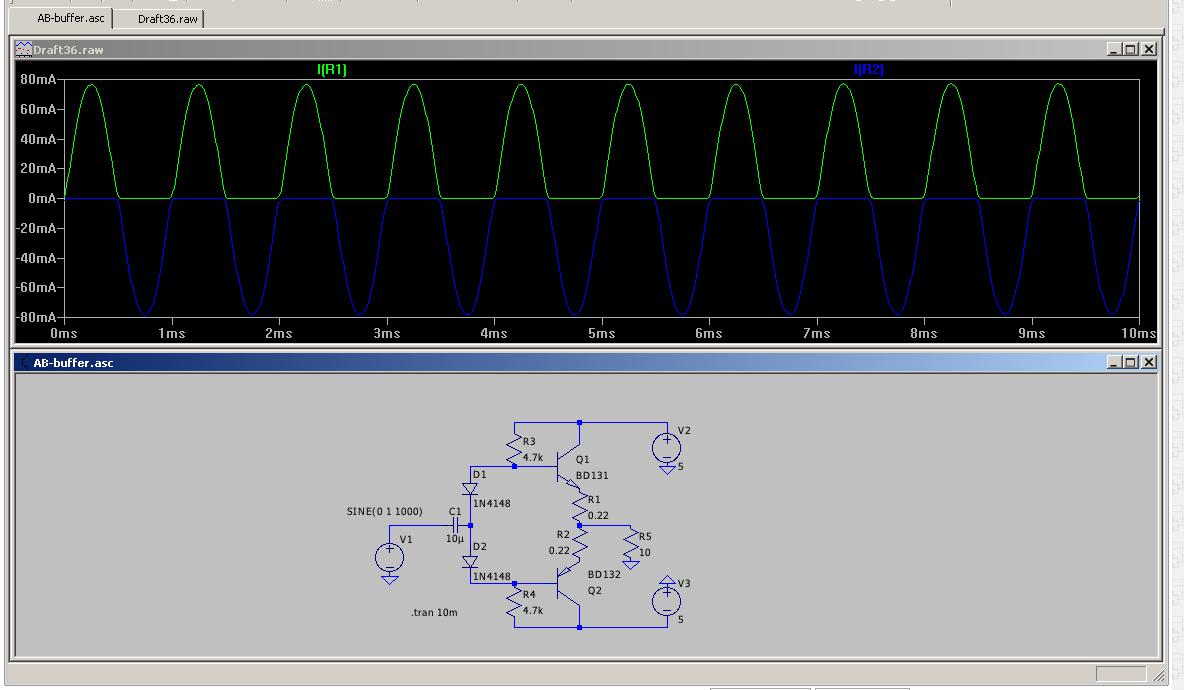

so, if you go back to the original concept of a class AB amp, we can simplify the circuit a bit...
R2 has been turned around 180 degrees and LTSpice now correctly displays the current... notice we eliminated a couple of resistors by tapping the signal in between the diodes. the cap is very important in the sim because the voltage source resistance is ZERO and that would change the bias on the transistors. we always want to isolate the signal source in the sim, because real signal sources rarely exhibit the same behavior. we could put a source resistance figure in the source, but it's best to isolate it with a cap...
if you turn off the signal source, you'll see the idle current is 1.5mA
  • AB-buffer.asc
