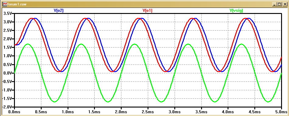

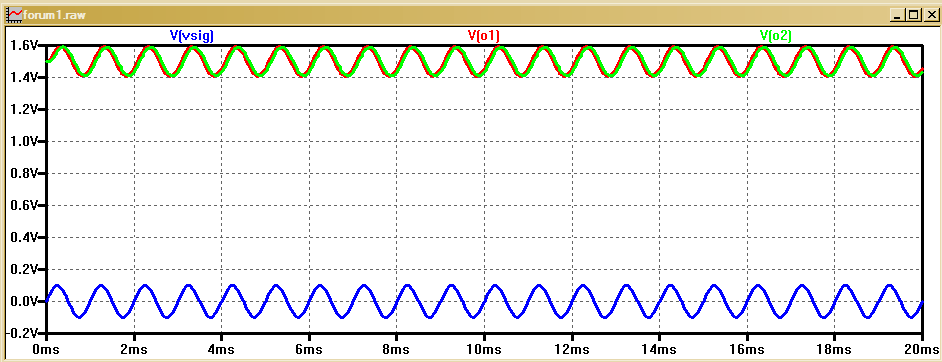

This is what I see on LTspice. Looks OK at 100mV signal input.
What input signal level are you using.?

This is with a 1.7Vppk input signal, looks fine.
Have you checked that you have not crossed over the input pins of the OPA.???

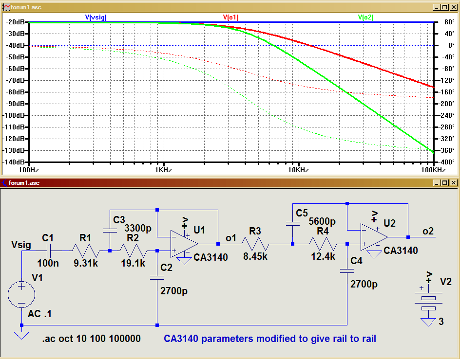

Reading thru the datasheet for the PIC24H shows that the PWM audio signal is at 3.3V/0V and is passed thru the 4th order LPF , which has a cut frequency of approx 4kHz.
The main audio amp is rated at 1.5W.
Looking at the simple frequency sweeps using a 1.8V square wave input to the filter, show a distorted output from both the 1st stage and 2nd stage of the filter at frequencies above approx 4kHz.
I would expect it to sound poor quality on high frequencies especially 'sibilant' sounds.
