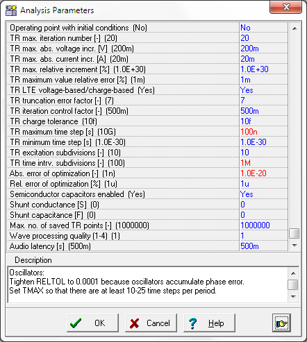

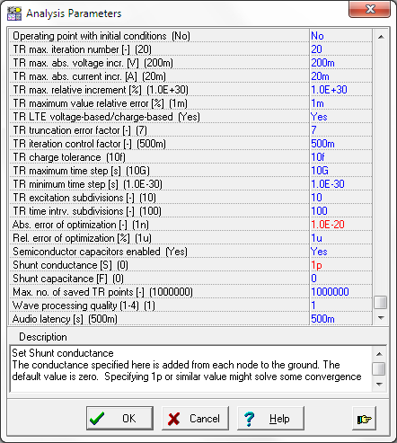

I tend to think the modeling software is trying to get as real life as possible.
That being said, thete are constraints when working with perfect sources. You can have a femto value of resistance to satisfy the software.....which wouldn't change the answer in most circuits. It is important to know the software.
I am a neophyte but i investigate all errors to resolve the issue.
Some common issues are using initial charges when working with oscillators, however, reworkimg the circuit with different values can be the solution, while maimtaining the specifications, when starting the simulation with zero initial conditions (simulating normal power startup).
Ive had circuits simulate faster by reworking the values. I feel if the simulator cant solve it within the various constraints
It is worthwhile to review.
Im on my phone so i cant remember the constaints. Sometimes resolving to the micro or nano accuracies is outside the realm of expectations. that was an inaccurate statement.
on edit ... back at the computer.
Just to illustrate, here are the transient analysis parameters for both floating nodes and oscillators. You can note the default values in parenthesis ... I typically use just the defaults.

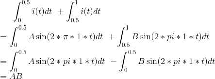

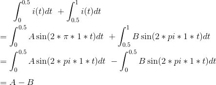

Assume that an ideal capacitor has reached its steady state when a current i(t) which has the pattern
i(t)=A*sin(2*pi*1*t) for (0+n) =< t =< (n+ 0.5),
i(t)=B*sin(2*pi*1*t) for (0.5+n) =< t =< (n+1), n=0,1,2,3...
is flowing through that capacitor for t >= 0.
If A > B, the following integral
represents that for every second, there is an additional charge (A-B) going to be added to the cap, so the cap is very likely to blow up after a finite time has passed.
Is it correct?

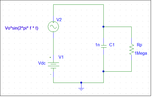

Hi again Heidi,
Let me see if i can address your questions from post #28 first.
To begin, when we place a resistor across a capacitor the circuit is still linear. It's just a cap in parallel with a resistor which i am sure you've seen lots of times. The real difference is now we have something that 'short circuits" the cap in a way for current, so that even if the cap charges up there will still be something there to conduct the current. If the current is small, then the voltage can not rise very high. In fact, then it's just Ohm's Law: V=I*R. If the current is only 1ua (aka 'a low current') and the resistance is 1 megohm, then the limiting DC voltage across the cap is 1v. If the current is 10ua, then the limiting DC voltage is 10v, etc. So the parallel resistors helps to partially reduce the effect of the constant part of the current source (the DC part). It doesnt really get rid of it though, it just limits it to an acceptable level. Note here 'acceptable level' depends on the application too of course, as some apps dont like much DC at all, while others can tolerate a little.
BTW the circuit we are really talking about is your circuit from post #28 but with the following changes:
1. The sine voltage source is changed to a sine current source with significant amplitude (considered to be the main signal) in parallel with a DC current source of relatively low level.
2. The DC voltage source is removed and the two terminals where the source was are shorted out.
So basically we have a sine current source in parallel with a DC current source driving a capacitor in parallel with a resistor and the resistor is considered to be the parallel resistance that represents the leakage.
As Steve noted early on, there is also a small series resistance but for now we dont have to include that.
They also go farther sometimes and include a small series inductance, but we dont need that right now either.
They also go farther than that even and start to add the physical effects of length but i think that's beyond our needs for the most part.
So the main function of the parallel resistor is to model the leakage and leakage will help to reduce the effect of a small DC current, or we can add a resistor to help with this too.
As far as the resistor changing the frequency response, it should only affect the amplitude not the sensitivity to frequency, but it could very well affect the frequency sensitivity too if that cap is used in some sort of filter especially an active filter. Of course the Q of any such filter would also be reduced in most cases where the cap is part of the frequency selectivity function.

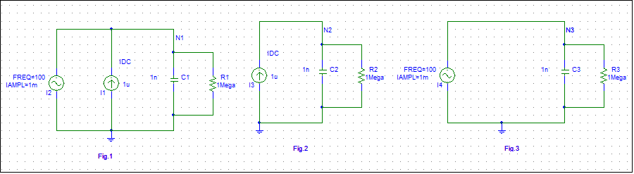

Hello MrAl,
I would like you to see if I understand your explanations correctly, please.
Here we're talking about the circuit in Fig.1 below.
1. If the leakage current of a capacitor and its effects can be modeled by a resistor in parallel with the cap, then there is nothing special about the leakage current, and the cap can be treated just like an ordinary RC circuit, no matter the excitation is DC, AC , or AC+DC.
2. So now we can analyze the circuit in Fig.1 by analyzing the circuits in Fig.2 and Fig.3 separately and adding the results.
3. In steady state, the voltage across the cap in Fig.1 is then a sine wave (with a phase angle) plus a DC offset, and the DC offset can be totally determined by the DC current source and the parallel resistor, that is 1V in this case.
4. If the DC voltage across the cap is undesirable, we can simply add another (much) smaller parallel resistor across the cap to reduce it.
Yes that all looks correct. The only caution would be with #4 where we add a resistor, the resistor obviously can not be too small or else it will swamp out the AC source too and that's the one we probably care about most.

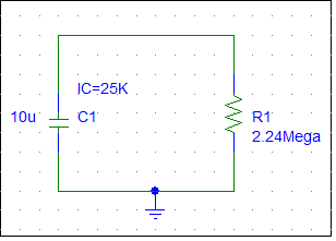

Heidi,
The leakage in an capacitor should be very small. I remember testing a 10 uF capacitor rated at 25kV for leakage. It was in the microamperes region. The test equipment was a HI-POT, a power supply that was capable of 50 kV. I don't recall the amperage at that level. The parallel resistor should be very high. Naturally, if you wanted to see the effects of a leaky capacitor, lower the shunt resistor value.
Quoted this message by mistake below while correcting it.
The leakage in an capacitor should be very small. I remember testing a 10 uF capacitor rated at 25kV for leakage. It was in the microamperes region at 25 kV. The test equipment was a HI-POT, a power supply that was capable of 50 kV. I don't recall the amperage at that level. The parallel resistor should be very high. Naturally, if you wanted to see the effects of a leaky capacitor, lower the shunt resistor value.

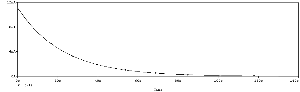

Interesting.
I asked to myself, "How can I measure the leakage current of a capacitor?"
Here's a possible way I can think of:
We charge a cap with capacitance C and measure its voltage, let this initial voltage be Vo. Then after a period of time T, we measure its voltage again, let it be V1.
What we know now is
v(0)=Vo,
v(T)=V1,
the voltage equation of a cap, v(t)=Vo*exp(-t/RC), and the cap's capacitance C.
What we don't know is the cap's parallel resistance R used to model its leakage.
To find the value of R, we do the following:
v(0)/v(T)
=Vo/(Vo*exp(-T/RC)
=1/exp(-T/RC)
=Vo/V1
exp(-T/RC)=V1/Vo
-T/RC=ln(v1/Vo)
R=1/[(-C/T)*ln(V1/Vo)]
Since the current flowing through a cap is i(t)=C*(dv/dt)=C*(-1/RC)*Vo*exp(-t/RC),
hence the leakage current flowing through R is
-i(t)=(V0/R)*exp((-t/RC)
Assume the cap's initial voltage is 25K V, after a period of time of , say, 5 seconds, its voltage becomes 20K V. With C=10u F, then R=2.24Mega ohms, and the leakage current is 11.16mA at t=0, begins to fall exponentially.
Well, I'm not sure if this method is practical or not because it depends on how accurate we can measure the cap's voltage, and it was assumed that we know its capacitance in advance.
So, anything else I should be aware of?
