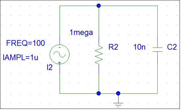

For simplicity, I adopt MrAl's circuit version, but I've changed the elements values in order to see the voltage/current variations in a shorter time. I only do the sine excitation.
Current source: 1u*sin(200*pi*t), frequency=100Hz
C=10n F, initial voltage=0
R=1Mega Ω
(connecting the current source to the parallel combination of the resistor and the acp. circuit sketch is missing!)

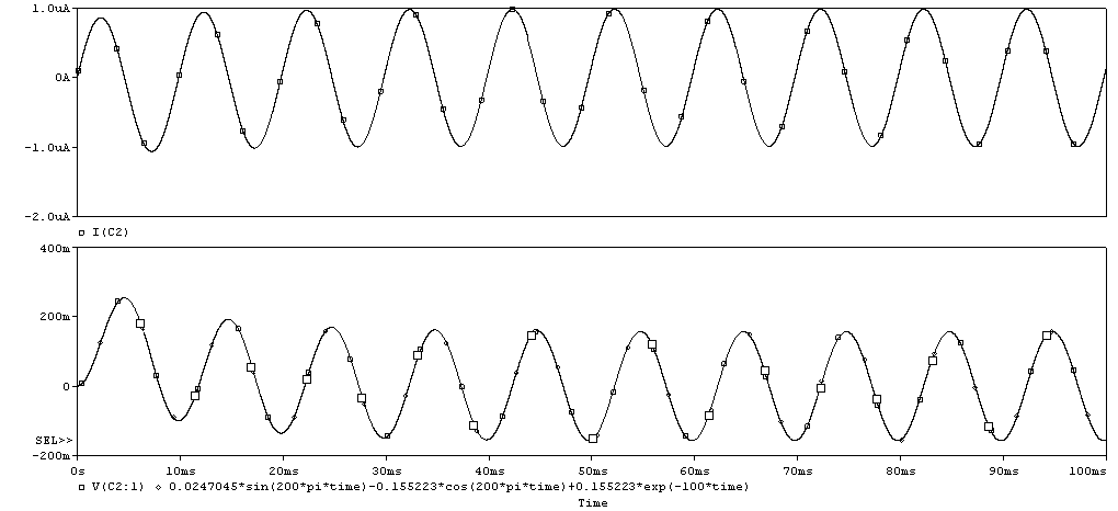

After some lengthy calculations (I solved the circuit equation in time domain) the cap voltage is
v(t)=0.0247045*sin(200*pi*t)-0.155223*cos(200*pi*t)+0.155223*e^(-100*t)
It matches the simulation.
The upper is the capacitor current-time plot, the bottom is voltage-time.
As you can see, the current flowing through the cap isn't a pure sine wave at the very beginning in time. That's why I said " if I want to see a capacitor with zero initial voltage exhibit not only steady state response but also its transient state, the starting current flowing through it won't simply be a sine or cosine one." in post #3.
And that is why I think I set up an impractical, artificial condition: connecting a sine current source directly to a cap!
R=1Mega Ω
Nice work!
Personally, I don't think it is impractical or artificial. It's just a case to look at. If you have a poor capacitor and a poor current source, then you will get fast decay of the offset voltage. If you have very good devices, you will see a much longer time before the decay is noticeable. But, yes you have shown that the initial response is not a pure sinusoidal function. It is only pure in the limit as the parallel resistance goes to infinity.
