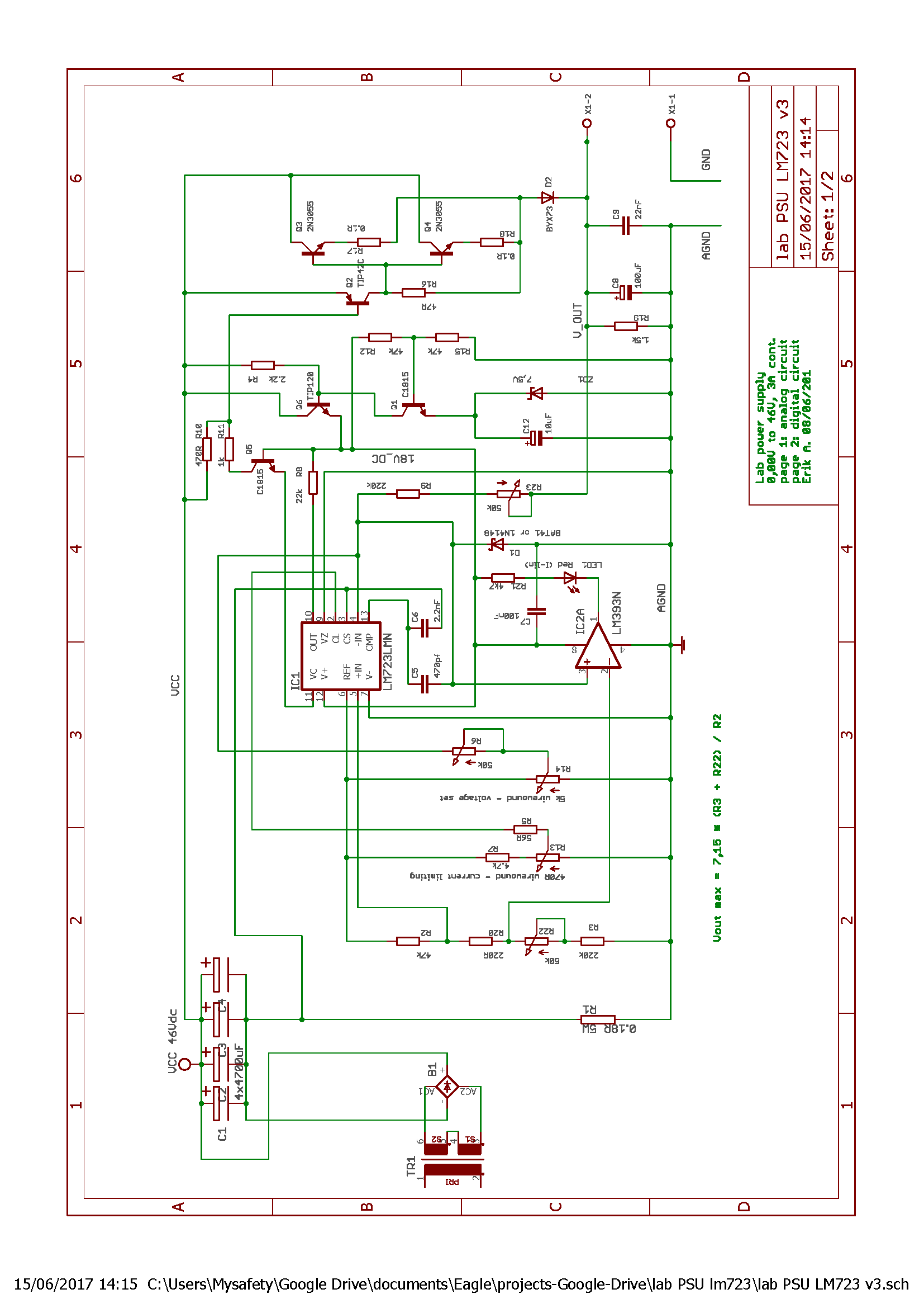

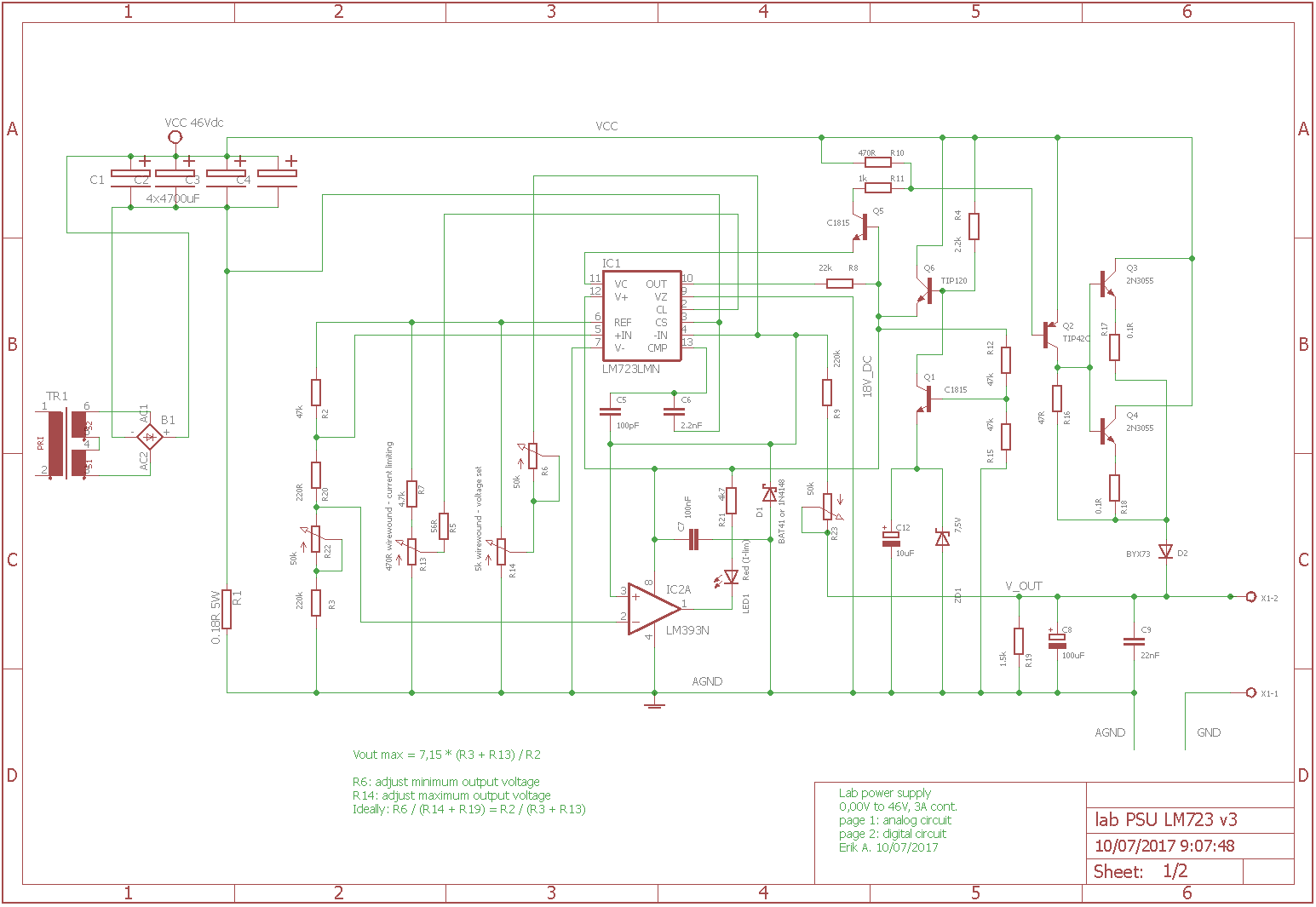

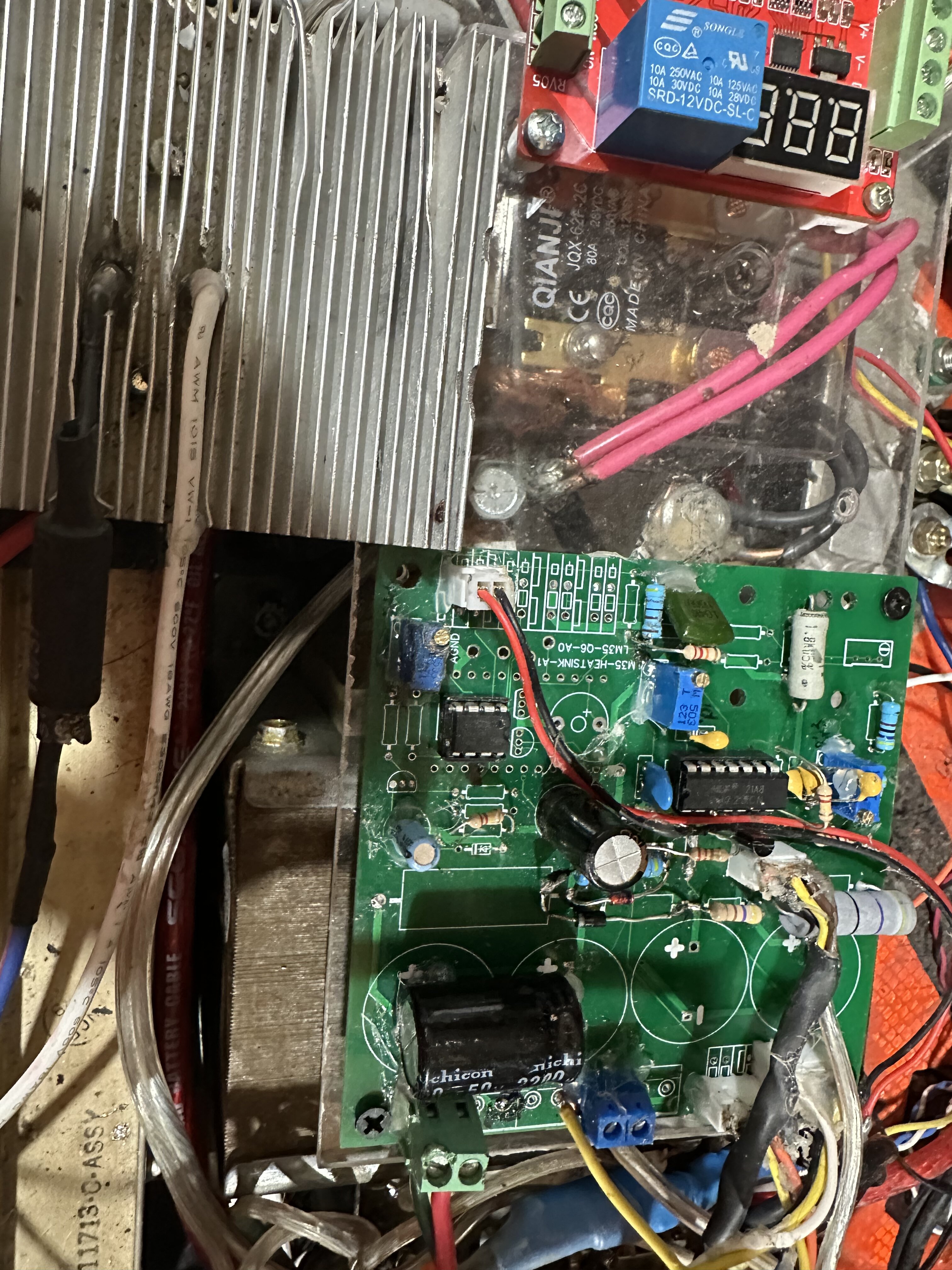

I have it working for the most part but ran into an issue of a capacitor that keeps getting hot and swelling up. The capacitor is is c8 on the schematic. I was testing the current limit and when I go anywhere lower than 9vdc at right around 18 amps the capacitor which is an electrolytic (100v/100uf) starts high pitch whining gets hot and swells up. I’ve replaced it but same thing. Would some metal film capacitors work? Any suggestions?

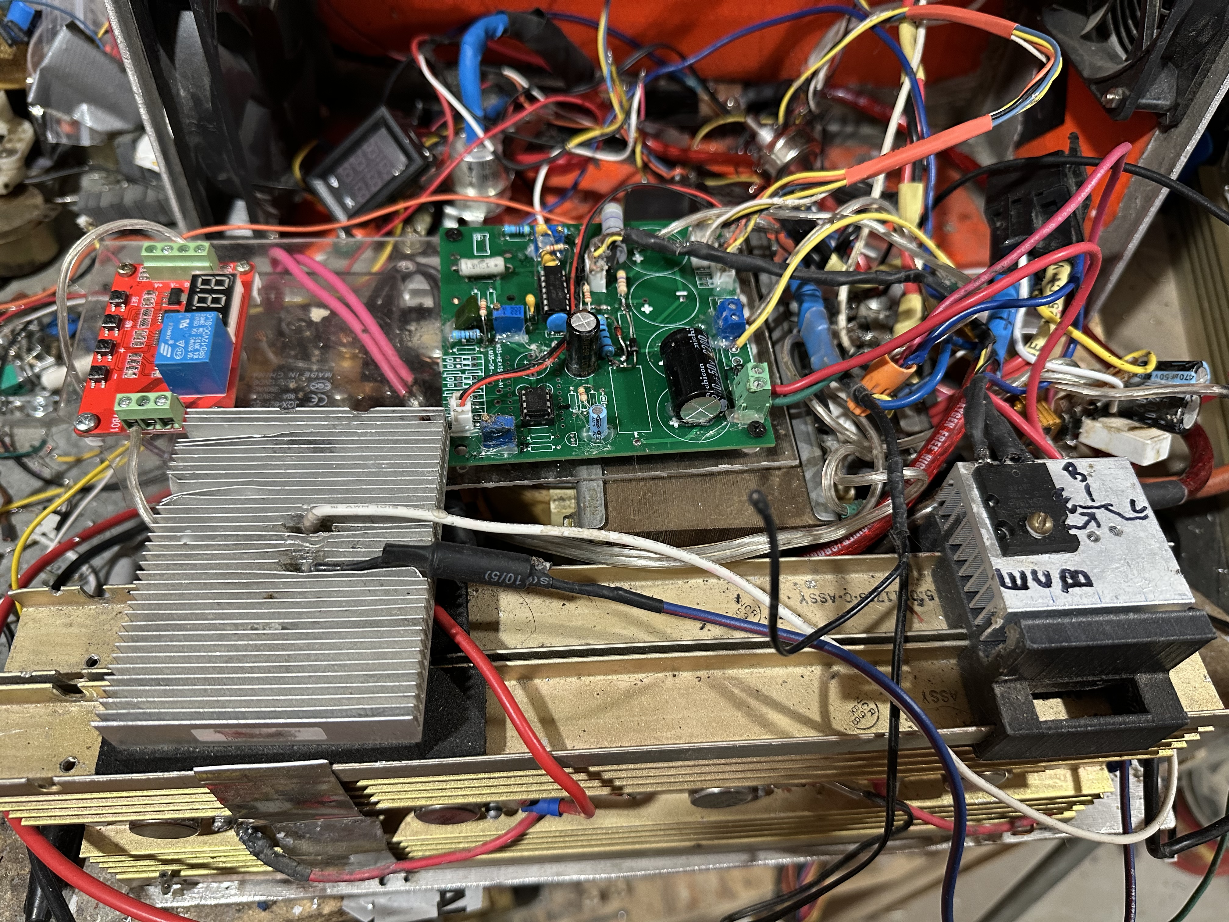

I’m using a big 1.0kva transformer that has 12/24 secondary taps. Which I have hooked up to a relay and volt sensing circuit that switches the taps automatically to reduce heat on my transistor’s. For those I’m using 2n5686, nine of them on large heat sinks.

What do you see on scope on C8 when first powered up ?
Regards, Dana.

Unless I am mistaken this is a linear regulator application ?
But to your point if the regulator is oscillating at low V OP discusses that cap
may be inadequate to handle the oscillation current/V......
