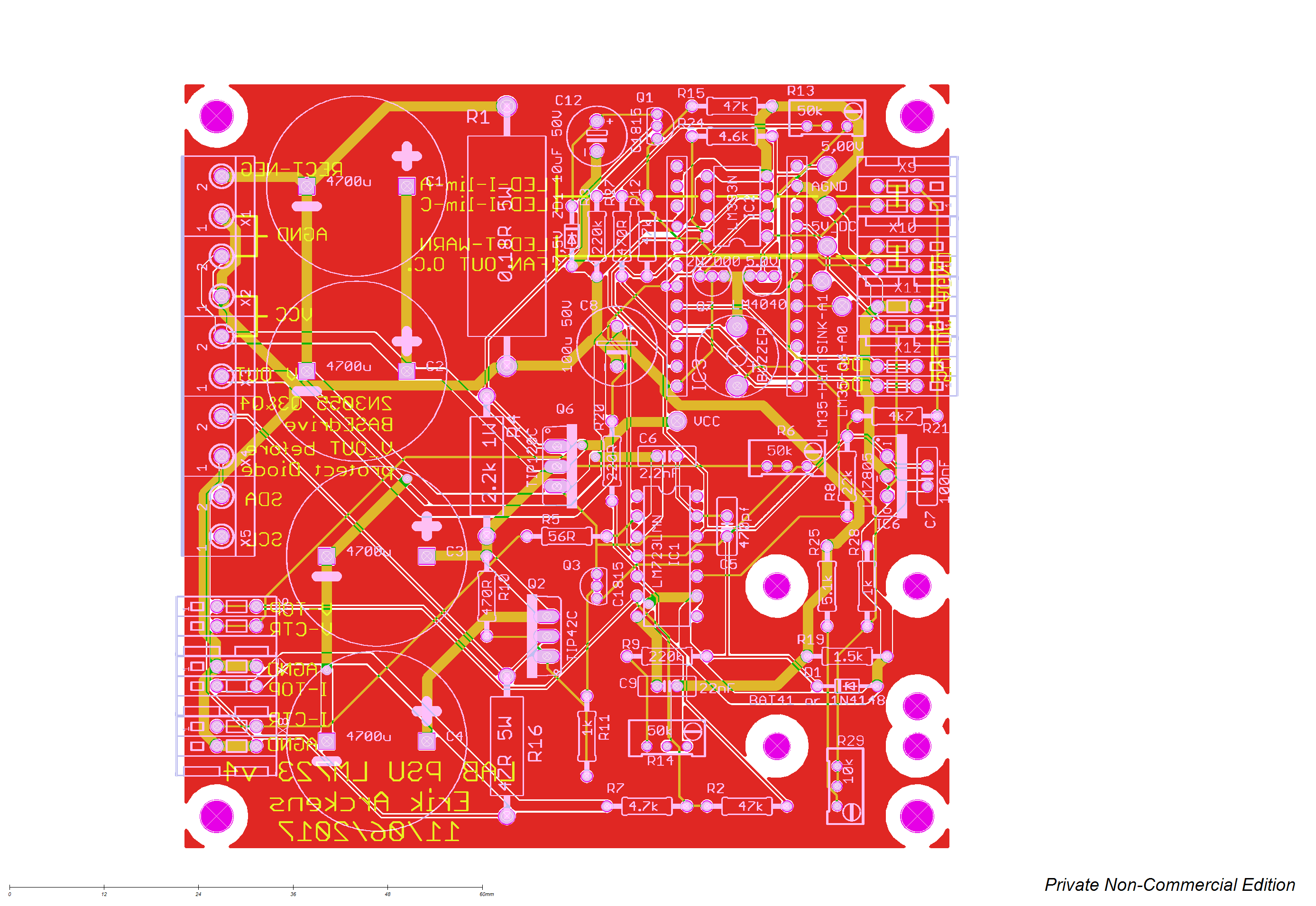

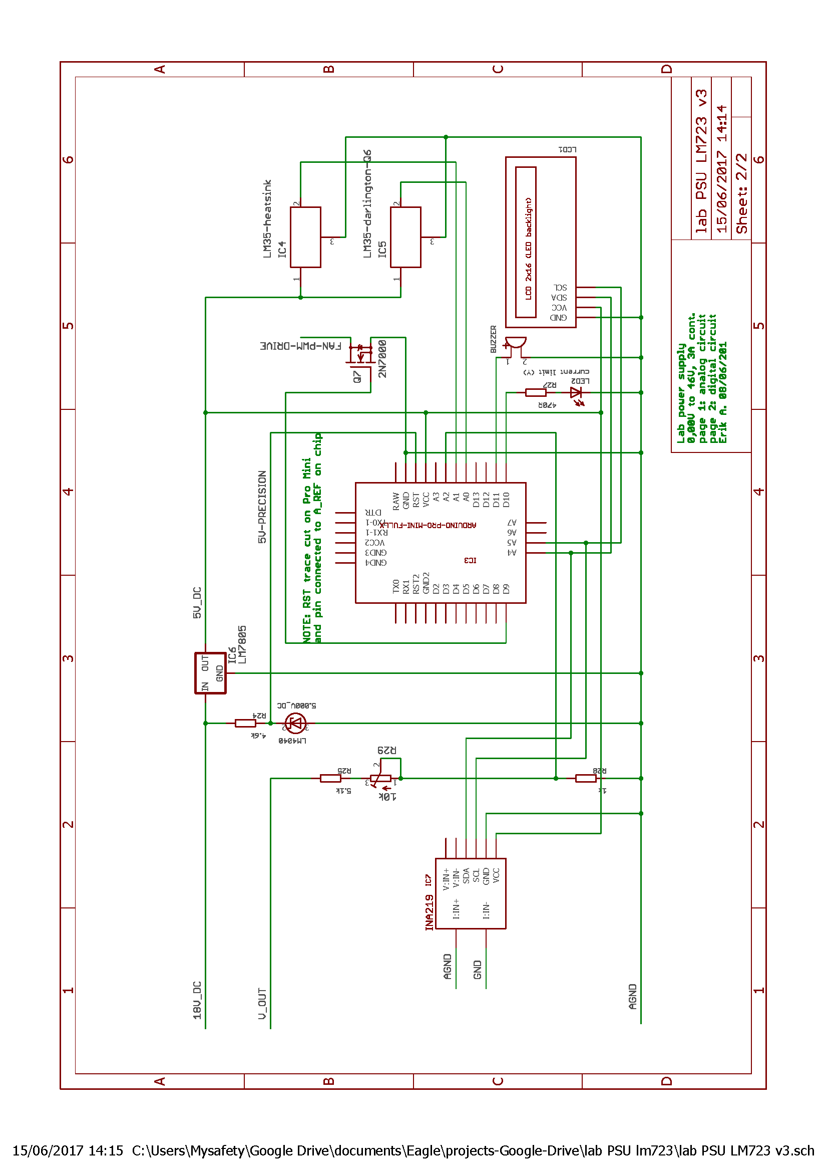

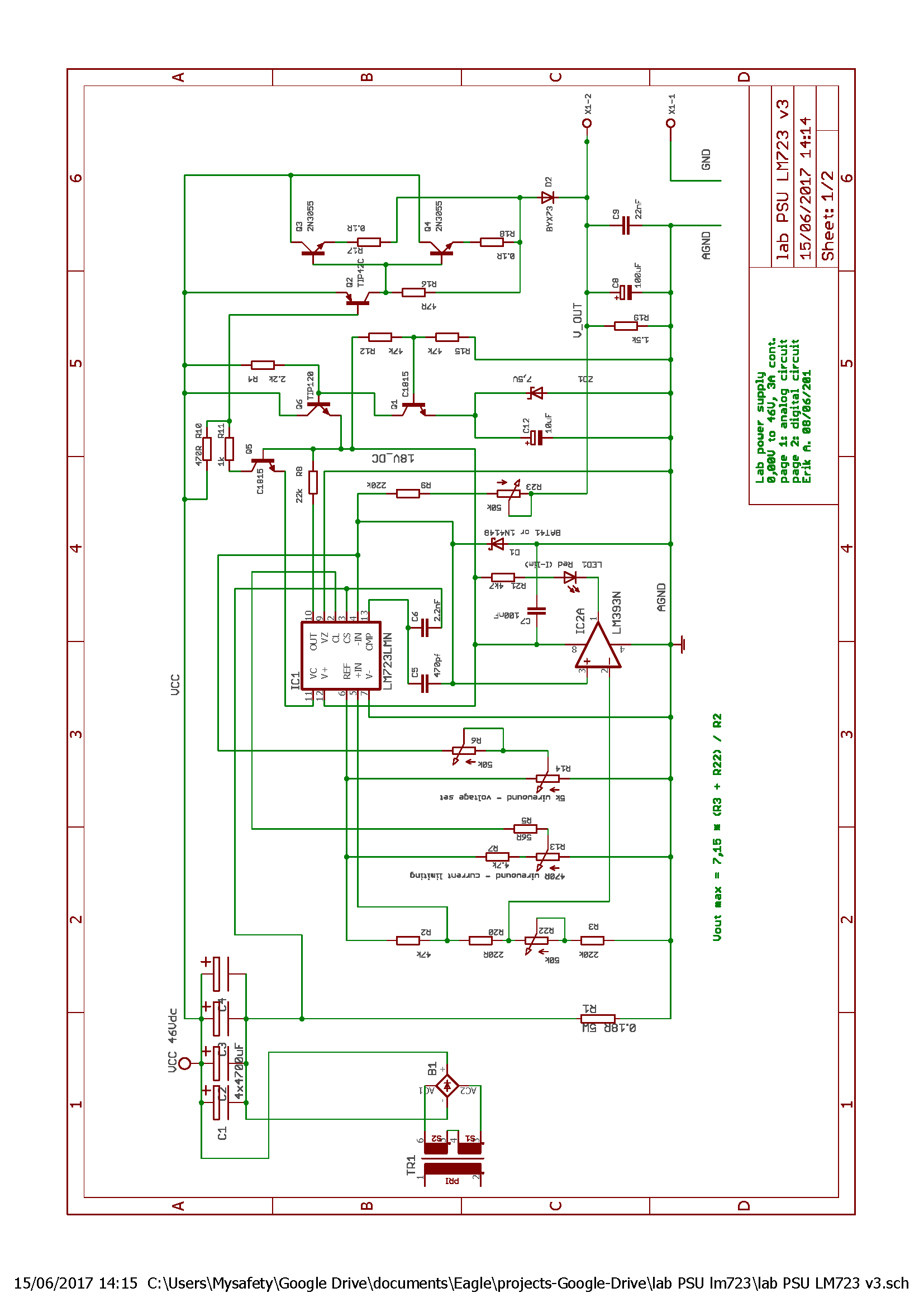

Hi everyone, finally I did get all paperwork updated, and can present you with a full set of drawings ready for use including the controller program code (hex code for Atmega 168 or 328) and the digital section of the psu.
Little recap: it all started when in October last year I blew up the transformer of a 30 year old lab psu I had made in my student years and I wanted to rebuild the thing. Because it had the nice feature to supply 0,000V lowest output voltage up to 30V at 3A. But this time I wanted it do go from 0,000V to about 46Vdc, still at 3A continuous rating.
I also wanted to include a controller to display on a 16x2 LCD the output voltage, output current, and the temperatures of the darlington (Q6) inside (which goes at a steady 60 to 80°C), together with appropriate audible warnings as well as display warning messages, as well as a LED to indicate the current limitation is active, as well as another LED to show extra warning signals for overtemperatures.
Again a big thank you to all who did help me with this project since October last year.
I will of course gladly help anyone wanting to fabricate this unit.
Grts,
Erik
Edit 16/06: changed Q7 fan driver from npn to n-channel MOSFET 2N7000
**broken link removed** **broken link removed**
  • Arduino_LCD_voltage_current_ina219_v8.ino.eightanaloginputs.hex
  • Arduino_LCD_voltage_current_ina219_v8.ino.with_bootloader.eightanaloginputs.hex
And here is the brd file.
Edit: and a png picture
  • lab PSU LM723 v4.brd
Update: C5 to be changed from 470pF to 100pF.
Just a few days ago I received a new oscilloscope and I checked the output of the PSU. The output vo ltage is fed to a microcontroller for display, to 10mV resolution. Until now this display jumped all over the place within 800mV range; I had been looking into software issues, or ADC problems but with the scope I established in effect up to 400mV 5kHz to 8kHz sawtooth ripple. A number of hours were spent trying to solve it, and finally the culprit was found: C5.
The .brd file needs no update, just the schematic:
