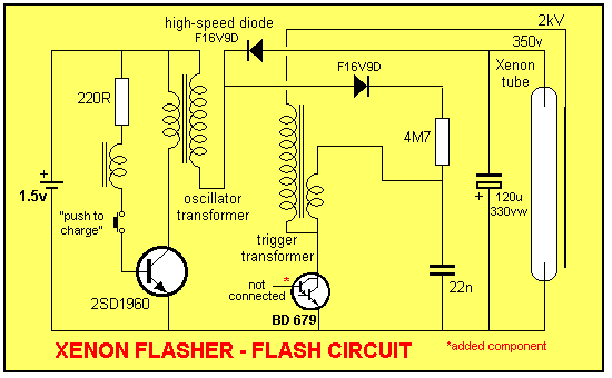

This is what I have, from dispoabe camera:
There was a switch for charging somewhere near transistor but I made short connect on that, becouse I want to be charged all the time.
[FONT=&quot]The oscillator made up of the transistor and transformer is called a BLOCKING OSCILLATOR.
When power is applied, the transistor is turned ON slightly via the 220R resistor. This causes current to flow in the collector-emitter circuit and the primary winding of the transformer. The expanding flux produced by the primary also cuts the turns of the feedback winding and this winding produces a voltage that adds to the supply voltage to increase the current into the base of the transistor. This causes the transistor to turn on more and the whole action increases until the transistor is fully turned on. At this point maximum current is flowing in the primary of the transformer but it is not expanding flux and the voltage produced by the feedback winding instantly stops. This turns off the transistor a small amount and now the current in the primary winding decreases. This causes a reduction in the magnetic field and the feedback winding produces a voltage in the opposite direction.
This voltage opposes the supply voltage and the net result is to turn the transistor off more.
This continues until the transistor is fully turned off. This happens very quickly and the collapsing magnetic field collapses very quickly. The transistor is effectively removed from the circuit and the winding we are now interested in is the secondary. This winding consists of many turns and since the field collapses very quickly, a very high voltage is produced in this winding.
The energy of the magnetic filed is converted into a high voltage and it finally collapses to becomes zero. During this time it is producing a voltage in the feedback winding that is keeping the transistor turned off.
The feedback voltage finally becomes zero and now the voltage delivered from the supply rail via the 220R starts to turn the transistor on again to begin the cycle again.
[/FONT]
The operation of the BD679 is even more interesting.
It is simply a transistor with a collector-emitter voltage of 80v. This means it is a transistor that will operate in a circuit with a rail voltage less than 80v.
In other words it is a device with a zener value of 80v.
The transistor breaks down completely at 80v and the voltage across it is just a few volts.
This means the circuit operates quite normally when turned on and the electrolytic gets charged to a few hundred volts.
During this time the 22n is charged via the 4M7 and when the voltage on the 22n reaches 80v, this voltage is passed via the trigger transformer to the collector of the transistor.
The transistor instantly breaks down and takes the end of the trigger transformer to the 0v rail and the energy in the 22n is passed to the primary of the transformer. This gives the transformer a spike of energy and the secondary produces about 4.5kV.
This is sufficient to ionize the gasses in the zenon tube and allow the 350v from the electrolytic to produce a discharge through the tube to produce a bright flash.
