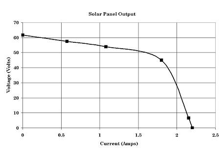

The graph you show for maximum power transfer and your statements have confused the OP as evidenced by his question about placing the solar panels in parallel rather than series. There are two aspects:

I find that type of graph confusing anyway, although it is used quite often. The characteristic of a solar cell is essentially a constant voltage (band gap) with a varying current capability proportional to the intensity of the incident light. It is not, in principle, a constant current with varying voltage. As such it is very similar to many load lines.
Because of this, in principle, MPPT is not exactly rocket science, although to read some of the information on the net you would think otherwise. No doubt MPPT gets more complex with some solar panels, and if you are trying to extract the last 5% of power.

Best case energy of 20Watts is with the PV loaded at 80% Voc MPT for a PV which it is the best matched load voltage to deliver the most current*voltage product. current source only at this voltage.
PV's are not true current sources but current sources with voltage limits "almost like a zener", so MPT is the 80% maximum power just below this "zener -like" open circuit voltage. It does not shunt current internally, rather it affcts the efficacy of converting light energy to electrical energy. EVen at 80%Voc, efficiency is only ~ 20% give or take. It is not an LDO just an impedance matching of a lousy current source by voltage ratio.
You dont use a potentiometer to create this 17V!
You load the PV (current source) with either a fixed battery of 17V ( and a full charge switch) or a fixed DC-DC converter of 17V from the panel. Then use another DC Converter or battery to store at 12V . That's for max efficiency. So a MPPT regulator is the 1st DC-DC regulator, but it hunts for max power depending on temp and available input solar power.
THe reason why is MPT is because Voc drops 10% with rising temperatures( actually a linear NTC) and another 10% lower solar input power , yet Pb acid batteries rise 8% in voltage from 0 to 100% SoC. So this almost 30% swing means to lose efficiency unless you use a 98% efficient MPPT regulator then a 98% efficient Buck regulator.
