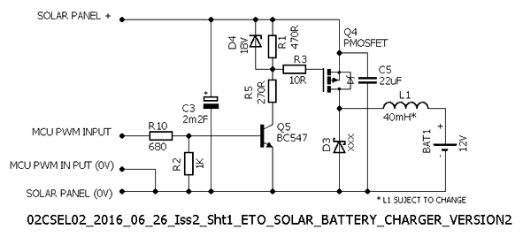

The solar panel will only give out 560 mA max. If you are using a buck converter you are expecting to take the full output current, which could be nearly 1.6 A, some of the time and zero current the rest of the time. You need a capacitor, most likely electrolytic or tantalum, that can supply the current for the time needed, and then charge up when the buck converter is in the off period.
If we assume 100% efficiency, the output current will be 34*0.56/12 = 1.586 A. If you are running at 20 kHz, the period is 50 μs. The time that the output is on will be 12/34 = 35% of the time. The capacitor has to support 1.586 - 0.56 A for 35% of 50 μs, so the charge is just over 6 μC. With the 22 μF capacitor suggested, the change in voltage will be just over 0.25 V, so that looks fine, but the ESR (equivalent series resistance) of the capacitor will also have to be considered. There is no disadvantage in having a much larger capacitor.

I suggested a 22uF ceramic capacitor and a 2m2F (2,200 uF) capacitor in addition. But it could be that the solar panel assembly already has a large capacitor fitted.

Your inductor, is it really 40 mili Henrys or did you mean 40 micro Henrys.

Just done some calculations on the inductor:
(1) ASSUMPTIONS
(1.1) Inductor: 40mH
(1.2) Input voltage (from solar panel): 34V
(1.3) Battery Voltage: 12V
(1.4) Switching frequency (PWM): 20KHz
(1.5) Switching mark-to-space ratio: 1:1
(2) CALCULATIONS
(2.1) Switching period= 1/20Khz= 50uS. Thus half period = 25uS
(2.2) The voltage across the coil in the coil charge phase (MOSFET on) is 34V-12V= 22V
(2.3) Q= LI= VT. Thus maximum coil current (I) = VT/L = (22V*25uS )/40mH= 13.75 mA
(3) CONCLUSION
The inductor value is around two orders (x100) too high or the switching frequency is two orders too high.:)

Have you designed the system to be continuous, 40mH sounds very high for the inductance.

:nailbiting: That value was calculated by an online calculator. Is it wrong?? Can you please calculate inductor value for me? I am totally lost. Should I increase frequency?
As per buck converter theory the current should be raised to about 1.5 A in this circuit. And the inductor should be able to withstand this much current. As per Spec's calculations the Imax through the inductor can be 13 mA only. How should the inductor be designed? Please help.

No increasing the frequency is the wrong direction. reduce the switching frequency to 2Khz and gradually reduce the frequency until the buck converter is working correctly (I hope). The correct frequency with that inductor is around 200Hz at a first approximation.
You say that you only have 470uF connected across the solar panel. This should be increased to 2m2F (2200uF) like I said.

You can keep a switching frequency at 20KHz but then you would need to reduce the inductor to 400uH. That means that you would only need one tenth of the number of turn on the inductor that you have now.
By the way, the inductor wire needs to be substantial. It would be good to wind two wires side-by-side for the inductor winding.
Can you show a picture of your inductor with a ruler by it to indicate the size?

For 40 mH I think I have 4- 500 turns. So now I need only 40- 50 turns. Right?
And the inductor is a transformer EE type which I found in an old smps.
