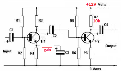

It is simple to cascade two transistors to make a gain of 365 and have an output swing of of 8V and an output of 10k ohms. Here is a simple design found in Google. If the first transistor has a gain of 40 and the second transistor has a gain of 9.125 then the distortion will be reduced.
Except the output impedance won't be 10K, it will be less than that.

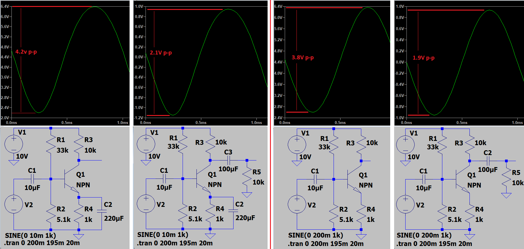

The output impedance of a common-emitter transistor is not less than its collector resistor value. It would be less if the collector has some negative feedback added.
My simulation shows that if the transistor with a 10k collector resistor is loaded with a 10k load then the output swing drops to exactly half, even when the emitter resistor is bypassed or not.
Therefore the output impedance is the collector resistance.

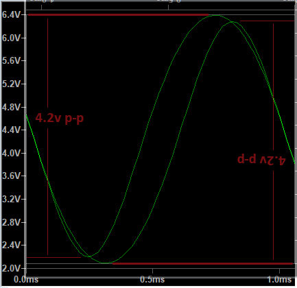

AG, that circuit has some serious distortion! - can't you see how asymmetric the output is?
This is the first waveform with a rotated version superimposed to show the difference:

Of course the high gain transistor (2.4V output/10mV input= gain of 240) has distortion, the output is high level and there is no negative feedback.
As shown with an emitter resistor producing negative feedback and reducing the gain to 19.5, the distortion is much less.
