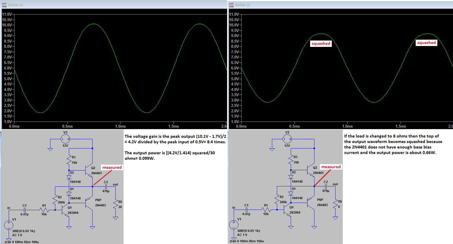

The required gain is very low so 3 transistors should be able to do it.

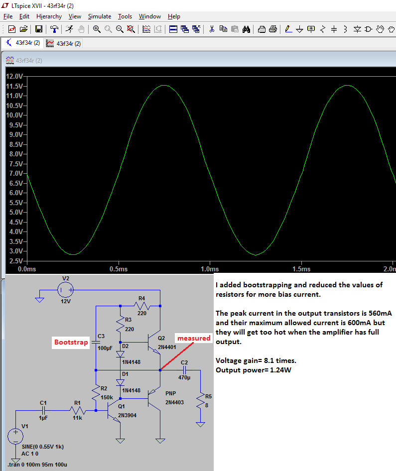

The small 2N4401 and 2N4403 transistors will get extremely hot but should be able to produce 1.24W into an 8 ohm speaker with the 12V supply.

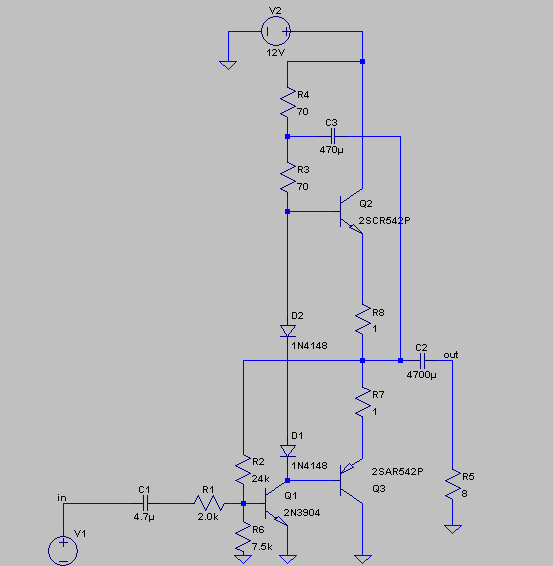

I show simulations of the original circuit with its 30 ohms load and with an 8 ohm load.
I added bootstrapping and reduced the resistor values and show the simulation.
I changed the load to 8 ohms so we can get 3 watts from a 12V supply.

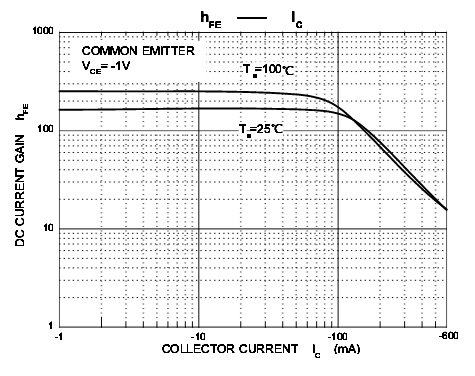

problem: We need more current. The little output transistors can not with stand the heat and the current is very close to the max the part can with withstand. I chose 5A transistors not 600mA parts. These parts can connect to a heat sink to get rid of the heat.
Below is a graph of the old transistors. You can see the current gain is about 200 with current below 100mA. At 500mA the gain drops to 20. By choosing a bigger transistor there will be good gain at the desired current. So start at the load. Find what voltage, current and power you need. Choose transistors designed to work at that level.
To get 10x more current in the output you need (about) 10x the current in the bases. I changed the resistors to get about 10x more current through out the amplifier.
The goal is not clear to me. I think your teacher wants 10x more power out. So change the output transistors to parts that can work well at 10x the current.

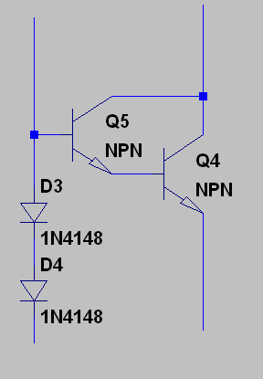

Another option: (every thing in this picture functions as one, very high gain transistor)
Increase the current and power capability of the output transistors AND (increase the current gain) so Q1 does not need to be changed. Q5= the old low current transistor. Q4= the new high current transistor.

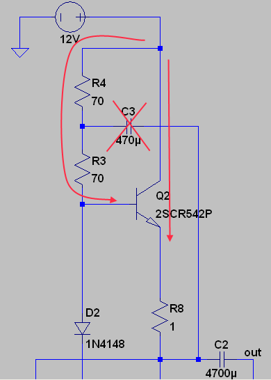

Question: Why do I need two diodes? D3, D4
Question: What is Q5+Q6 called?

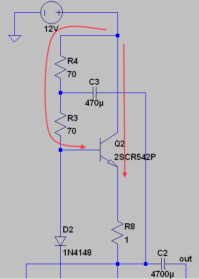

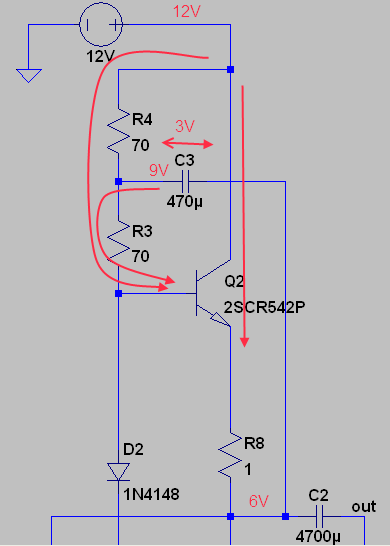

What is the purpose of C3 in your circuit?
With out C3:
When you turn on Q2 hard; there is little voltage across Q2 C-E. This will cause there to be very little voltage across R3. Q2 will not turn on well because you can not get base current. (no voltage - no current)
At steady state; (No signal) The output is at 6V or 1/2 supply. There is 3V of charge on C3.
Transistor on hard with on C3. Q2E=11V Q2B=11.7V So the current into the base is only 0.3V and (70+70) ohms. About 2mA (base current) is not enough current to get much emitter current.
Transistor on hard with C3! Because there is 3V stored on C3, when Q2E=11V the bottom end of C3=11V and the top end of C3=14V. Q2B=11.7V. Across R3 there will be 2.3V. 2.3V/70 ohms = 33mA. By adding C3 we increase the base current from 2 to 33mA. So the emitter current can be 16 times more.
This is called boot strapping.
Reach down, grab your shoe strings and pull hard. If you had gain like the transistor you could pull your self off the floor.
Thank you. I read a little about bootstrap and understand what you are describing. I also understand you want the discharge rate to be longer than transient input switching period. How did you come up with value? Based on longer than 1khz time period using 1/2pixfxc formula? How did you decide that the top of C3 is applied to the bottom 70 ohm and not, let's say, to the base directly? You need a resistor to slowly discharge it?
1/2pixfxc formula
Yes,
An audio amp should work to 20hz. (more or less) But right, if you are only amplifying 1khz then the cap should not discharge much in 1/1000.
What we are trying to do is make a little supply that is greater than 12V to pull up the base. We could have removed the resistor from +12V and connected it to a 15V supply and had similar results.
Yes,
What are the cons to your bootstrapping in brief and should we be worries about cap discharging and transistor to shut off before the down cycle and even worse the next up cycle?
Thank you in advance for your answers. It helps me understanding designing them better.
Since audio frequencies go down to 20Hz then you want an audio coupling capacitor to have its reactance equal to or less than its load resistance. But this amplifier has three coupling capacitors so the reactance should be calculated at 20Hz/3= 6.7Hz.
The calculation is simply C= 1 divided by (2 x pi x R x f).

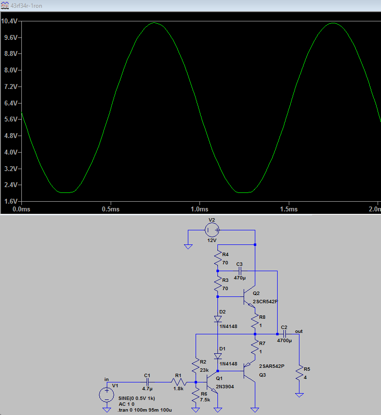

With a 12V supply the maximum output swing might be 8.5V p-p which is 3.0V RMS. Then for an output of 3W the load must be 3 ohms which is almost a dead short and the peak current will be 1.42A.
Ron, your amplifier has clipping at the bottom of the waveform. With your 4 ohm load its output power is only (10.4V - 2.0V)/2 divided by 2.828, squared, divided by 4 ohms= 2.2W. With a load that is 3 ohms then the output is 3W.
Ron, I zoomed your schematic so its details are visible:
