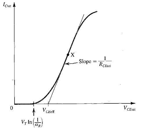

When a BJT is operating in saturation region, the relationship between the collector current and the collector-emitter voltage can be plotted as below, that is, there exists an offset voltage Vceoff.
A MOSFET on the other hand, when operated in triode region, its drain current vs. drain-source voltage curve goes right through the origin of the Id-Vds plane.
Why does the offset voltage of a saturated BJT make the BJT less attractive as a switch than a MOSFET?

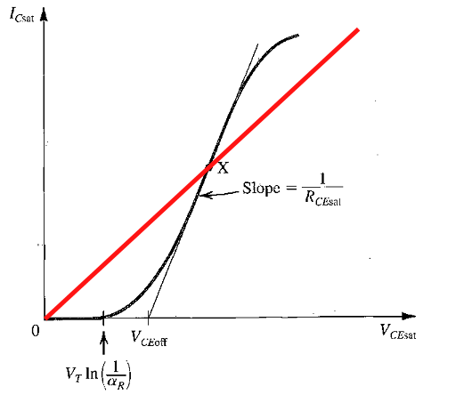

I added a RED line for a MOSFET. It is much like a resistor.
Your black line is for a BJT.
This sounds like a question your teacher asked.
1) At low current (or zero current) the MOSFET will have lower voltage across it. So at low current there is a advantage to BJT. If voltage is all you are thinking about.
2) At high current the BJT has less voltage across it.
Why is the BJT less attractive? That depends on how you are using it. I think your teacher is looking for the answer that the BJT never really has zero voltage across it, if there is any current flow.

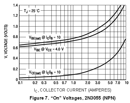

Here is a graph for a large BJT. The bottom line is Vce. Current is from 100mA to 10A (log graph not liner)
Note the base current is held at 1/10 the collector current. So at IC=10A the IB is 1A.
