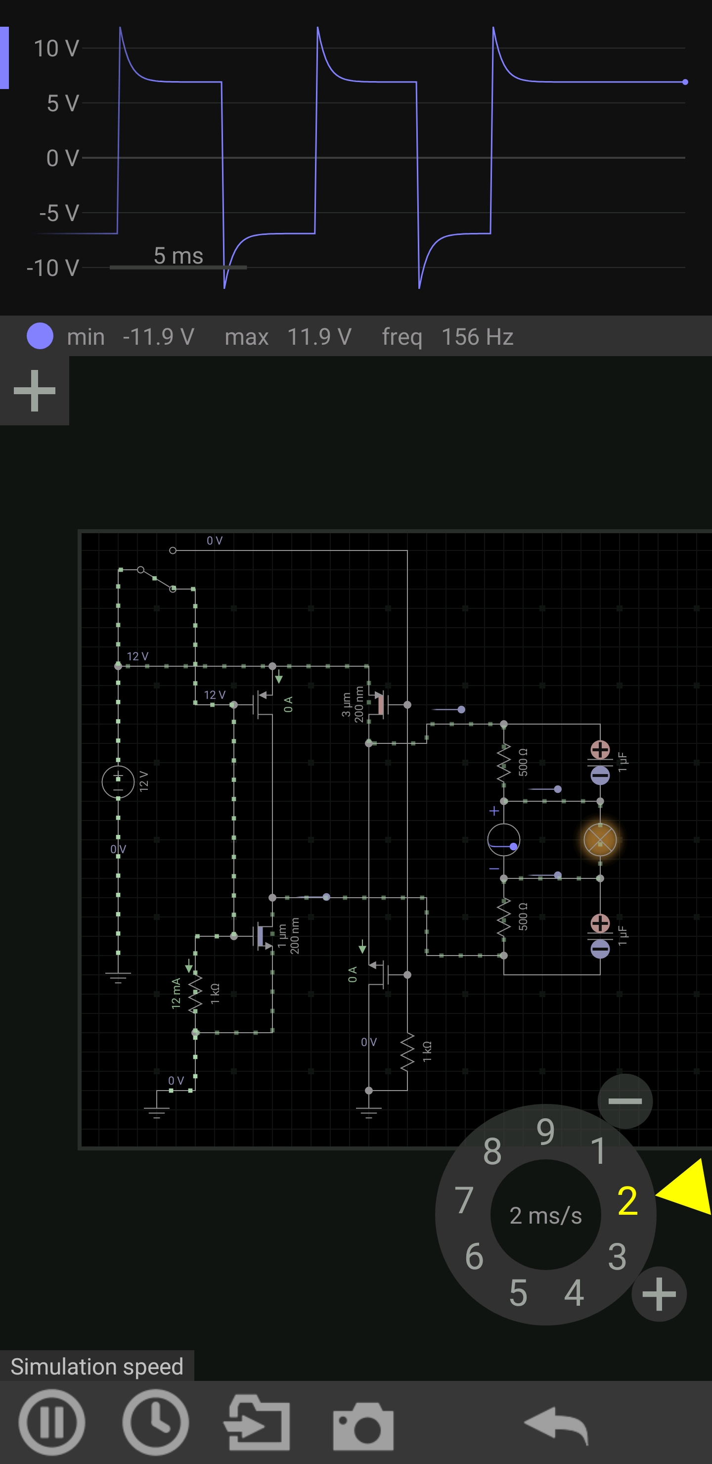

A simple method:
Add a resistor in the positive feed to each side of the H bridge to set the holding current, and add an electrolytic cap across the resistor.
Each time it changes over, the capacitor will provide full current for a short time until it charges, then the resistor maintains the low current.
When it changes back, the other side does the same and that side cap discharges via the resistor.
Something like this.
I was thinking just something like a 470 or 1000uF cap across the resistor - but that looks to work fine and could be "tuned" for timing with low power presets, rather than changing electrolytics!
Good for single polarity. But the OP needs a circuit that changes drive polarity.
So, it's a starting point. The TS already has a H-bridge. So, the enable pin gets a PWM signal.
Then you have to play games with rising and falling edges of "direction" that triggers the circuit and changes the polarity.
Still doable.

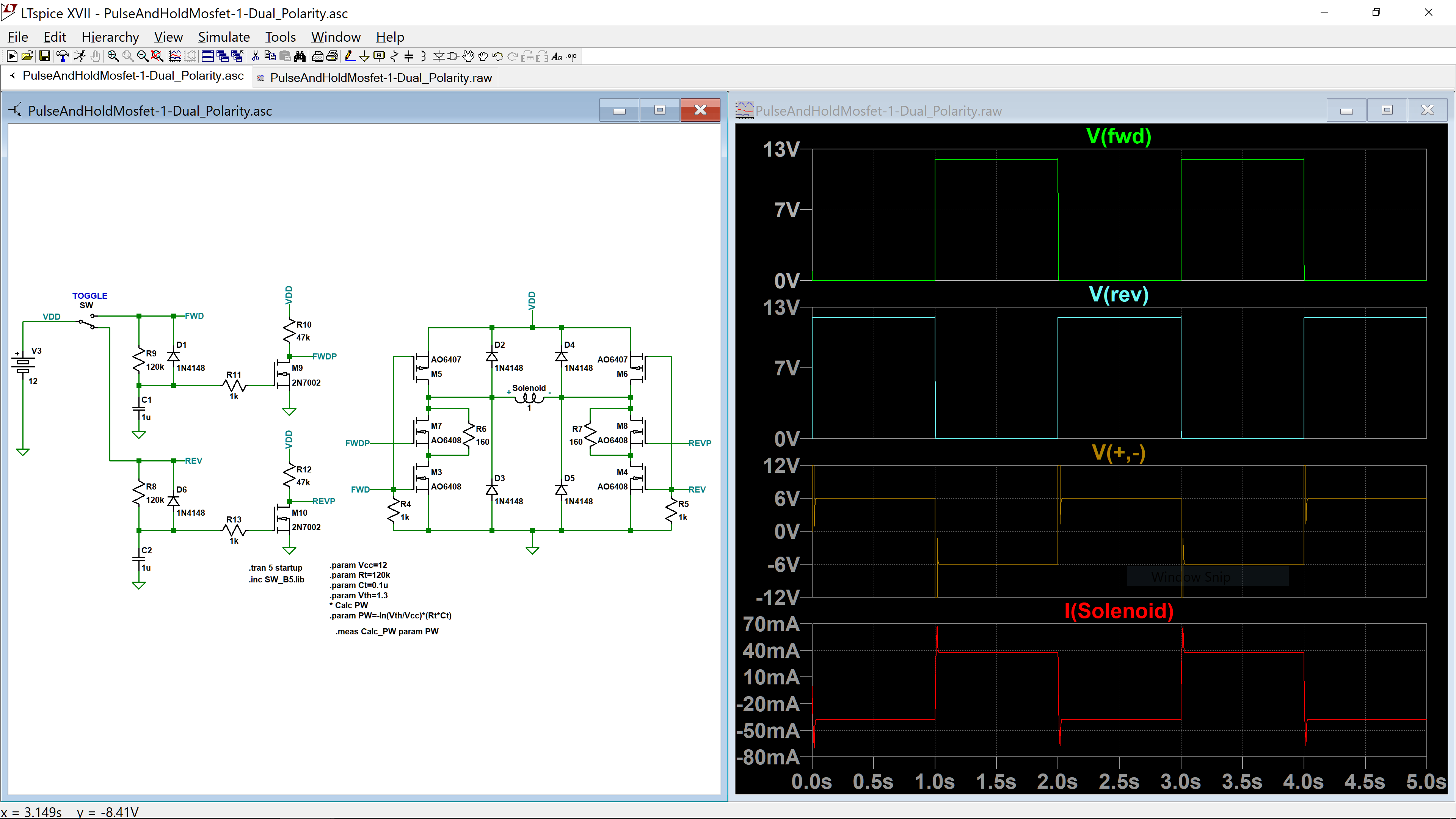

Is this any good?
I can't make that out...
Go back to your first schematic and just replace the centre FET at each side with an electrolytic cap, leaving the resistor etc. as is?
Plus you can remove the stuff that controlled those extra FETs.
yea, kinda did it like Danwvw but I threw in a transistor. I needed a logic level trigger of some sort. i don't quite remember the design, Too long ago.
