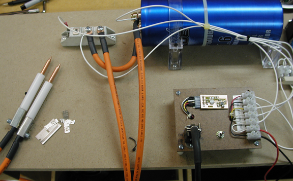

I have had a couple of questions and received great help in adapting a capacitor-discharge spot welder design that was originally referenced by Pommie (See: https://www.electro-tech-online.com/threads/why-the-dip.35601/ ; and https://www.electro-tech-online.com/threads/zener-reference-voltage.35232/ ).
I appreciate it when contributors post follow-up , but noticed the titles for those other threads did not mention spot welder. So this thread is iniated to give follow-up and includes spot welder for subsequent searches.
The design basically follows the idea of Phil Pemberton (https://www.philpem.me.uk/elec/welder) and was modified to include a debouncer for the foot switch and a Variac rather than adjustable regulator for the DC power. I wanted more current to charge the capacitors. I also used audio stiffening caps of 1.6F and 0.5F rather than a bank of computer caps. The 0.5F (Scosche brand) seems to give slightly better welds than the larger Pyramid brand, but that result is preliminary.

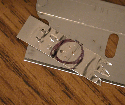

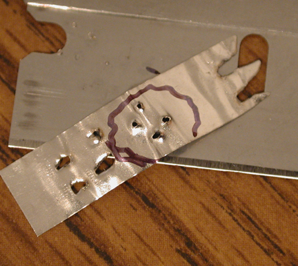

So, here are the results. The overall photo shows the prototype setup with the electrodes, capacitor, and debounce/triggering circuit visible. The two weld photos show a razor blade with a strip from a battery welded to it. The other shows the reverse side after the weld had been pulled apart and is intended to show the good penetration. Welding strips has been a problem, as it seems easier to blow holes in the material than to get a good weld. I will probably dull the tips to my electrodes to see if that helps. I used reclaimed battery tabs as the price for nickel sheet (0.004) has skyrocketed.
The next experiments and modifications will include using an IGBT to perhaps shape the discharge time, maybe a short blast followed by a longer one (using two capacitors) or using a cheap 90A tig welding supply ( about $100 at Harbor Freight).
Any comments or suggestions will be welcome.

Hi John,
Glad to see that you are not just satisfied with a run of the mill cd tab welder. I'm interested in tab welding together some of the A123 cells I have for my electric truck. So I am following your progress with great anticipation.
I've often thought that if the shape of the pulse could be controlled like on the professional welders, that higher quality would be the end result.
It will be interesting to see the results of your IGBT testing.
Mike

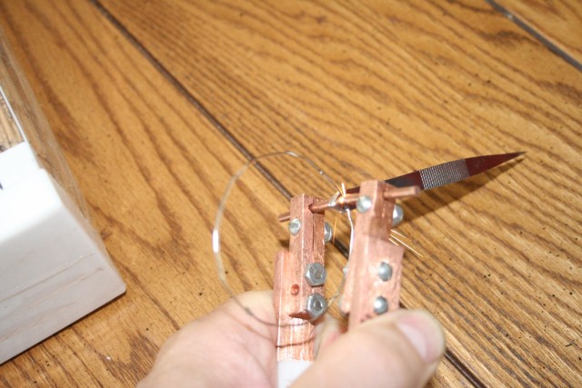

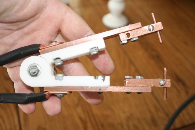

This welder compares to the welders of Sunstone Engineering - Fine Resistance Spot Welders, Weld Heads, and Welding Accessories and puts out 60Ws more than their $5400 welder. If i need to weld big things, I would build one of that microwave transformer welders. I've welded bottle caps together which is about 0.05", jewelry, copper wire and many more things. I mainly made this welder to weld battery packs and the energy i use is about 72Ws....it can go up to 600Ws. The welding tips on this welder does not get damaged by welding battery packs and will last very long. With the pulse width and voltage adjustment It can weld very fine wires and things like jewelry.
I see Sunstone brought out a new welder with a digital display and they changed their volt setting to Watt Seconds and the time of the weld to Joule. Ws And Joule is the same thing but I decided to change my machine's YouTube - Capacitor Spot welder display too.
This weekend i used my CNC machine to make a hand held attachment for my welder...here are the photo's:
