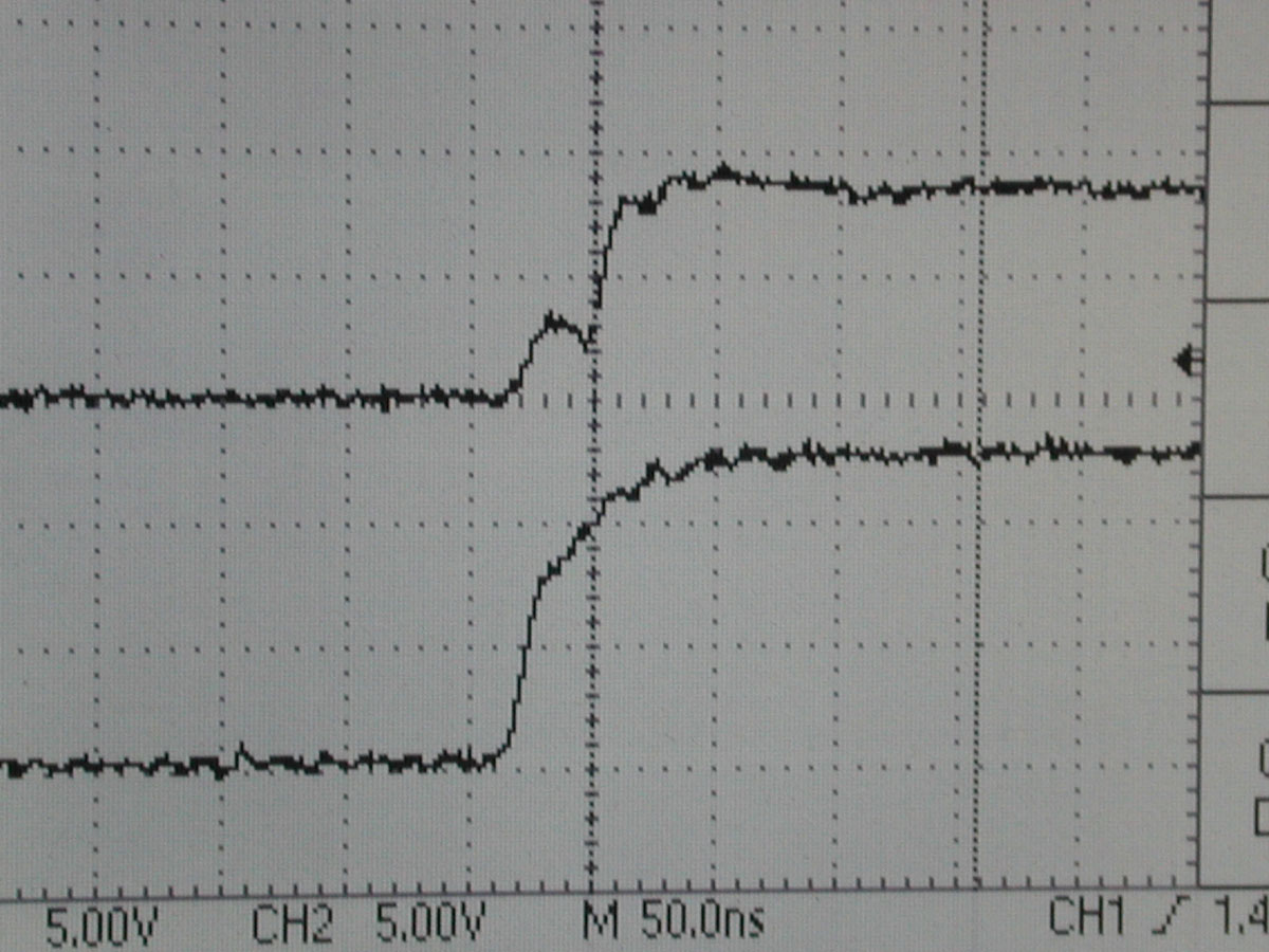

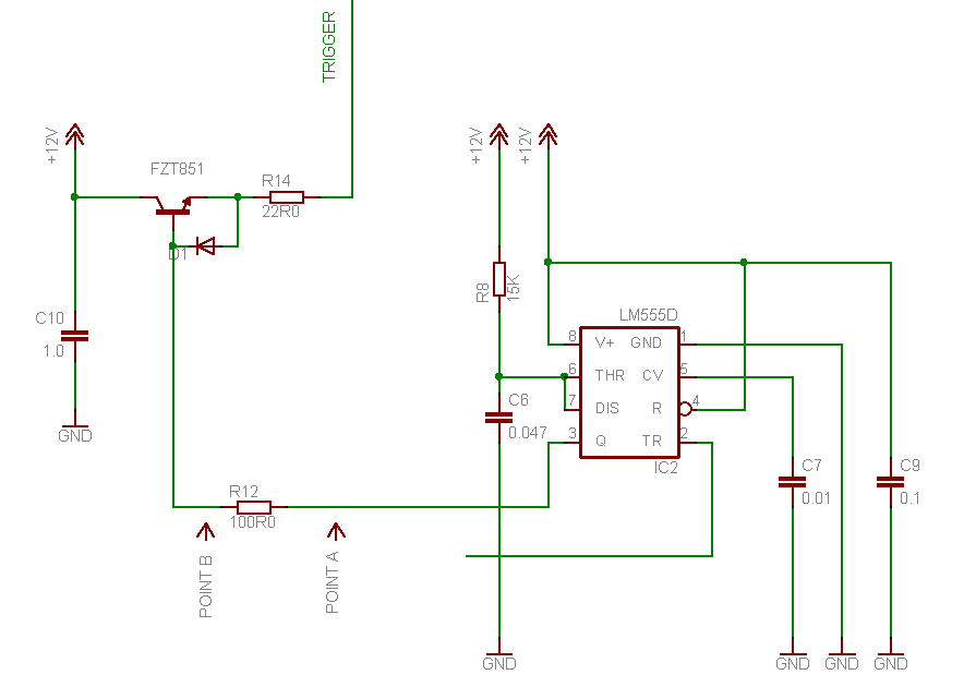

The oscilloscope tracings shown below are circuit at R12, which is the base drive for an NPN output transistor. I have omitted some aspects of the circuit for clarity.
The TOP oscilloscope tracing (50 nS sweep) is taken at Point B (“after” R12); the BOTTOM tracing is taken at Point A (“before" R12).
Why is there a dip in the tracing made at Point B (after R12)?
Thanks. John

Does using the different diode change the timing of the DIP?
I did not carefully measure the timing of the dip; however, the dip looks to be about the same with or without the diode. I did not try different diodes, like Schottky. I also tried a Baker clamp (base to collector diode), larger bypass caps on the 555, larger cap at C10, and higher R for R14, but those changes had no or very little effect either.
It seems the base in FZT851 is turning on at different rates, e.g., a larger area abruptly starts to conduct shortly after initial turn-on. On Semiconductor has an application note (AN875) that seems to address that issue, i.e., the need for more base current shortly after start of turn-on. It suggests a snubber, but doesn't give any more information on the configuration.

I think the dip occurs because the base-emitter capacitance is not bootstrapped until the base voltage gets high enough that the emitter can follow it. Once that happens, the effective base capacitance is reduced, being mostly just collector-base capacitance. Since the emitter voltage follows the base voltage with near-unity gain, very little charge has to flow into the base-emitter capacitance once the transistor is active.
You don't generally need a base resistor on an emitter follower. Try removing it, if the dip bothers you.

I put it in to limit current from the 555 to less than 200 mA. The load will just be a pulse around 1 mS, repeated at most every 4 to 10 seconds. Would you anticipate any problem with such an arrangement? It's built using SMD, so putting a zero ohm across it will be quite easy as a test. I will let you know what happpens.
Would you leave the diode as shown, connect it to the collector (to mitigate potentially over driving the base), or eliminate it altogether? The load is a 90A SCR used in a capacitance discharge spot welder, and I put the resistor in initially as protestion from reverse biasing the emitter-base with any spikes. On the scope trace of the test circuit using only minimal current to keep the SCR conducting, not the full weldiing current, the emitter stays below the base voltage.

It's an emitter follower. The emitter voltage will always be below the base voltage, and the 555 can never drive the base above the collector. The base current is basically the emitter current divided by beta+1. Since the emitter current is less than 500mA, and the minimum beta is 100, your 555 output current should never exceed 5mA, except on the transitions. 555s can easily handle short current spikes, so even if they do exceed 100mA, they won't cause a problem.
I would use a 470 ohm resistor from gate to cathode on the SCR, and get rid of the diode. The gate does need a path to ground for leakage current, and the diode doesn't do a good job of that.
EDIT: Is you welding load in the cathode circuit, or the anode? What is your welding supply voltage? If it is higher than +12V, I would put the load in the anode. In fact, I would do that in either case.

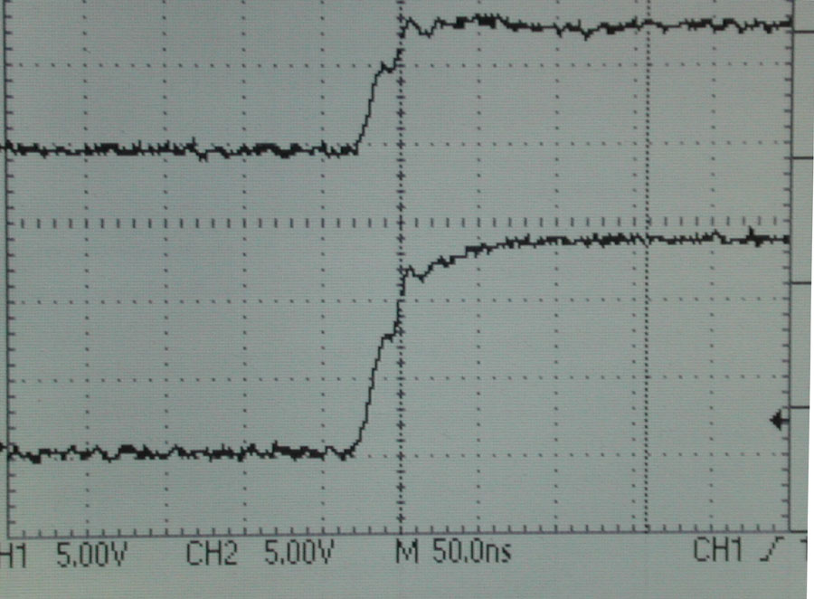

It worked! Removing the resistor, that is. Thanks, Ron.
The bottom tracing in the attachment is how it looks now.
I did not expect the emitter to go above the base without another factor. That factor was inductive kick from the welder. How it would get from the leads through the gate and back to the transitor, I don't know. It was just over caution. (Most of my experience has been with TIG, and the HF there goes everywhere, which obviously is not the situation here.) But, since the PCB is made, there is no problem leaving it off and adding later, if needed.
Stupid me, I calculated the potential base current
using a higher peak emitter current. I used the transistor rating (did I say dumb?), not the actual, realized it was getting close to the max for the 555, and threw the resistor in to limit it. Obviously, it limited it, and then I spent all of this time trying to avoid that limit without rethinking the original, wrong assumption. The peak emitter current should be a bit more than 500 mA as drawn (i.e., 12 V through 10 ohm). If I go to a 20 ohm gate resistor, then I will be back in the ballpark of 500 mA.
