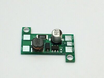

You can get a reasonably constant illumination by using a small LED driver PCB; they regulate the LED current rather than voltage and can work over a fairly wide input voltage range.
The LED will run as constant brightness until the batteries get below the minimum input voltage.
There are many types on ebay - a couple of examples:
You need to get one that provides the appropriate current for the LED(s) in use.
When the battery voltage is well above the LED voltage, the input current is rather lower than the LED current, so you also get longer battery life than with a simple LED + resistor setup.

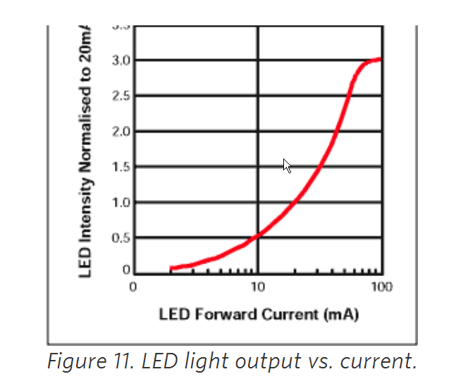

However, I think there's a much easier way to achieve what you're after. You say the LEDs are generating 100 lux now, but 30 lux might be sufficient. The attached graph shows that reducing light output by about 2/3s will cut the current drain in half. It also shows you're in a shallower part of the curve, where a change in current drain results in a smaller delta of light level.
Try adding a series resistor to reduce light level to the lowest acceptable level, which will reduce LED current. This in itself extends battery life, and the useable operating time is further extended because light fall-off vs voltage is reduced.
