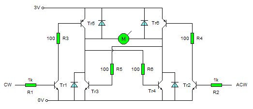

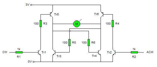

Here's how it should be done.
How much current does the motor need?
You may need to reduce the resistor values a bit.
As shown, it should be fine up to about 240mA.

Motor requires ~200mA. Sorry if this is a silly question, but what are CW and ACW? From the schematic it seems they refer to PA0 and PA1 on my uC. Clockwise and Anti-Clockwise?

Yes, there you go Giftiger, the circuit posted by H_999 is more 'the done thing'.
Although it's not as minimalist as the 2Fet 2BJT solution, this has the advantage that it uses cheap transistors, you know they're going to run saturated (that's good). As Nigel says, the 2 good points are it's driven from collectors and the base drive current is minimal.

Yes, ACW is anti-clockwise and CW is clockwise.
I missed the protection diodes off.
Another option is to use MOSFETs for the low side and BJTs of the high side.
I'd just go for the all BJT option though, although it uses more transistors, it'll be cheaper, more reliable and the components will be easier to get hold of - no search for exotic low threshold MOSFETs.

Hero's circuit is an H-Bridge. To run clockwise then TR1 turns on TR4 and TR5. To run counter-clockwise then TR2 turns on TR3 and TR6.
The analysis is:
1) If the output voltage of your micro is 2.9V then the base current of TR1 is (2.9V - 0.7V)/1k= 2.2mA.
2) The collector current of TR1 and base current of TR5 is (2.9V - 0.8V)/100 ohms= 21mA.
3) The collector current of TR5 is 21mA x 10= 210mA for the motor and for the base current of TR4.
4) The motor gets at least 210mA - 21mA= 189mA at 2.6V.
If your transistors have very good spec's then the motor will get more current.
Thanks for the explanation audioguru. I'll probably redraw the schematic so that I am sure I understand each component of it, as well as expanding the positive and negative rails to show the battery and uC ground attached. I believe I should be able to use my original idea of using PA1 for PA0's ground and vice verca, simply by connecting the green section of my schematic to the 0V rail on this schematic.
The main difference really just seems to be that this schematic uses one pair of transistors to activate a further 2 pairs of transistors, whereas my schematic used the uC to directly activate 2 pairs of transistors. I assume this is mostly because of the current issue.
Looking at audioguru's analysis of the schematic, it seems to fulfils the requirements - the current through the uC is around 2.2mA, well within the limit, and the current through the motor seems adequate.
What is the purpose of the protection diodes? I know that a relay coil produces a high-voltage spike which requires a protection diode to protect ICs driving them, but didn't realise this also applies to BJTs?
