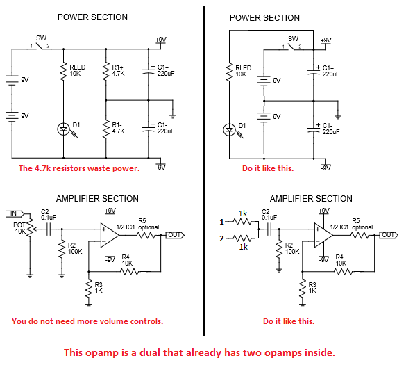

I need to mix 2 headphone audio outputs together to 1 headphone...but I need to lose as little fidelity as possible.
I need to mix audio that has hypnotic cues that are mixed into it with another source, and I am concerned with losing any fidelity that may effect these subliminal cues.
I dont need any level controls, as I can control the output of the 2 sources...so its just a simple, high-quality mix.

Are the two audio sources stereo (four total audio signals) or mono (two total audio signals)?
Two stereo output sources (four total audio signals) into one stereo destination: left1 + left2 = left-out, right1 + right2 = right-out ?
IF yes
AND IF you have extra volume available
THEN you can do this with four resistors, no active circuits of any kind.

I agree that resistors can simply do the mixing with no loss of fidelity but each signal level will be cut in half (-6dB) that is not much loss.
Use 1k resistors in series from each MP3 player and join them at the left mix-out and the right mix-out. For a headphones output the mix outs must feed a headphones amplifier.

-Is each resistor in series with each l&R output or or just 1 resistor on each Right output? In other words 2 resistors for each feed, or 1 resistor on each feed?
The illustration is backwards , as it was meant to multiply 1 input to several outs, Im looking for 2 ins and 1 out, but Im looking for the other way around. It basically shows my question of 2 resistors for each leg of each feed, except using 1k as you suggested

Google has some good and some bad circuits. Here is a very good old one that can use more modern opamps today: https://tangentsoft.net/audio/cmoy/
Audioguru...shows just ho little I know about amplifiers.
The schematic that you point to is really nice and easy. So if I required a stereo version, do I just use 2 circuits, common ground, with a dual audio taper pot?
Of course with the 1K resistors input that you suggested??
The OPA2132PA dual opamp costs a few bucks but is worth it.

If you look at that CMoy headphone amp, the design is asking that poor little op amp to directly drive a pair of headphones speaker (usually 32-64 ohm). Is that simply the best schematic you found with a quick google search, or, do you think it is a decent circuit?
The earbuds usually have an impedance of ~35Ω per ear, while the Sony headset is likely 8Ω per ear. It will be difficult to cover this with just a passive network of resistors...
It is too bad that the old Headwise website is gone since it specialized in headphones and their amplifiers. The article I posted with the Cmoy headphones amplifier says, "It’s powerful enough to drive very inefficient headphones to thunderous volumes from even weak sources, and it sounds excellent". The old opamp used has a max output current of 40mA.
The passive set of resistors are at the input of this amplifier, not the output. The optional series output resistor allows the opamp to produce more voltage swing while driving the low impedance headphones.
