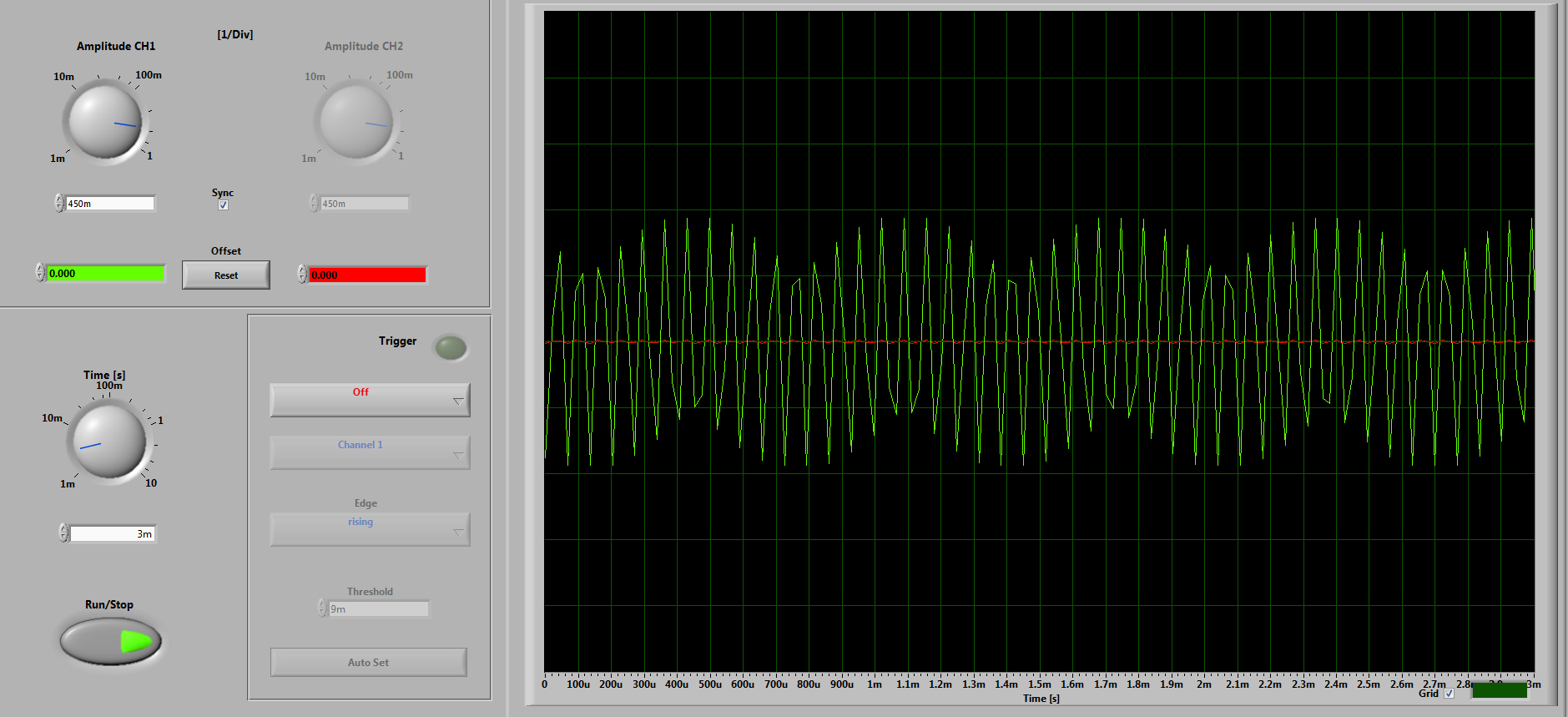

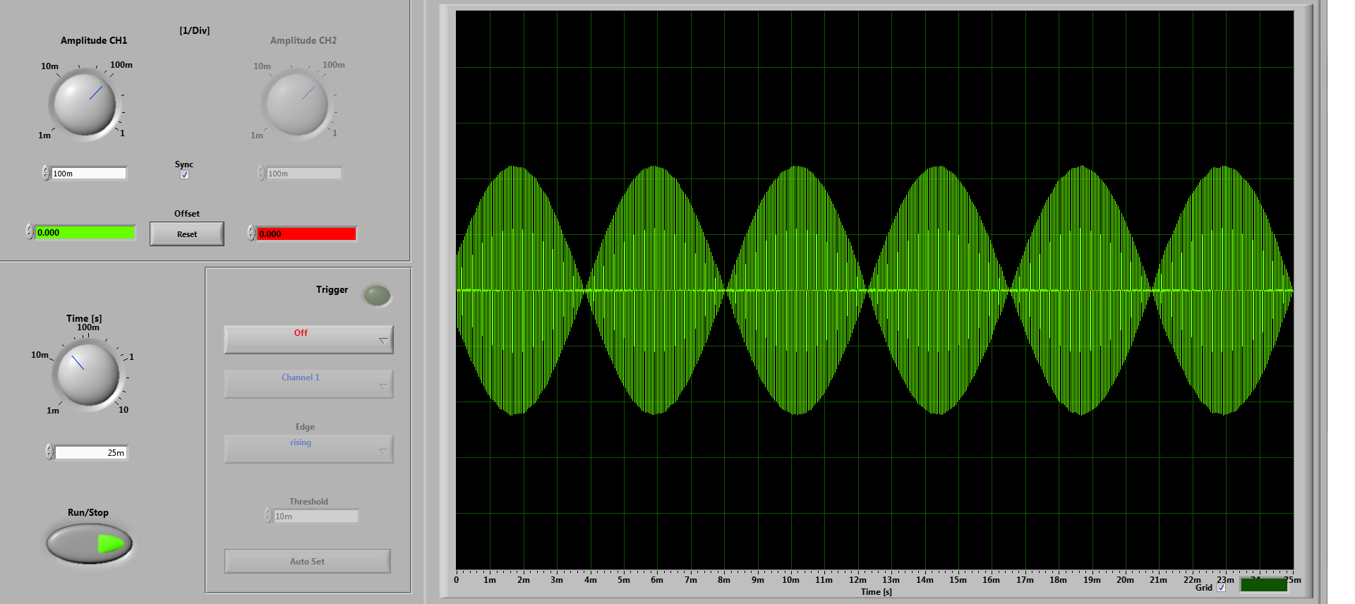

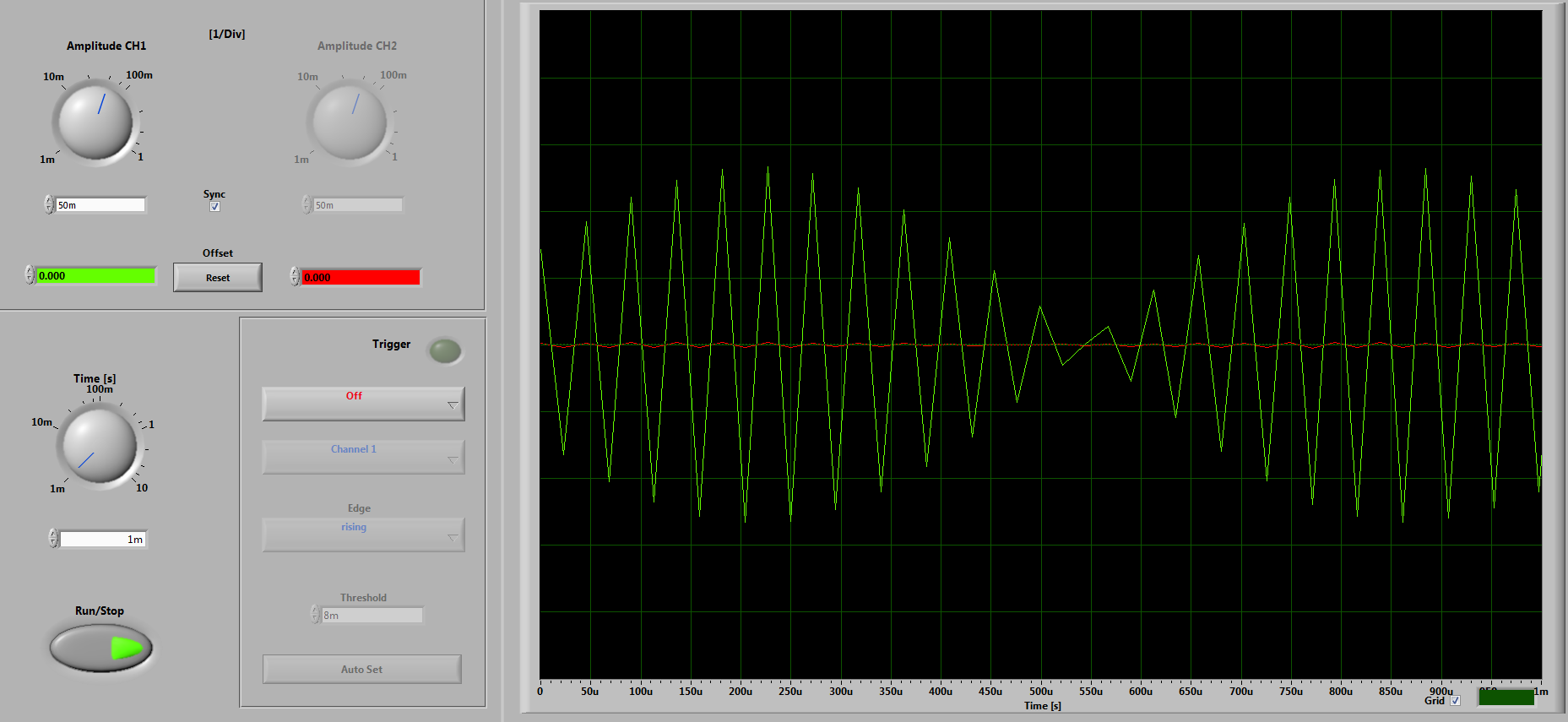

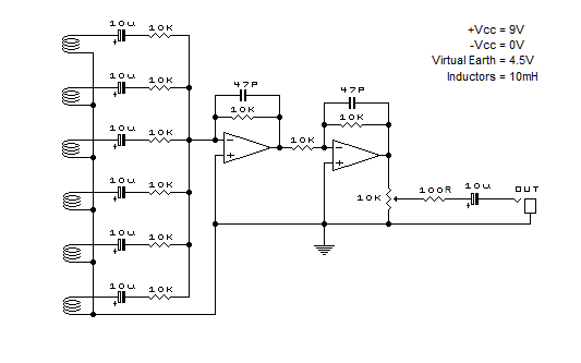

Built a summing mixer using LM358 op-amp at its heart (see attached cct diag) for an audio application. It works as expected until the volume is increased. At roughly half volume the circuit starts to oscillate with sawtooth waves that vary in amplitude in a sinusoidal fashion. Any ideas on what might cause it and what could be done to suppress it?
EDIT - the sawtooth wave that I previously mentioned could very well be a sine wave as my sampling rate is quite low

Do you have plenty of decoupling on the supply and bias divider?
And is the output well separated physically from the input?
The double inversion means the output is in phase with the input so any coupling between the two, even a current path in the output circuit shared with the input like a thin ground connection, could cause positive feedback.
Edit: The second opamp is unity gain; you could reconnect that as a non-inverting buffer; signal to + and link - to output.

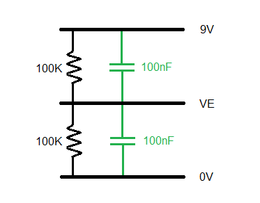

No, I have no decoupling. I omitted it as the power source is a battery.
However, on reading your post, that sounds like a script for an electronics horror movie. :/ Would the addition of caps (see diag) do the trick, or am I over-simplifying things?
PS. The second op-amp isn't really needed, it just puts everything back in phase. With a normal audio mixer this would be absolutely necessary, but since this application is self contained up to the output the second inverting amp can be done away with altogether.

Decoupling isn't optional, it's an absolutely vital part of almost every circuit - and particularly so when you're trying to generate a split supply from a single one.
You don't 'need' the two shown in your diagram (although the second won't do any harm), but you need one from centre to either of the main rails (and I'd prefer an electrolytic across it as well), and one across the main rails - also an electrolytic across the mains rails (say 100uF).

I'd put the caps separately between ground & power, and ground to VE.
And use both a small value film cap and a decent size electrolytic.

Well, the caps are in place as you both mentioned (VE to either rail & +Vcc to -Vcc). Just used closest values available from my little kit box
The result: noiseless beautiful volume that is usable from zero to maximum.
Many thanks. I really appreciate your help. And a lesson learned :)

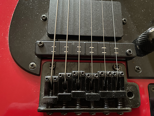

The application that I never mentioned? A new design of guitar pickups that I've been working on for quite a while now. The technology is nothing new, its the mechanical side of things and the ways that they can be used that are novel. A few more years of development left, but that's for the engineers. I'm just happy to have a working prototype of phase one of five. :)
A touch of deja vu there :)
This one is around 30 years old, though apparently yours is for a different function:

Most guitar pickups are designed to drive the 1M ohms input of a vacuum tube or Jfet, but your circuit has an input of only 10k ohms, 100 times less. It causes your output to have a very low level that has its high frequencies muffled.
The TL072 dual audio opamp has low noise, very low distortion and a wide frequency response and slew rate. An electric guitar probably needs to have these nasty sounds.

Early Roland synth-axe?
PS. The intonation on that guitar looks awful!!
Almost - Casio MG series.
And the intonation is perfect at that; note that I have tapewound strings on it.
I collect and repair / rebuild guitars as a hobby, though that is the only one I ever bought new.
