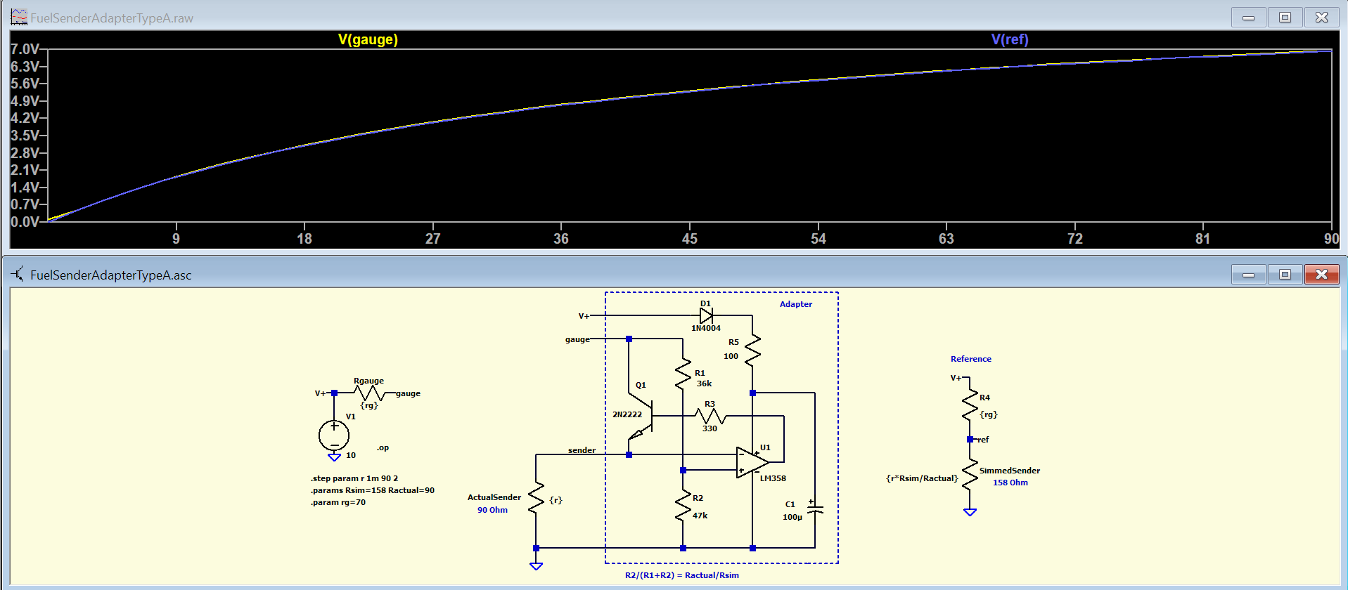

Try this, which makes a 0-90 Ohm sender look like a 0-158 Ohm sender :-
The circuit inside the rectangle is the adapter itself. The other components, and the attached asc file, are for simulation purposes only.
V+ is the supply voltage to the gauge (if at least 5V), or the car's Accessory (i.e switched 12V) supply.
R1 and R2 could be replaced by a 50k trimpot to allow adjustment of the adapter's resistance 'amplification factor'.
This circuit does not provide any 'anti-slosh' function, but could easily be modified to do so with the addition of a resistor and capacitor.
Edit:
To make the 0-90 Ohm sender look like a 16-158 Ohm sender instead, connect a 9.1 Ohm resistor in series with the sender input to Q1 emitter.
  • FuelSenderAdapterTypeA.asc
