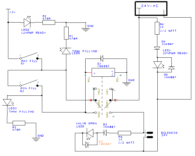

Automatic Water Level Controller for "Dr Fluffy Bottoms Quack House"

Ive updated the schematic to show the AC voltage and the LED connections
You don't need both D4 and D5.
D5 alone would be used to let the negative half of the AC past the LED to prevent the reverse voltage from destroying the LED. But D4 blocks any reverse voltage from getting to the LED, so there's no reverse current for D5 to carry.
Just use D4.
The same is true for D3 and D2.
I advised that setup.
The shunt diode protects the LED from any possible excess reverse voltage across it, due to the series diode & circuit capacitance and possible leakage. That's the more critical one for LED protection.
The series diode just halves the dissipation in the series resistor.
With "ideal" components only one should be needed, but there is no such thing in real-parts...
Just use D4.
Thank you but I have already sent this out for a 5 board build. It was only $6 but if there are any issues I'll apply your suggestions.
