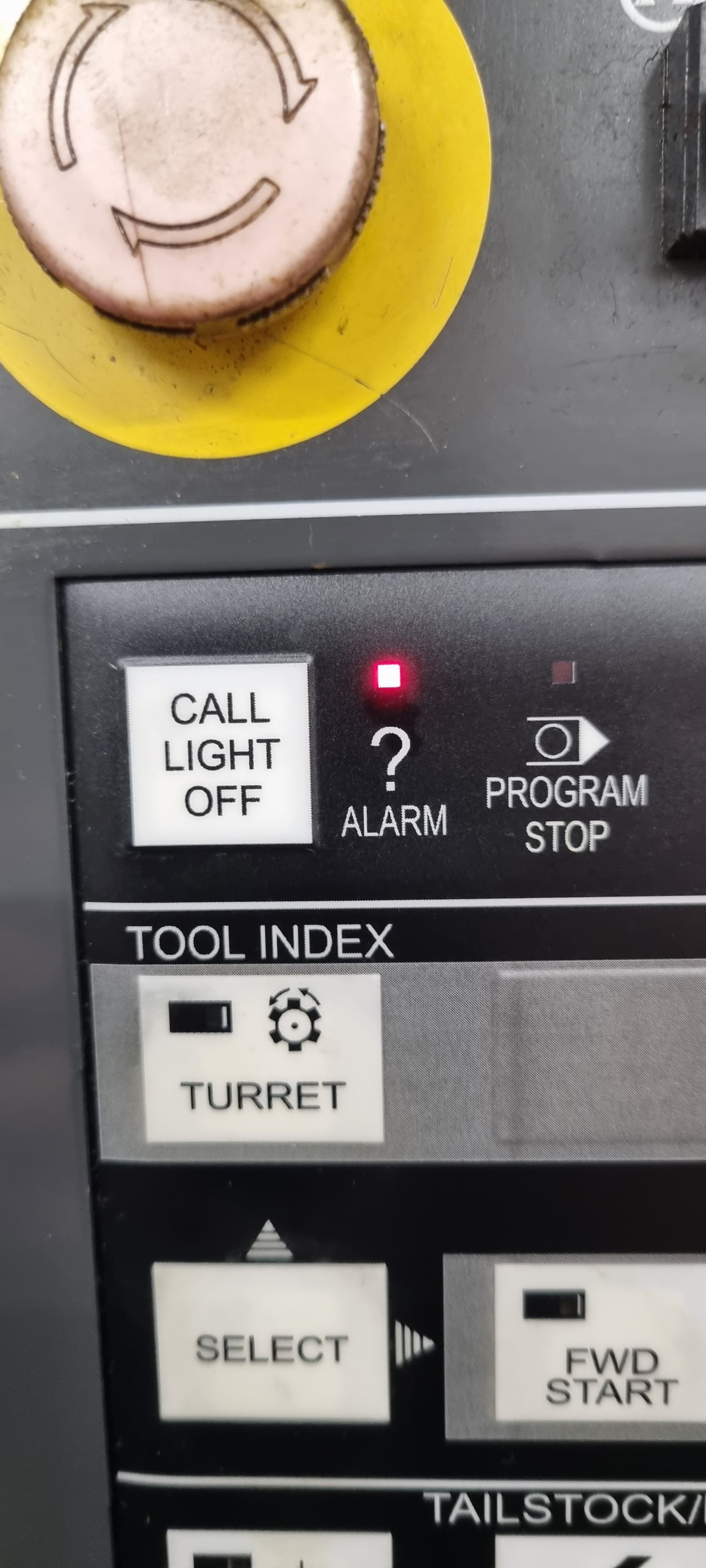

Hi. I need a device to fit over this led to activate a sounder so i know when this machine stops.
Prefer low voltage application maybe 9v Battery. I am happy to make from circuit design or offer a machining job in exchange for complete item. can make enclosure myself

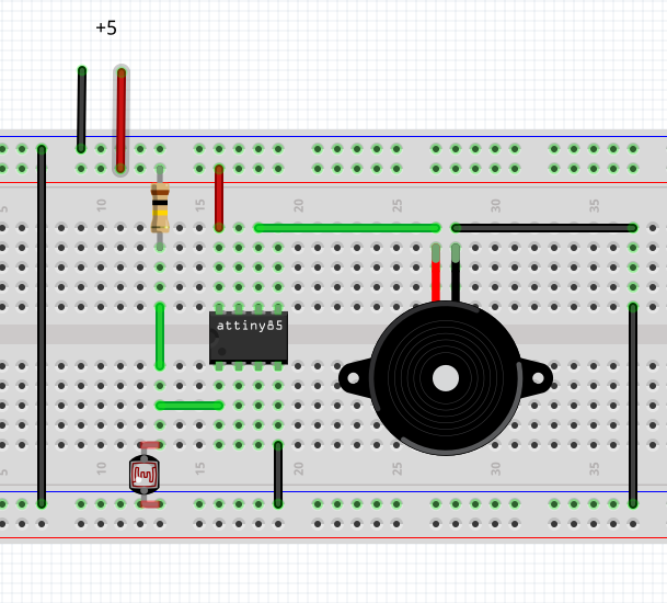

This is pretty straight forward, a photosensor on flying leads
to a small box with a ATTINY85 board + regulator + buzzer +
1 cap + battery + push button (unless machine turn off extinguishes
led).

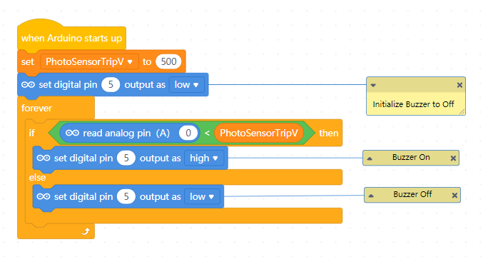

Basic code, use mBlock to generate code :
Note the photosensor is a classic : (connect that to gnd and in series with a R to Vdd, junction to
analog pin 0. R value 1/2 the range photocell experiences when LED off then on. Note you can also
get these in various packages, so look around for what best fits your need. You could also print
a 3D bracket to hold sensor. Lean toward sensor with lower R range values, say into the 1K to 10K
range, as that lowers the value of R needed, which makes the pin lower Z hence less subject to
stray pickup, eg. noise.
You will have to adjust PhotoSensorTripV to accommodate the R you use in the divider.
You do this prior to programming in mBlock. Or add a pot, read it on a second analog
pin, and use its value to set the trip V so you can adjust in circuit. Not I did not add code
for Hysteresis in mBlock to eliminate small variances and noise, that would be advisable.
The code mBlock produces from above to cut and paste in Arduino IDE :

Use a 5V piezo buzzer to connect to pin 5
Note I am showing use of dip package, but small board has regulator and bypass
cap for its ATTINY85.
