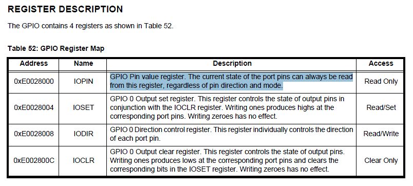

My issue is in ISIS i get errors and nothing on screen....
"Command Write attempted during reset. Write Operation Failed."
I'm not reading your code that closely, but if it's like the SAM7, I see two problems here. One is that the read register is totally different from the GPIO setting register. On the SAM7 it's called the Pin Data Status Register. You might want to look for the equivelant on the LPC. Also, if it's the same, the peripheral clock needs to be enabled in order to use inputs at all.
I think its just that one ... image below is more informational...

Ya, mine definitely works differently. I have an Output Data Status Register with what I'm currently telling it to output for the output lines, and a Pin Data Status Register with the input values.
I can see, I screwed up with one of your previous questions as well. Looks like you were asking about changing the data direction of a pin. I thought you meant setting the output on/off.

Ok i think i got it now lol i tried it on button and works nicely... First i was using char instead of long for a pin so causing a overflow type thing....
also i made a function to read a single pin... works nice i think...
