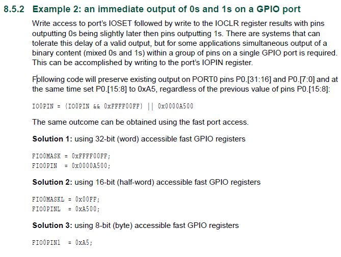

maybe you where talking about :
Write to the IOPIN register enables instantaneous output of a desired content on the
parallel GPIO. Binary data written into the IOPIN register will affect all output configured
pins of that parallel port: 0s in the IOPIN will produce low level pin outputs and 1s in IOPIN
will produce high level pin outputs. In order to change output of only a group of port’s pins,
application must logically AND readout from the IOPIN with mask containing 0s in bits
corresponding to pins that will be changed, and 1s for all others. Finally, this result has to
be logically ORred with the desired content and stored back into the IOPIN register.
Example 2 from above illustrates output of 0xA5 on PORT0 pins 15 to 8 while preserving
all other PORT0 output pins as they were before.
"That wont change the 0th pin."
you are right and i was wrong: it would set the 1st pin to 1 and do nothing to the 0th pin.

yeah so i was reading more and found out i can do this:
void ChangePortA(char port, unsigned char NewVal){
    if(port == 0)
        IO0PIN = (IO0PIN && 0xFFFFFF00 ) || NewVal;
    if(port == 1)
        IO0PIN = (IO0PIN && 0xFFFF00FF ) || NewVal;
    if(port == 2)
        IO0PIN = (IO0PIN && 0xFF00FFFF ) || NewVal;
    if(port == 3)
        IO0PIN = (IO0PIN && 0x00FFFFFF ) || NewVal;
And doing that i can split the port into 4...
Page 92 : "8.5.2 Example 2: an immediate output of 0s and 1s on a GPIO port"
LPC214x manual

I can also just do this for faster:
void ChangePortA(char port, unsigned long NewVal){
    if(port == 0){
        FIO0MASK = 0xFFFFFF00;
        FIO0PIN = NewVal;
    if(port == 1){
       FIO0MASK = 0xFFFF00FF;
       FIO0PIN = (NewVal << 8);
    if(port == 2){
       FIO0MASK = 0xFF00FFFF;
       FIO0PIN = (NewVal << 16);
    if(port == 3){
       FIO0MASK = 0x00FFFFFF;
       FIO0PIN = (NewVal << 24);
clipboard02-jpg.30661
