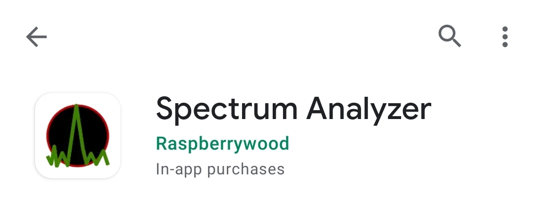

Is there an application for an Android phone you may suggest that can tell by sound the frequency Hz (cycles per second) of a noise ? Would like to find the RPS (Hertz) or RPM (multiplying by 60) of an air compressor.
Seen several applications listed but none convincing; seem more automotive oriented, with selection of 4,6,8 cylinders, 2, 4 strokes...
There are many "guitar tuner" type apps, that will display the frequency of a tone.
The limitation may be the low frequency response of the phone mic..
This one for Android is decent.
