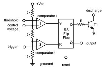

The 555 is basically two comparators and an SR latch. The output toggles low when the high threshold input is reached, and high when the input drops below the low threshold.
The charge/discharge time to reach the high or low thresholds is totally dependant on the external components.
The only internal "variable" is by changing the bias voltage on the resistor divider that the comparators use for the thresholds; the upper comparator point in the divider is brought out on pin 5.
That allows some change in frequency but at a guess possibly 4:1 or so, not 1000:1
The control voltage is not linear.
555 internal schematic:

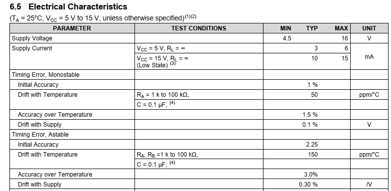

As in the part I highlighted, you suggested the 555 was a 'stable' chip - I'm fully aware of the AD9850, and have a few of them.
The 555 is plenty stable enough for many thousands of products you can find them in - even recently designed products like our little coffee grinder.
On the other hand, some simple crystal- controlled circuits are not nearly stable enough in some projects and additional steps need to be taken.
As I said above, stable is a vague specification and we need a more clearly defined specification from the OP - it's his project, his budget and his failure to accept.
