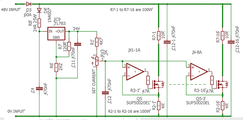

Anyone have a schematic for a Constant Current DC load tester?

Could you suggest a single cut-off voltage that could be reasonably used for all LABs, or do you see a manually adjustable cut off voltage as the answer.
I suppose you could implement a universal cut of voltage of around 10.75V at any current which would at least be better than nothing.
spec
The electronic load that I use for testing batteries has a programmed function for that purpose. I set the discharge current and the stop voltage and let it go. I'd choose the current to match what my intended load is, and choose the cutoff voltage by going to the datasheet for the battery that I'm testing and seeing what the manufacturer recommends for THAT battery at my chosen load current.

The cutoff voltage, if any, really needs to come from you. And may need to be based not only on what the manufacturers recommended cutoff voltage is, but what is the pass/fail criteria for your test? Also, does the test only need to match a single operating condition, or does it need to encompass over, under or fault conditions?
Ah, right. So you are describing a constant current load that has adjustable current and an adjustable cut off voltage. That makes sense and should be reasonably straight forward to do.

Here is a rough draft schematic of the linear constant current load (version 4):
POST ISSUE 05 of 2016_10_17
ERRATA
(1) Q5 should read Q5-1. Q5-3 should read Q5-16
(2) All opamps should be shown as type LM358 (may be changed to type, OPA2192)
(3) All opamp Vee pins should connect to 0V. All opamp Vcc pins should connect to the 24 V line.
(4) N-8A should read N1-8B (N1-8B pin numbering is incorrect)
(5) C4 lower should connect directly to R6 lower
(6) All 8 opamp packs should have a 100nf disk ceramic capacitor connected directly between their Vee and Vcc pins.
(7) Connect a 1N4007 diode, cathode to three terminal regulator (TTR) input and anode to TTR output (to protect TTR from reverse voltage)
(8) Remove D4 and replace with a trace. D4 not necessary.
(9) Provide gate voltage protection: to be defined (thanks Ron Simpson)
(10) Redraw schematic to show 0V star point (thanks ChrisP58)
(11) Redraw schematic to show 48V star point (thanks ChrisP58)
(12) R7-1 thru R7-6 should read 8R not 10R (typo)

I would add like a 2k resistor to the negative input of the op amp. Then a small cap from the op amp output to the negative input. I used spice to get a damped response to a step input.
Hi Ron,
Thanks for suggestion.
I see you are considering the open loop response of the opamps and NMOSFETs.
My plan in that respect is to use the considerable effective input capacitance of the NMOSFETS and the series resistors in the opamp outputs to form a dominant pole for single unit slope roll off. I suspect that introducing another pole will reduce the loop stability by adding more phase lag.
The opamp will be rolling off at unit slope from a low frequency too, so this aspect needs a bit of analysis. It may be better to use an opamp with a higher break point, like the OPA197/OPA192.
