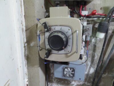

Right now I am using a variac into a rectifier to adjust the voltage and limit the 120V max current to 22A with low battery. But as the battery voltage increases the generator current drops and I am not using it's full capacity.
So I rigged up a small motor and a current-sensor which drives the variac up or down to stay at 22A. On start up of the generator the variac starts at 0 until the current goes over 22A. Shutting down the variac returns to 0. This actually works well except I have about 200W to 300W transformer losses and it is a mechanical contraption.

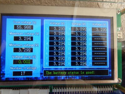

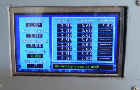

My battery is 1200AH, 50+KW, I have a balancer which keeps the cells within 0.003 to 0.002V, the charge current from a 2200W generator is very low for a 1200AH battery (+-40A) , my inverter is set at 70A max charge current, lifepo4 batteries don't burn.
