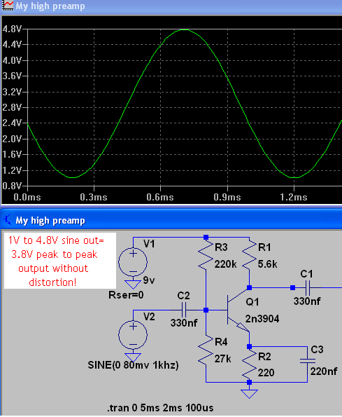

There is a FM transmitter with 2n3904. On its preamp it has a voltage devider Positive R=1M, Negative R=100k and emitter R=100 ohms (without bypassed capacitor). Audio coupler is 100nf. Other are same like mod-4.
I think it's too bad because there is no output waveform on simulation. What is that? Cut-off or saturation?

The transistor is cutoff so its collector voltage is at the supply voltage. It did not have a voltage regulator so the transistor worked fine when the battery voltage was a little low then the transistor became saturated when the battery voltage dropped more.
Since the biasing resistor values are very high then if the current gain of the transistor is not maximum then it will be cutoff more.
Your preamp has almost 3V peak to peak audio output. Then Tx transmits little (almost 5-7%) small sound than high quality FM station which has Audio Processor.
I biased differently for 48uS pre-emphasis with 9V and it has 3.8V peak to peak output (higher than Mod-4). Will it transmits little louder than before? (because it has high peak to peak) tell me simply.

Pre-emphasis at high audio frequencies is a boost of more than 12dB (4 times) so the preamp cannot have a high input level but your SIM has an extremely high input level.
Our hearing's sensitivity is logarithmic so we can hear a nearby jet airplane and also hear a distant whisper. The difference between 3V and 3.8V will not be heard.
3dB is 1.4 times higher and it will sound only a little louder. 12dB is 4 times higher and will sound about twice as loud.

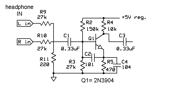

I tested loudness of audio from mp3 (not mic) and compared with FM station and got little small sound than FM station. And guessed that high peak to peak might produce little loudness :)
The loud output level of an MP3 line output is about 270mV RMS which is 0.76V p-p. If it is attenuated with 27k to 1k then the level to the mic preamp is 9.6mV RMS which is loud, about the same as a loud sound from an FM radio station.
Maybe you used the headphones output of the MP3 player that has its level reduced so it does not blow your ears off. Then change the attenuator.
Yes, I used my cell phones's output from 3.5mm jack (used for headphones). My attenuator is 27k+27k+220R because 1K produce distortion (because I have 150k+27k devider). If I set the volume on cell phone to 90% it will not produce distortion, and it is transmitted 5% small than FM station. If I increase the volume higher than 90% it starts to distort. (so I used 220R attenuator by testing various resistors). That is why I am unable to increase its loudness. (I think I need audio processor to compete with stations :) )
An audio processor for a radio station is simply an automatic volume control that makes low level sounds louder and makes high level sounds compressed. Then every sound is loud.
Your SIM does not have a 150k/27k divider and it does not have a regulated 5V supply so of course the circuit causes distortion.
It is my preamp.

Your preamp should work fine if the 220 ohm resistor in the attenuator is suitable for the level from the headphones output of your MP3 player.
I thought that 3.5mm headphones jack are equal to Mp3 Line Out :) . Seems I was wrong! Isn't it?
Line level out of any equip is a fixed value, not user adjustable
headphone/speaker output ( from any piece of gear) is variable using the volume control ... ergo, its NOT classed as line level
