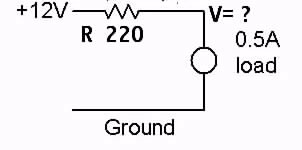

I know each basic electrical formulas but I couldn't apply it :( . Your few calculation inpired me lot. Can you calculate the value and its watt of this resistor?
- and how to calculate output voltage if I ised 220 ohms resistor there? Idea needed please!

A resistor does not regulate the output voltage. If the current changes then the output voltage also changes. You should use a 7805 voltage regulator IC instead of the resistor.
Ohm's Law says that the resistance is the voltage across it divided by the current.
12V - 5V= 7V across the resistor. The resistance is 7V/0.5A= 14 ohms which is not a standard resistor value.
The power dissipated by the resistor is simply the voltage across it times the current. 7V x 0.5A= 3.5W. A 5W resistor will get fairly hot.
If you use a 220 ohm resistor and it has a current of 0.5A then it must have a high voltage across it.

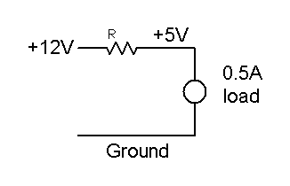

Hahaha laughing at me because I am being puzzeled :| ! Look my attach and check my silly Voltage calculation:
V= RxI= 220Ω X 0.5A= 110V :p
I think I invented step-up transformer using Ohm's Law!

If your load is SHORTED then Ohm's Law says that the current is 12V/220 ohms= only 54.6mA which is MUCH LESS that the 0.5A that you need.
If the load voltage is 5V then Ohm's Law says that the current is (12V - 7V)/220 ohms= only 31.8mA.
See, calculations are simple!

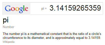

And may I know what is 'pi' and its value while calculating? Please
You can find the value of pi in Google.
Pi is always used to calculate the cutoff frequency of a highpass or lowpass RC filter.
I have not used the accurate number for pi for many years because the formula is always 1 divided by (2 x pi x RC) so 1 divided by (2 x pi) is almost simply 0.16.
Accurately, 1 divided by (2 x 3.14159 x 330nF x 10k)= 48.2Hz.
But 0.16 divided by (330nF x 10k)= 48.5Hz which is very close (less than 1% higher).
I corrected the error I made in my previous post.

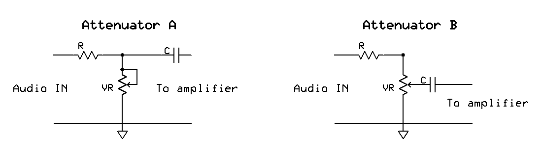

Your audio attenuator (27K+1K) taught me lot actually! From 2 days I am modifying my ancient :) VCD Player. It has lost its remote control functionality so sound of its internal amplifier was horriable high. I found amplifier's input point and set 2 Potentiometer as a gain controller for L and R. Thus I made volume controller. There I found two type of attenuator stage for FM (attenuator B) and for MP3 (attenuator A), look at schematic. What is the difference and its difference application among them?
Another, I found a sentence- "our ears perceive sound in a logarithmic fashion." Also you said about this once. What they mean? Can you say about it in simple please! Can't we compare our hearing with Microphone's hearing?

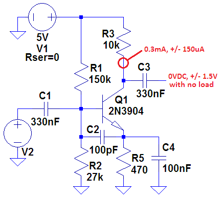

1) My Mod4 circuit has a 330nF coupling capacitor from the electret mic to the input of the preamp transistor:
The preamp transistor operates at a collector current of 0.28mA and the datasheet for the 2N3904 has a graph showing its typical current gain at that current is 100 and another graph shows its base-emitter input impedance is 11k ohms. Then the transistor's current gain times the emitter resistor value of 470 ohms is 47k. The total input resistance of the preamp transistor is 11k + 47k= 58k ohms.
The 160k and 30k biasing resistors for the preamp transistor are effectively in parallel with a total of 25.3k which is parallel to the 58k of the transistor for a total of 17.6k.
The electret mic and the 10k resistor powering it is about 2.7k in series with the coupling capacitor so the total resistance is 17.6k + 2.7k= 20.3k.
Then the cutoff frequency is 24Hz.
2) The output of the preamp transistor has an impedance of about 10k ohms and its 330nF coupling capacitor feeds the oscillator transistor that also has an input impedance. This forms another highpass filter that combines with the first filter causing the output to be -6dB at the combined frequency. Then the -3dB cutoff frequency of the entire circuit is higher than 24Hz and might be 35Hz.
Attenuator A shorts the signal which might overload the signal source. Attenuator B is a volume control.

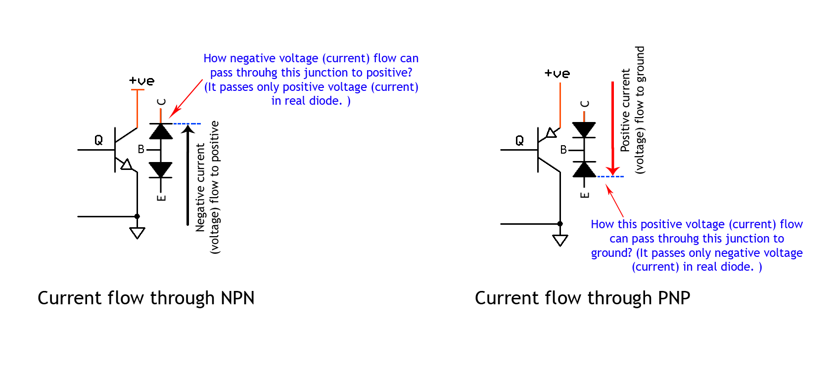

I know the main current flow (as a signal) through transistor is EC or CE (totally at saturated mood) but how this happens, look my attach please!
I would be so happy if you clear me about such operation of transistor and its current flow! I searched lot and found also lot but could not able to make concept about this by reading their deep explanation. :| So, in simple please!
(on attachment, mistakenly I wrote EBC for diode view of PNP. Please read it correctly- CBE)

:( I know I cannot make transistor with two diodes. Because middle part of two diodes (junction) has been combined very critically on transistor.
( It is little hard to visualize like- existence of 'impedance' on non inductor circuit :( )

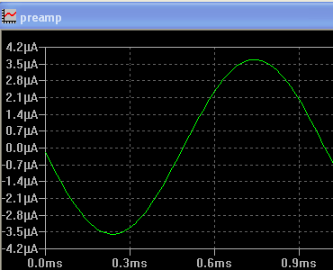

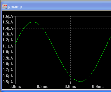

There is 150uA and 450uA peak to peak wave form for I(c) and there is 300uA is mid point, so you called Collector current of preamp has 300uA (which is mid-point) for simple.
I got a wave form which has 0.5uA to 1.5uA peak to peak and I also called "it has 1uA" (mid-point) for simple.
But look at one of my attachment, it has -3.5uA and +3.5uA peak to peak waveform and its mid-point is Zero! I am being fool, is it 0.0uA (no current conducting)? :)
A coupling capacitor passes AC but blocks DC then the output of the coupling capacitor with no load is 0VDC and its voltage swings positive and negative.
