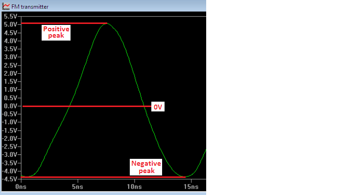

Did you mean that your sinewave has 2 peaks- Positive 5.1V and Negative -4.4V? So due to this two peak voltages you multiplied 1.414 x 2? But all AC has negative and positive peaks......um....
Can you say in basic please!
Look at my simulation where it shows a positive peak of +5.1V and a negative peak of -4.4V. They are different due to distortion. Their total is 9.5V.
Each of the two peaks has an RMS voltage that is the peak divided by 1.414 so both have an average RMS voltage that is the total divided by 2.828.

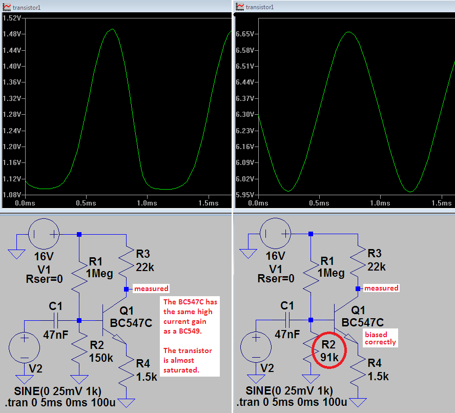

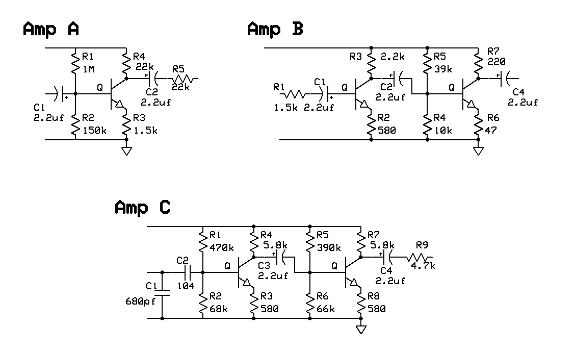

I found these different audio pre amps on professional Cassette player amplifier. All transistors are BC549. May be voltage is +12 (I didn't see the circuit's supply), there is a 12-0-12 Volt output transformer so. I found the polarity of polarized capacitor has been ignored.
There are very diffferent amp bias on same transistor, for why? May be for different gain.
This type of VERY different rang of bias is possible due to large range of hFE of BC549 or what? Can we do with 2N3904?
A 12V transformer produces a rectified and filtered 16V supply.
The Amp A circuit has the transistor biased wrong for a 16V supply. It is almost saturated. I changed R2 to 91k and it works.
Maybe the original circuit used a +6V supply.
The Amp B circuit has the first transistor with no bias voltage so it will not work.
The Amp C circuit has the two transistors biased differently and I do not know why.

A 12V transformer is 12VAC RMS. Its peak voltage is 1.414 times higher at 17V.
The rectifier drops about 1V and the main filter capacitor will be at about +16V.

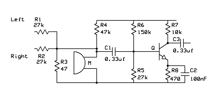

When I biased Mod 4's preamp using 150K and 27K voltage devider, its starts to distort (too high amplify) so I used 47K for mic bias and only 47 on attanuator. Even got little (but fine) distortion if I talked near of mic (near from half meter). Is it ok as your calculation?
[Don't be confuse on schematic: I used the attnuator and the mic separately, not together like on the attached schematic. While using attenuator I removed 47K and Mic. While using Mic I removed attenuator network (123 resistors)]

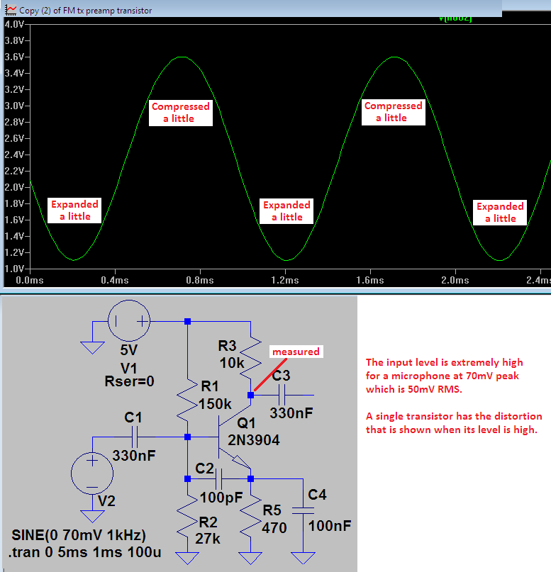

Your mic preamp does not have a supply voltage. It MUST be +5.0V.
The mic will distort at high sound levels when its current is too low. 47k to bias it is too high a resistor value.
10mV RMS is a loud signal from an electret mic. I simulated the circuit with an input that is 50mV RMS and it shows normal single transistor distortion when the level is this high:

But I used 10k mic resistor and got more high level distortion and used 22k but also got distortion, and used 33k but also got little distortion, and lastly use 47k, then got very little distortion. :) so guessed if I used 56K, may be distortion would be zero :)

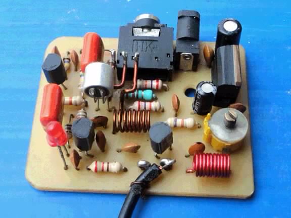

And now I completed by making Mod-4. Layout design was attached before few page designed with ExpressPCB. I got success without any mistake and now transmitting at 93.6 MHz. There is no difference between listening song directly from MP3 player and listening same song through the FM transmitter. Quality is 98% if MP3 has 100%! Wow! Almost no one can differ this 2%.
So quality of this Tx amazed me again! As a whole there is no difference between MP3 player and FM transmitter in quality (rest of stereo). It has really empty carrier noise! Wow!
I added a power indicator LED, look at picture. How might be the average current consumption of the LED at 5V with 680 ohms resistor?
Your pcb is nice and compact.
I notice a huge 1A regulator instead of a little 100mA one.
The current in an LED is determined by Ohms Law, the supply voltage and the resistor value.
A red LED is 1.8V to 2.0V. With a 9V supply, the 680 ohm resistor has 7.1V across it so its (and the LED's) current is 7V/680 ohms= 10.4mA. The current drops as the battery voltage runs down.

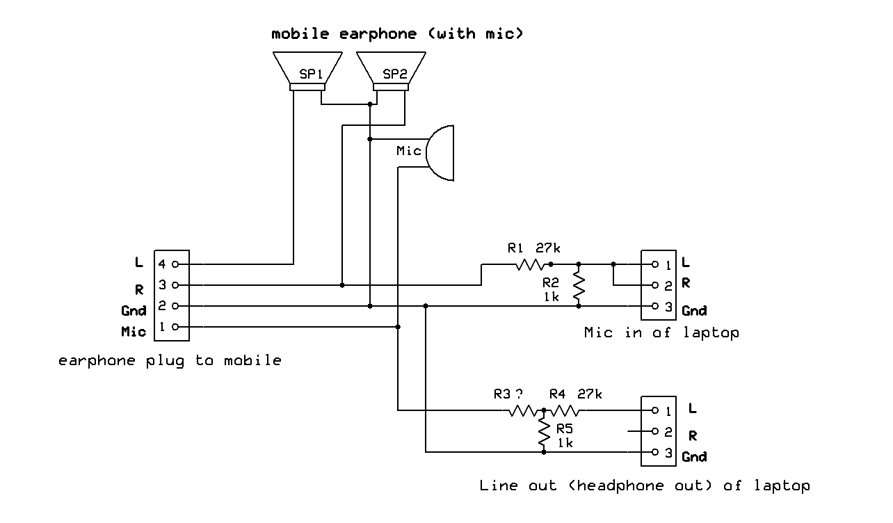

Here is a small problem!
I want to connect my cell phone's audio and Mic to PC using earphone of cell phone (earphone has 2 small speakers and an electret Mic). First, I connected directly 'audio out' (cell phone) to 'Mic in' (PC) and Line out to Mic, but it was noisy. I think I feed high level audio to low level Mic so it was distortion, isn't it? So I need attenuator.
- I used 1st attenuator to attenuate the audio signal of cell phone's Audio (R Gnd) to feed the Mic in of PC. Hoping that audio level on earphone speaker will not be attenuated (?). Resistors' values are just guessed :)
- I am confused on 2nd attenuator because I have to attenuate ONLY the signal of 'Line out' of PC to feed the 'Mic in' of cell phone. But If I simply added an attenuator then the attenuator ALSO attenuates the signal of electret Mic of earphone and it is not good I think. Then how to add attenuator here?
Help me including all approx values of resistors please!
