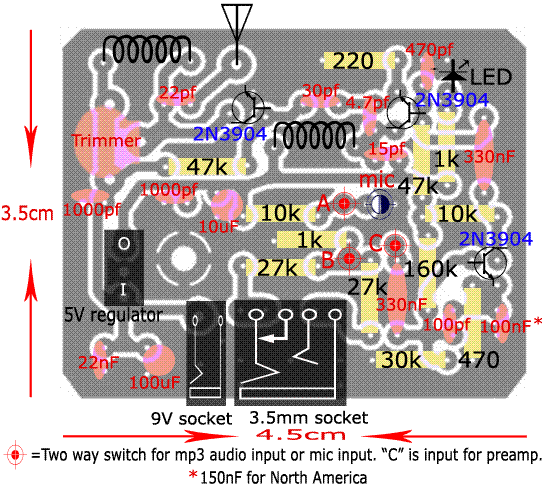

And now I designed perfect smaller Layout for Mod-4. Perfect for VHF circuit i think :) . There was 100th of 90 degree angles on my previous design which might be very bad for VHF band because they may act as a capacitor. Now there are no 90 degree angle. I kept enough ground plane which is good (I think) for VHF board.
I included both input option- mp3 audio from 3.5mm jack socket and mic audio from mic. And used Two-way switch for these two input. I added a LED as power indicator. I used fixed capacitor as a 1st tank bacause here most of frequencies are blank so lots of space I can use by changing fix capacitor so fine tune from trimmer is not necessary :) .
I almost finished by making the board by toner transfer method and also finished by soldering too. When totally completed, I will post the photo. Wow my work! :)
Designed from ExpressPCB.

Your pcb looks good.
I think it is dangerous to have 9V on a plug because if it easily gets shorted when it is not used then the battery might explode or be wasted. A battery or power supply should have a jack, not a plug. The circuit should have a plug, not a jack.
Yes, I understand! In electronics, smaller mistake leads to dangerous (huge) problem. I used Plugs for audio and battery (both) on my previous design but due to these wires it looks like hard to carry in pocket :) So in this design I used both jack sockets to make best portable and good to see. There is no power switch so I will unplug the battery while not transmitting :) .

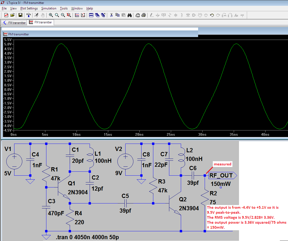

I tweaked a few capacitor values for maximum output power in the simulation.
The output power is explained.
Oh yes, I think it means- peak to peak 9.5V AC is equal to 3.36V (RMS) DC. :)
But i got failed on calculation... What is 2.828 and how it came please?
The peak voltage of a sinewave is 1.414 times the RMS voltage.
A distorted sinewave sometimes has half of it larger than the other half (mine has -4.4V and +5.1V) so the peak-to-peak voltage is more accurate than one peak voltage.
Then the peak-to-peak voltage is 2 x 1.414= 2.828 times the RMS voltage.
Then the RMS voltage is the peak-to-peak voltage divided by 2.828.

- The RMS voltage is 9.5/2.828=3.36. The output Power is 3.36V squared/75 ohms= 150mW
A distorted sinewave sometimes has half of it larger than the other half (mine has -4.4V and 5.1V) so the peak-to-peak voltage is more accurate than one peak voltage.
Did you mean that your sinewave has 2 peaks- Positive 5.1V and Negative -4.4V? So due to this two peak voltages you multiplied 1.414 x 2? But all AC has negative and positive peaks......um....
