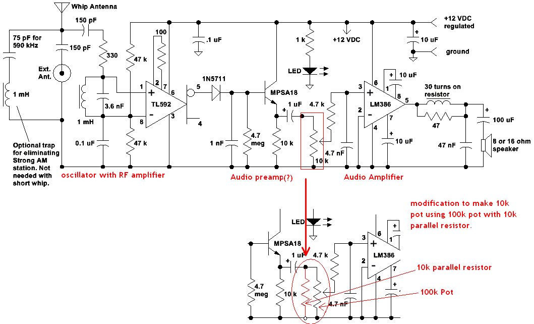

I made this Lightning detector VERY carefully on quality PCB but I am not able to detect any sounds from lightning. Audio output amplifier (around IC) is fine. I had used 100k Pot instead of 10k on BS170 (pre-amp). Would it be the reason? If it is the reason I will add a 10k resistor with 100k pot to make 'poor man's 10k Pot'. Check this please! See this attach (for additional- go to this original link of project: http://www.techlib.com/electronics/spherics.htm )

are you getting any sound from it at all ? say a steady hiss ?
if no audio at all, you need to check the audio amplifier stage for a start...
feed a low level tone from an audio generator into pin 3 of the LM386 ... sound out of the speaker Yes ? No ?
if no then look for a wiring fault arouond the LM386 and out to the speaker
with lightning all you will get is a static crash, and you can pick that up with any radio receiver

I tested Amplifier stage of LM386 it is good! I played a song feeding low level audio at the positive (signal) side of potentiometer and speaker is playing loud audio, it's working VERY well!
Cannot understand about 'static crash'. OK then problem may exist on previous stage (detector)?
I tested Amplifier stage of LM386 it is good! I played a song feeding small audio at the positive (signal) side of potentiometer and its working VERY well!
OK thats great ... but you didnt comment as if there was any static hiss coming out of speaker when trying to use the receiver
Cannot understand your two words 'static crash'. Did you mean problem may exist on previous stage (Oscillator)?

OK that transistor is being usd as an audio amplifier, you could try a VERY small signal on the base of that transistor ... that is, between the detector diode and the transistor base to make sure the transistor is amplifying :)
Dave
Of course the very old lightning detector circuit does not work because you replaced its very high current gain MPSA18 bipolar transistor with a BS170 Mosfet that is completely different. It might work with an N-channel Jfet since it is simply a follower with no voltage gain.
Where did you find a very old TL592 video amp IC that is only available in a surface-mount package today?
There is no oscillator. It is simply a tuned RF amplifier with an AM detector.

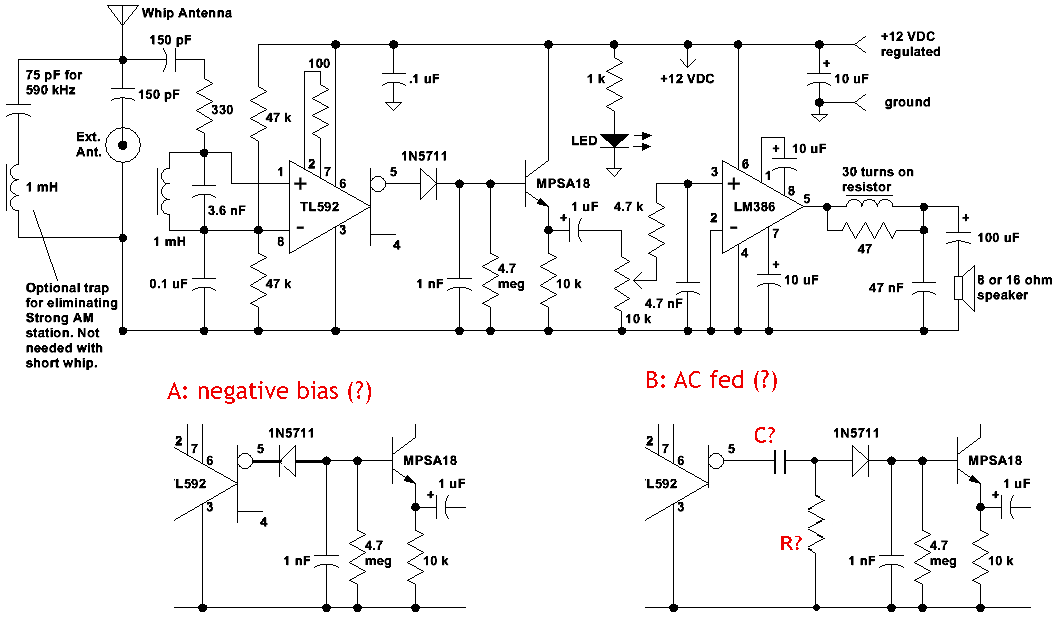

Ops! Sorry! It's my writing mistake! I used MPSA18 (not BS170). I just changed a Pot. Because I didn't have 10k Pot for PCB suitable so I used 100k Pot. I have 3 pieces of TL592 in through hole package. The author of this circuit is Charlese Wenzel form Austin, Texas. He sent me all these needed semiconductors (as a gift :) ). I guessed some semiconductors from USA, but TL592P is marked as TAIWAN. Why USA imports Taiwan products? Wenzel made this device with these semiconductor (look a link I provided befor) so I think semiconductors are fine.
I will test injecting very low sound in Base of MPSA18. If cannot detect lightning then will check tuner's and RF amp's wiring.
...might not work because detector diode is biased positive (>) ...
Then should I have to test once with negative bias (<) (negative half cycles out?) ?
The AM detector diode is doing almost nothing because it has a continuous DC bias voltage from the output of the TL592 video amp.
It will detect the AM from lightning much better if it is used as an envelope detector (AM rectifier) and is fed AC instead of DC. Then it needs a resistor to ground at its anode and is fed through a coupling capacitor.

Here mod A or B? Or both?

OH GOD!!! HOW FOOL I AM!!!!
I made this circuit almost 5 months ago and it was not working. I spent almost 10 days to design its layout on rough note, to design layout on computer, to make PCB, to drill and to solder. I had downloaded all needed datasheet too. I was VERY careful to make better circuit like professional! But today I found that I soldered MPSA18 in worng way!!! Wufff!!!! How non-sence I am!!! What happens to MPAS18 if I fed 12V to its base, emitter is same as emitter and collector is Audio IN (my worng connection), on this circuit? Is it damaged? If it is, I will change another MPSA18.
However I want to modify for better AM detection as you said before. Look at my previous post and suggest me please!

12V on the base and a 10k resistor to ground on the emitter results in a forward-biased base-emitter junction with only 0.13mA of current which will not harm the transistor.
I think the original circuit uses the forward-biased diode as a peak detector since it feeds the 1nF filter capacitor and a very high resistance.
It should be obvious that your circuit "A" has the diode always reverse-biased so it will never do anything.
