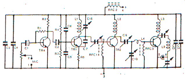

This looked like a nice transmitter to build when I came across it on the web. But only later did I see it uses a negative -3 V power supply, and a hard-to-get ferrite core coil.
All I want to know is how to create a +4 and a -3 v supply that I can use, and how could I substitute the ferrite beads with 6 holes.

Nigel goodwyn, are you saying that the bottom rail is in fact ground, and that "line" 4 goes to an unknown + voltage that is not given on the schematic?
If so, that solves the supply V problem.
Yes, the diagram makes no claim that those are voltages (and would make no sense if they were), they are obviously simple pin numbers for connecting off the board
The extremely old circuit is a Smartkit from Greece and is posted at Electronics-Lab 4 Watt FM Transmitter
Its single-polarity supply is 12V to 18V.
It is designed to use a very old "crystalic microphone" and needs a modification to use a modern electret mic.
It does not have pre-emphasis like all FM radio stations have so it will sound muffled without high audio frequencies on any FM radio.
