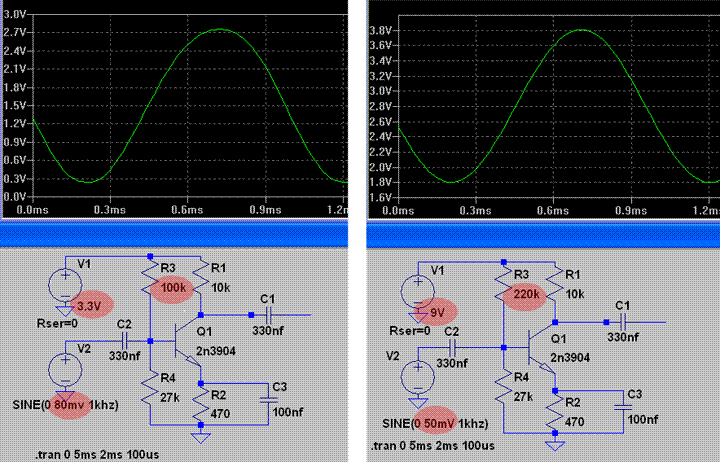

I did little experiment with the pre-amp applying different voltages. Is it valid?
I found audio source (mV) is directly related to bias factor. Is it determined by a resistor for electret mic (gain controller)? Or by attenuator (audio to ground) resistor while injecting line out audio? I used 50mV to 9V. Check the amplitude, which is the best peak to peak and which level starts to distort audio?

=Willen;1118323]I did little experiment with the pre-amp applying different voltages. Is it valid?
Pre-emphasis boosts high frequencies. Distortion is high frequencies so distortion is also boosted by pre-emphasis.
A transistor without negative feedback produced by an unbypassed emitter resistor has high distortion when its output voltage swing nears the positive supply. The voltage input change causes an exponential (instead of linear) voltage output change. Then a higher supply voltage allows the transistor to produce less distortion.
I never tried Collin's (Talking Electronics) very high value resistor to power an electret mic and attenuate it. Instead I use the datasheet value of 10k for a 9V supply so the current is the rated 0.5mA, the DC voltage is the correct at 5V and it is sensitive. I think Collin's very high value resistor causes distortion.
You do not want powering a mic to attenuate the signal because then the preamp must have extra voltage gain which also produces extra distortion.
Instead you want the mic preamp to amplify the low level from the mic with low distortion. The distortion Is less when the supply voltage is high.

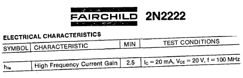

2n2222 is so old that I could not find a datasheet listing its fT, its minimum gain at 100MHz is only 2.5dB. None of them is a good RF amplifier at 100MHz.

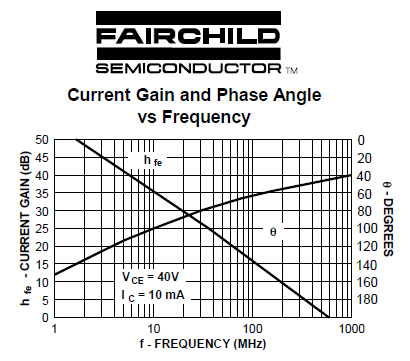

How you said exactly 2n2222 has 2.5dB at 100MHz? I cannot find exactly in datasheet, are there any graph of 'fT vs. gain'? Show me an example to find the gain at 100MHz of 2n3904 please!

Fairchild's datasheet of the 2N2222 is very old.
I like Fairchild's datasheet of the 2N3904 because it has a graph of typical input impedance at 1kHz and it has a graph of typical current gain in dB's at 100MHz.
I was wrong. The maximum current gain for the 2N2222 at 100MHz is 2.5 times, not 2.5dB.
2.5 times is about 8dB so the 2N3904 with a typical gain of 15dB is much better.
This is current gain, not voltage gain.

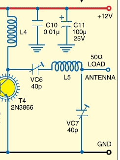

The high impedance collector of the RF transistor should have a pi filter (a C to ground, a series L and another C to ground) then connect the low impedance antenna.
Here are different types of impedance matching network than you said. Is it valid type of network or fault?

The collector coil needs to have a parallel capacitor to tune it. Then harmonics are reduced and the collector voltage can swing to double the power supply voltage.
In Google, I searched for Antenna Matching Circuit Design and found an article that describes how to match a high power low impedance transmitter (10 ohms) to a 50 ohm antenna which is backwards for our little low power transmitters with a high impedance collector.
