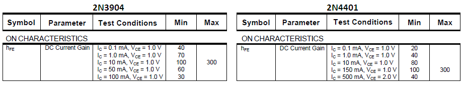

In Mod 4, I think all VHF transistor will work in oscillator and in last amplifier with very good performance. But I think 1st amp biasing is critical for transistor change. You biased for 2n3904, will this biasing work in 2n4401? May be voltage devider is critical here. If it is easy, may I see a pre-amp biasing using 2n4401?
The 2N3904 preamp transistor operates at about 0.3mA in my FM transmitter audio preamp.
The datasheets show that the minimum hFE of a 2N4401 is half the hFE of a 2N3904 at 0.3mA. Then the 2N4401 will be almost cutoff and will cause severe distortion. But the average hFE are almost the same so some 2N4401 transistors will work fine. It works fine in a simulation.
Measure the DC voltage at the collector and change the value of the 160k bias resistor so that the voltage is from 2V to 3V.

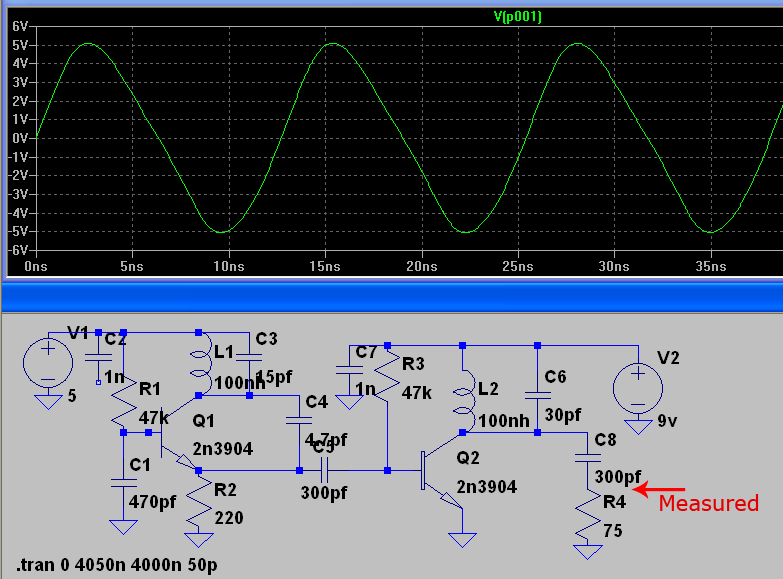

Woooo...............!!! I learnt simulation!!!!!!! I used to be failed while running the schematic, today I wrote your simulation command on simulation command box like this- ".trans 0 4050 4000 50p" Hahahahaha I got success! How easy it is, laughing at my sillyness :p
I changed the both coupling capacitor with 300pf and got higher output. There is 5.1V to -5.1V peak to peak voltage, wow! It shows the higher output of the transmitter, isn't it?

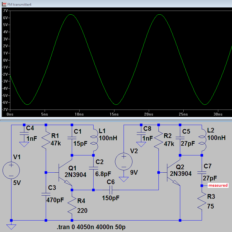

I am glad to see that you have LTspice IV working.
You can tweak capacitor values to get lower harmonics and a higher output like this:

I thought I did the best of 5.1V peak to peak, but amazing you got 6.5V peak wow!

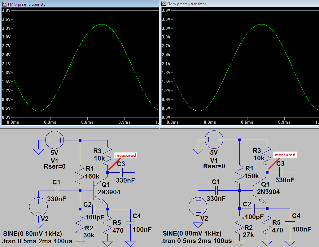

(And also- I placed 2n4401 and used 140K and 27K base bias resistor in pre-amp. Then I got 2.1V at its collector. Hope this biasing will work as a pre-amp without cut-off or saturation)

160k/30k is a ratio of 5.333 and 150k/27k is a ratio almost the same of 5.556.
Here is the comparison of the two which have very little difference:
if it is related to "Ratio" then I think I can use 16K and 3K :) . OK I will simulate! Thank you!
If you use 16k and 3k then the input impedance is so low that a HUGE input coupling capacitor is needed from the mic and the signal level from the mic will be attenuated.
It causes the transistor output to be clipped on the bottom because the divider current is much higher than the base current so the divider voltage is higher than if the resistors had higher values.

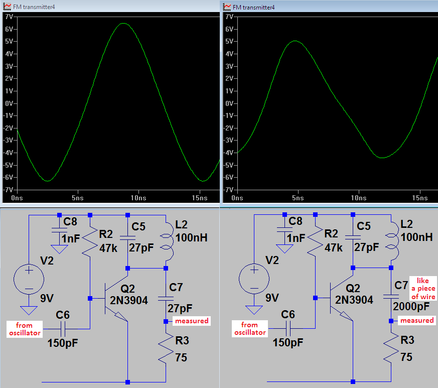

- Here on 2nd page I found a simple "Ferrite slug transformer" to match the impedance between Tx and Ant. May be it will work, won't it?
-Here on 3rd page he is saying about your transmitter. He is saying 'since it is buffer, output coupling 22pf is not needed, it reduces the transmission range'. Actually is it? I think 22pf separates LC with antenna and reduces overload (or external capacitance) to LC and keeps smooth gain. And also it matches impedance little (am I right?)
- Also he is saying "It consumes more than double current unnecessarily". What he is saying?

The high impedance collector of the RF transistor should have a pi filter (a C to ground, a series L and another C to ground) then connect the low impedance antenna.

On a simulation, the output level is reduced and the harmonics are increased when the output coupling capacitor value is increased so it is like a piece of wire:

In my simulation the oscillator stops when the 75 ohm antenna is coupled to the collector with a capacitor value greater than 6.8pf. The output is distorted (the bottom of the waveform is clipped).
When the 75 ohm antenna is capacitor coupled to the emitter then the waveform is extremely distorted with an amplitude of only 1.8V p-p.

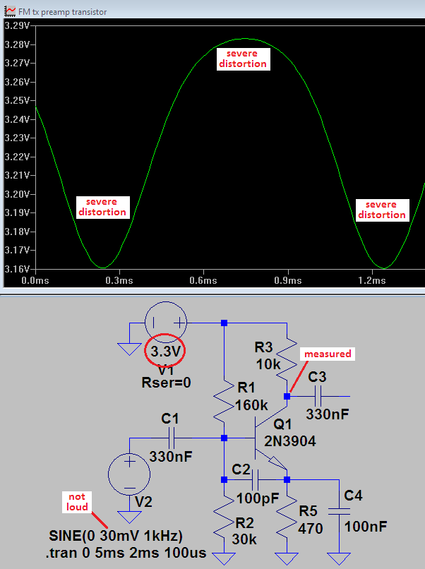

I found low drop-out regulator but is 3.3V only (78L33). If I used it instead of your regulator, are there any huge difference on operation or on output?
An L78L33 is not a low-dropout regulator. It is just an ordinary little 3.3V regulator. My FM transmitter uses a very common little 5V low-dropout regulator.

If you use the 3.3V regulator:
1) The preamp will not work properly unless its biasing is changed and its maximum output level might be too low.
2) The oscillator output will be low which will make the range not far.

At 5V, you wrote 80mV SINE but at 3.3V you wrote 30mV, how you calculated? Automatically via LTspice or manually?
80mV peak (not SINE) is a loud sound. Then the preamp with a 5V supply performs very well.
But with the 3.3V supply the output of the preamp is horribly distorted. So I reduced the input to only 30mV peak that is not loud then the output is better but is still distorted pretty bad.
