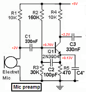

Few months ago you show me preamp stage bias with pre-emphasis of Mod 4 using BC547. I am searching this post but can't find the page, and thread! It is valuable for me because 2n3904 is not available from the market. First time i bought 3 piece but now can't. Can't I make whole Mod 4 using BC547 with same quality as 3904? Because I can find lots of 547!
A BC547B is almost the same as a 2N3904 except its pins are different.
A BC547 without a letter has a very wide range of hFE so some will be cutoff and others will be saturated.
EDIT: Added the schematic

You were posted a schematic of preamp using 547.

It was NOT designed properly. The designer tried it with only one transistor (it had low hFE) then maybe it worked. I simulated it with a "typical" transistor that has "typical" hFE and it distorts very badly because it is almost always saturated. If the hFE is even higher then it is worse.
I biased it correctly but it still distorts if the hFE is lower or higher than "typical". The pre-emphasis will work fine. I forgot to add the 100pf but it is needed in a radio transmitter.
I found this post by searching 1 hrs to see Preamp biasing on 547 by you But what happened to this website, attached image is unavailable!
I wanted to see same type peramp (with pre-emphasis) using 547 and 495 transistor with same quality as your :(
I used a 2N3904 because its DC current gain (hFE) is a narrow range from 100 to 300. A BC547 has a very wide range from 110 to 800 so many of them will be saturated in my circuit and will not work. A BC547A transistor has a range of current gain from 110 to 220 so it will work in my circuit.

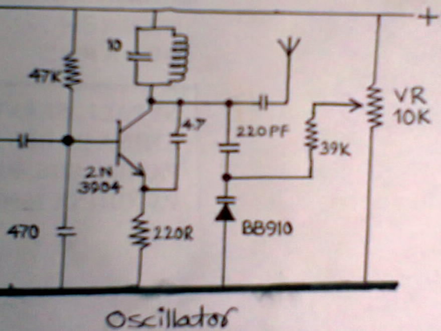

I did a silly modification on oscillator schematic of your. I modified for tunning using potentiometer instead of trimmer. Will it work? :)
Your circuit will work fine because the varactor diode is effectively parallel with the capacitor in the tuned LC circuit.
But the frequency will change as the battery voltage runs down.

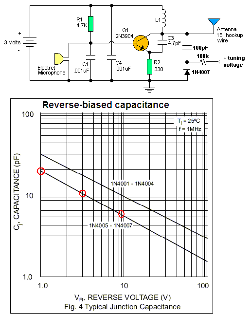

An ordinary silicon diode or rectifier or the collector-base diode of a transistor are also varactor diodes but with a small range of capacitance.
hahaha amazingly you find the shematic from where I had stolen the idea, the 2nd attachment :) . OK will try this.
What, any silicon diode like 1N4007 also have capacitance in reverse?? Will work instead of varactor but with small rang of capacitance?
And look at the 1st picture of oscillator, there is no capacitor parallel with inductor, is it complete?
The capacitance of the varactor diode is effectively parallel to the inductor.
Because C4 connects the positive supply to ground at radio frequencies.
