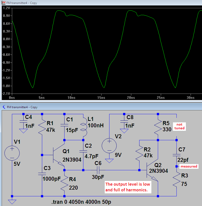

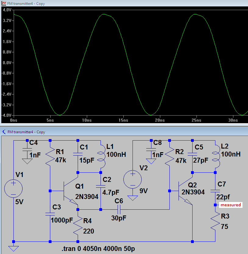

Once, you have said that- This kind of biasing is very bad way. Talking about last RF amplifier stage which has 330R at the collector. May be you also said- It will not amplify well (I think). OK, then I am thinking about to remove the 330R and add an inductor. Hope this modify is little better than resistor, isn't it?
With a tuned LC at the collector, the output level of the RF amplifier transistor is high and has few harmonics.
With just a resistor, the output level is low and is full of harmonics.
I didn't simulate it with only an inductor because stray capacitance in parallel might tune it to a harmonic.

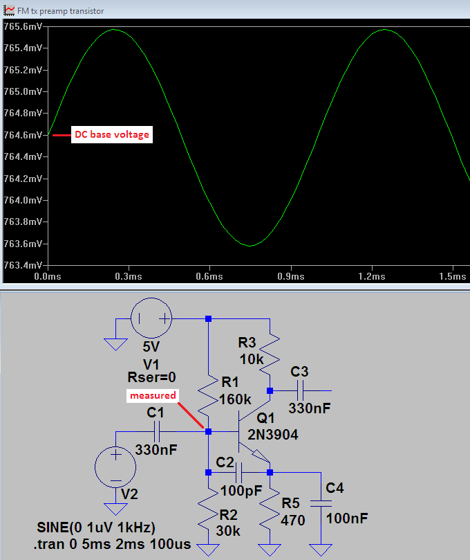

Can I calculate the Base voltage (voltage devider) of preamp of Mod 4 like this way?
Base current = 5V / (160K+30K)= 0.026mA
Then Base Voltage= (0.026mA x 160k)= 4.16 V
(any mistake?)
Then emitter voltage should be arround 3V i think, and it is possible from 470R. But getting confuse how to calculate the Emitter voltage (and collector voltage too)?
No.
THE DIVIDER's current is 26.32uA.
The SIM shows that the collector is at 2.0V so the collector current is (5V - 2V)/10k= 0.3mA.
The hFE of the 2N3904 at 0.3mA collector current is about 260 so its BASE CURRENT is 300uA/260=1.15uA.
Then the 160k resistor has a current of 26.32uA + 1.15uA= 27.47uA and the 30k resistor has a current of 26.32uA - 1.15uA= 25.17uA.
The base voltage IS NOT the voltage across the 160k resistor, it is the voltage across only the 30k resistor which is (25.17uA x 30k=) 0.755V.
My simulation shows a base voltage of 0.7646V which is within 1% of my calculated voltage.

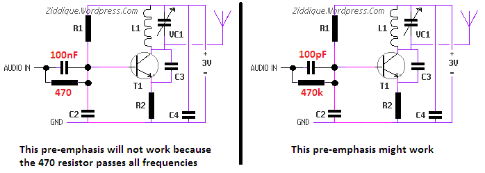

It doesn't have pre-emphasis so the de-emphasis in all FM radios will make it sound awful (no high audio frequencies), especially in North America.
Since FM broadcasting started first in North America we have more pre-emphasis and more de-emphasis than in the rest of the world.
Won't it work if I add 470R and 100nF as a Pre-emphasis in the place of 1st 330nF (Mic to base on MOD4)?
You have more pre-emphasis means you have less hiss noise (on basic circuit)?
I think you should build it first wii..it doesn't have pre emp but it sounds clear on a good radio..sounds better than an am radio..good luck wii
No it will not work.
When FM broadcasting began a long time ago the transmitters were not very powerful and the FM radios had poor sensitivity so there was a lot of hiss. The higher amount of pre and de-emphasis reduced the hiss. Now modern transmitters are very powerful and modern FM radios are very sensitive so less pre and de-emphasis works fine but it was not changed in North America.
