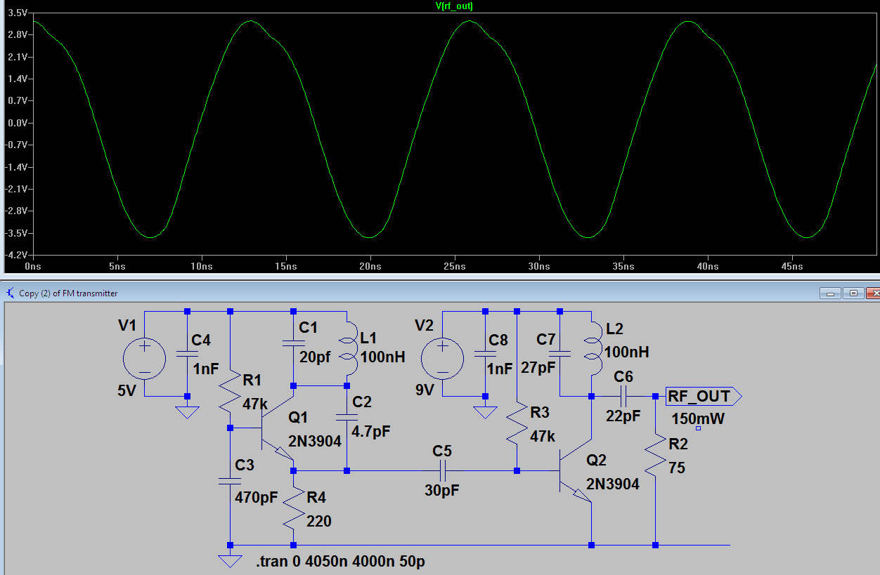

Again, here is my ASC file (for LTspiceIV)of the RF parts of my Mod4 FM and a photo of the resulting schematic and output waveform:

The new FM transmitter has problems:
1) R1 feeds noise on the 13.8V supply directly into the audio input. Also the value of R1 is too low.
2) The value of C2 is much too high so it cuts high audio frequencies.
3) There is no pre-emphasis so the de-emphasis of all FM radios will make the sound muffled like an AM radio.

Can I add 100nF capacitor parallel with 470R at the emitter of 1st transistor to get pre-emphasis like on Mod-4?
The first transistor in your post #365 is the RF oscillator. It oscillates because of positive feedback from its collector to its emitter by C4. If you add a capacitor parallel to its emitter resistor then it will not oscillate anymore.

I think that the negative feedback produced by the collector to base biasing will cancel most pre-emphasis if the 470 ohm emitter resistor is bypassed with a capacitor. Bias the first transistor with a normal voltage divider and the pre-emphasis will be the same as mine.
