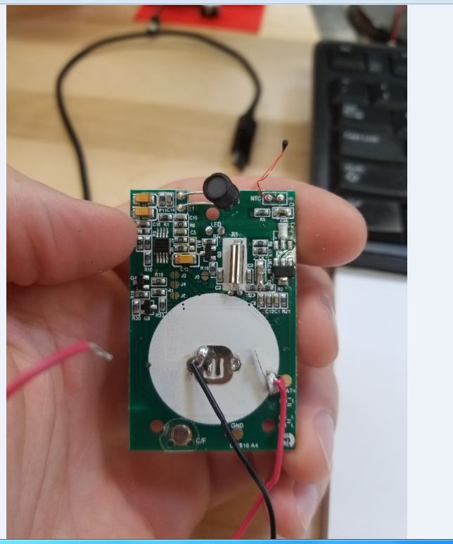

Can you post a picture of the inductor? My guess is that the inductor, if it really is one, is producing pulses, not a continuous change in inductance.
I bought mine for $12.00 For $12.00 you couldn't even make the fan.
The fan is magnetic. The magnet is in the hub. The magnetic flux is picked up by a Hall device.
Doesn't a magnet moving over a coil of wire make a generator? The output voltsge should be proportional to speed.
Yes. But the coil is an alternator and you pick up the pulses. Dealing with the output voltage is far too difficult.

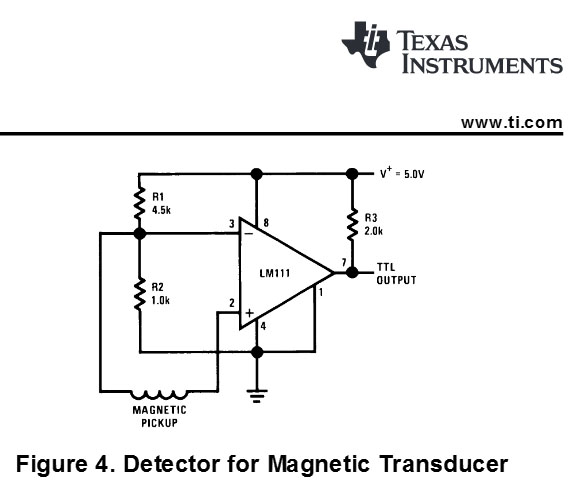

So I attached the circuit that the wind meter has and you can see the inductor on the top. I bought similar inductors from Amazon and when I measure the the ac voltage with a multi meter while blowing on a fan and having the inductor next to the fan the voltage is between 0-10mili volts. Can I convert this ac voltage to a digital pulse and read it with arduino?

Image from page 2 of the LM111/211/311 datasheet
Full datasheet can be found here: https://www.ti.com/lit/ds/symlink/lm311-n.pdf

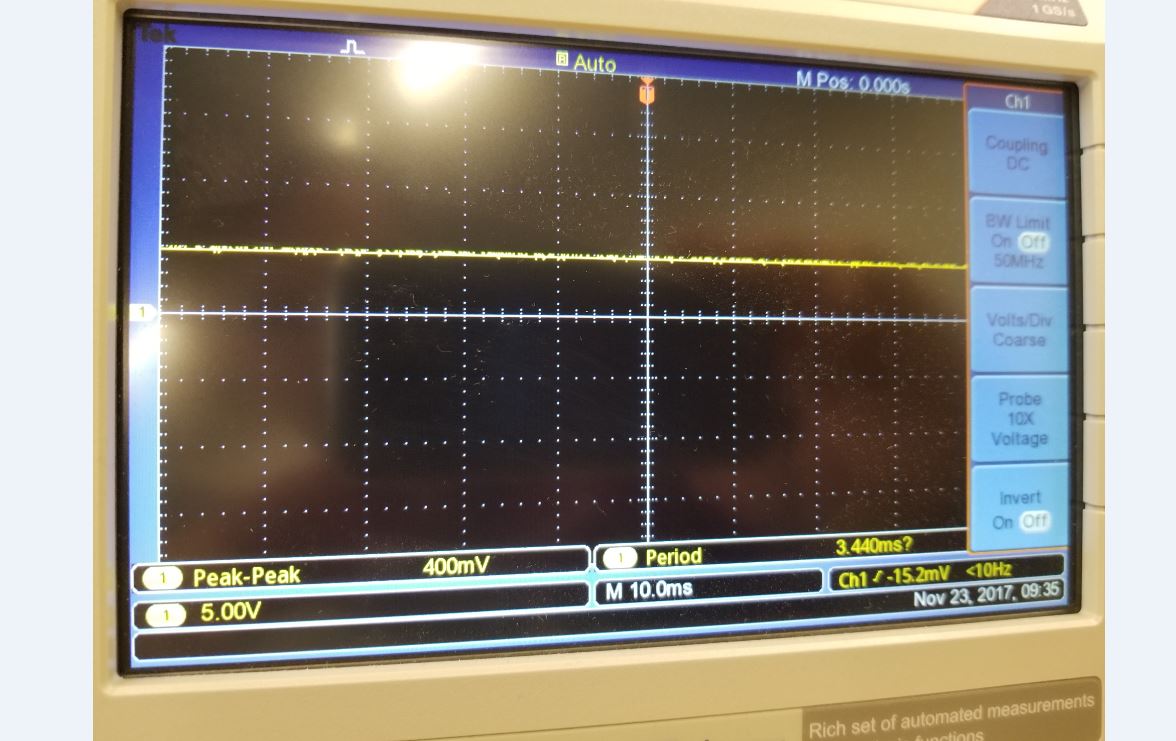

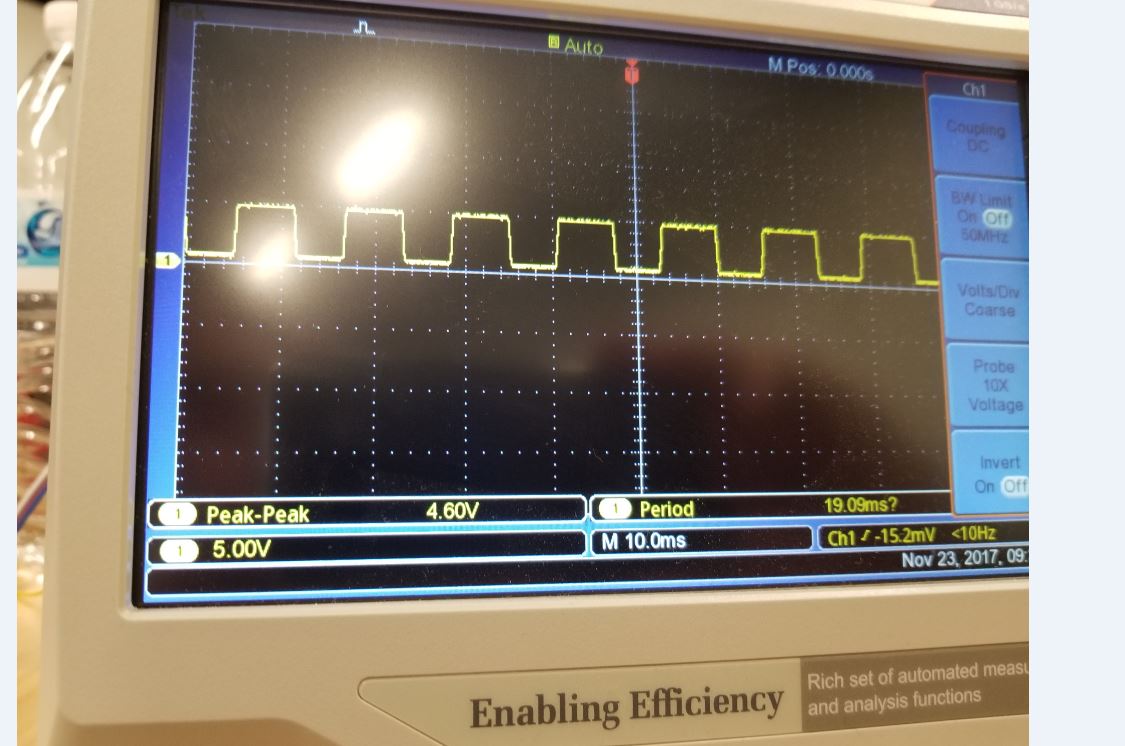

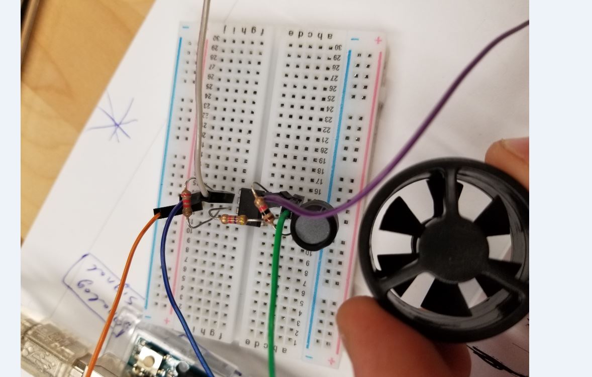

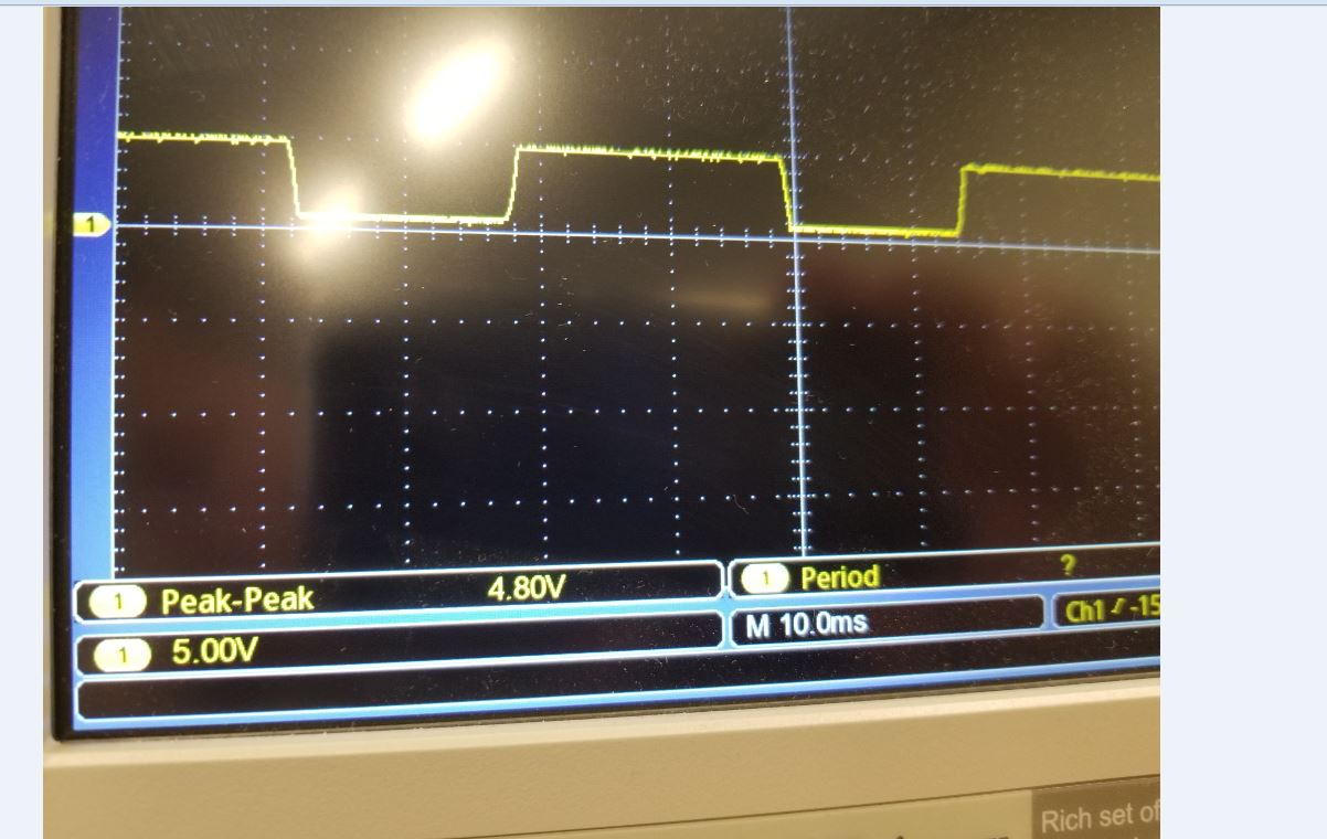

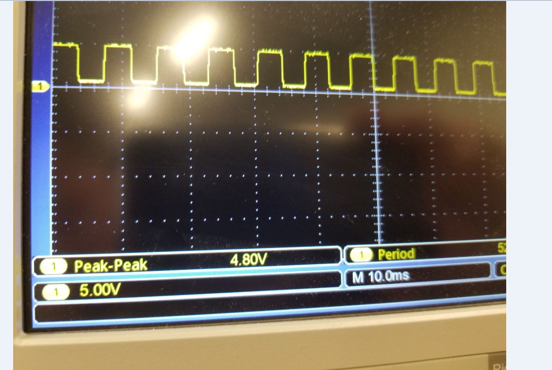

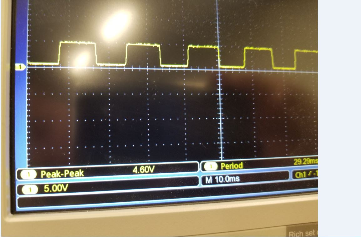

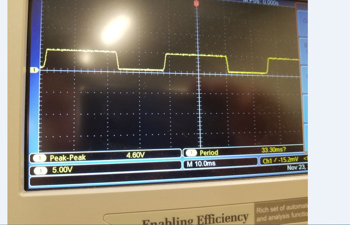

Hello Sir, I made this circuit and I have a small fan with a magnet and was blowing to the inductor and was getting pulses on the oscilloscope, faster blowing more pulses. Attached photos. To count it with the arduino and translate it to a wind meter how do I do it? I mean I'm counting the pulses with pulseIn() but how do I translate it fast slow?
It depends on how many pulses you need to detect in say 20mS.
You "open the gate" and count in the background 20mA. Store the number of pulses detected.
Hold the fan outside the window of the car. Drive at 49km/hr.
Use this as a reference.
It's so easy.
Rather than count the number of pulses in a set period, I suggest timing single pulses. You can set an interrupt or flag for an edge (rising or falling) and capture the time between those events. At least that is how I would do it with a PIC and presumably arduino has the same capabilities.
Hmm I like this ideq, I know how to measure the pulses in a period of time but how do I do what you suggested? I understood to put a flag when the rising pulse occurs let's say 1 but how do I know when it's falling and becomes zero?
The difference between the methods is the responsiveness. Take your slow frequency which had a period of about 40 ms. If you counted ten cycles, it would take 400 ms and the counting error would be approximately +/- 10%. If you timed a single cycle ( or several cycles), your response time would be cut considerably and the MCU timer would easily give 1 part in 1000 (2^10) precision.

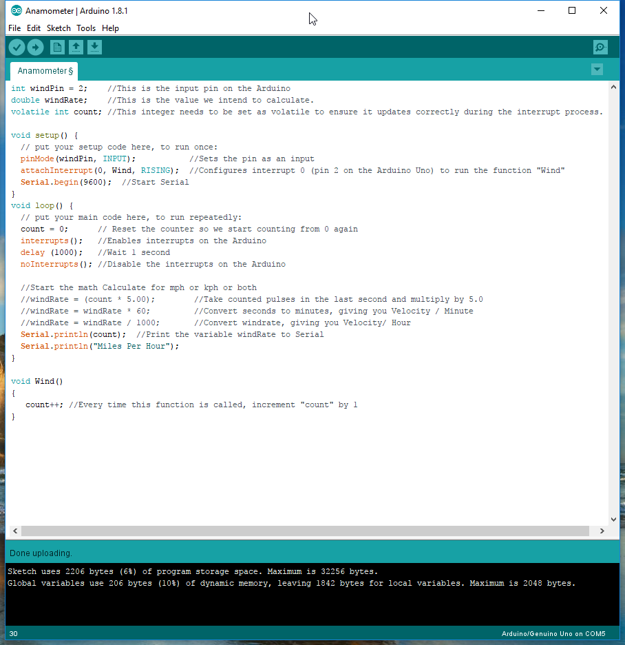

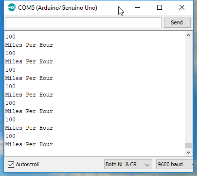

If you wish to use an Arduino you can try the following code sample. You can modify the code to fit your needs. As can be seen the code displays wind velocity expressed in MPH (Miles Per Hour) which can easily be converted to kph or if you like add a line or two of code and display both.
Here is what it looks like in Arduino:

The actual code sample:
int windPin = 2;    //This is the input pin on the Arduino
double windRate;    //This is the value we intend to calculate.
volatile int count; //This integer needs to be set as volatile to ensure it updates correctly during the interrupt process.
void setup() {
  // put your setup code here, to run once:
  pinMode(windPin, INPUT);           //Sets the pin as an input
  attachInterrupt(0, Wind, RISING);  //Configures interrupt 0 (pin 2 on the Arduino Uno) to run the function "Wind"
  Serial.begin(9600);  //Start Serial
void loop() {
  // put your main code here, to run repeatedly:
  count = 0;      // Reset the counter so we start counting from 0 again
  interrupts();   //Enables interrupts on the Arduino
  delay (1000);   //Wait 1 second
  noInterrupts(); //Disable the interrupts on the Arduino
  //Start the math Calculate for mph or kph or both
  //windRate = (count * 5.00);        //Take counted pulses in the last second and multiply by 5.0
  //windRate = windRate * 60;         //Convert seconds to minutes, giving you Velocity / Minute
  //windRate = windRate / 1000;       //Convert windrate, giving you Velocity/ Hour
  Serial.println(count);  //Print the variable windRate to Serial
  Serial.println("Miles Per Hour");
void Wind()
   count++; //Every time this function is called, increment "count" by 1

You need a pulse count so I suggest Colin's method. Place the sensor on a vehicle on a calm wind day and get pulse counts for assorted speeds.

Hi there, thank you very much! The program works perfect for what I need. I now just doing a calibration with a good anemometer I have.
Once you know the variables of what you have, as in how many pulses per unit and if the pulses are linear then you just remove the // from the lower lines and fill in the math functions. If you want to get fancy have the output display things like wind velocity in kilometers per hour as well as miles per hour. Heck, using an Arduino you can also toss in ambient temperature. :) Good luck with it. Just remember the final lines need to be setup.
