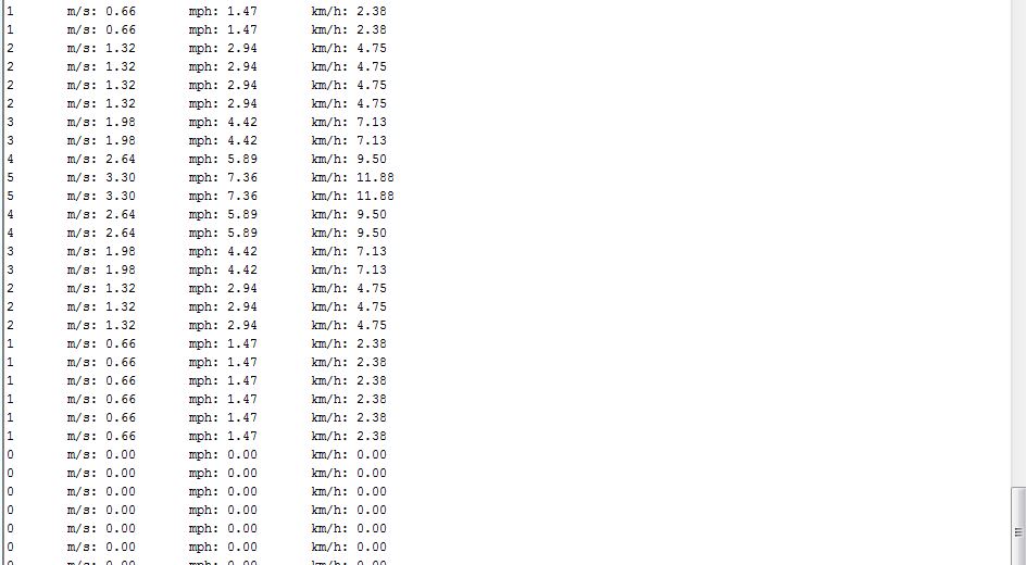

Hi again, I was doing some measurments and noticed a problem, on the attached photo is the output from the arduino, I have a big fan and was counting a good wind meter I have and according to that I was calibrating mine, but as you can see at the photo the 4.42 mph is the correct measurment but without moving it ( I have it steady and same distance, not moving it) every some time it goes to 2.94 mph. Attached the code as well. Do you know why?

Hi, something else as well, I blow on the fan and I have the measurements attached. So, when I blow on the fan I count the rising so the count is 1-2-3-4-5-6 etc. How can I make it measure more accurate on mph because the output I take for 1 pulse is 1.47 for 2 is 2.94 etc, how can I make it more precise ramp?
